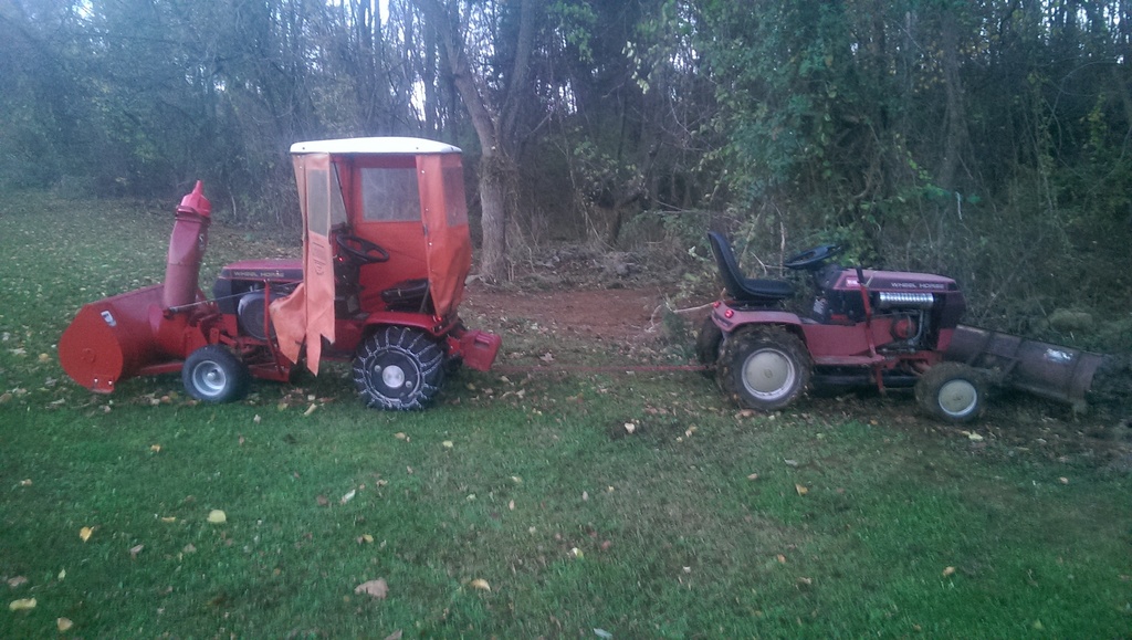

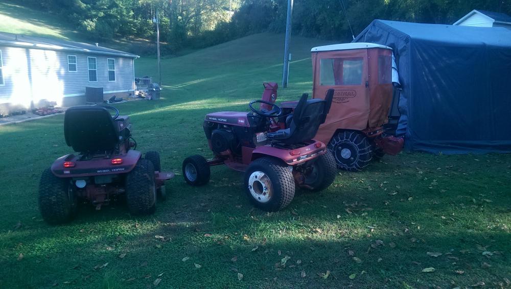

WVHillbilly520H 10,379 #3 Posted March 16, 2017 The standard cab fits the/my 520H just fine the front axle design does not make any difference, the bigger seat was the only minor issue but unless your over 6' tall that's not an issue either, last picture is the 520H cab with extension for the seat vs the standard on my 520H, so that means B,C,3,4,&500 series should all take the same basic standard cab style, Jeff. 5 Share this post Link to post Share on other sites

cleat 9,230 #5 Posted March 17, 2017 Looks like the last one has a real windshield as well. Nice. Cleat Share this post Link to post Share on other sites
