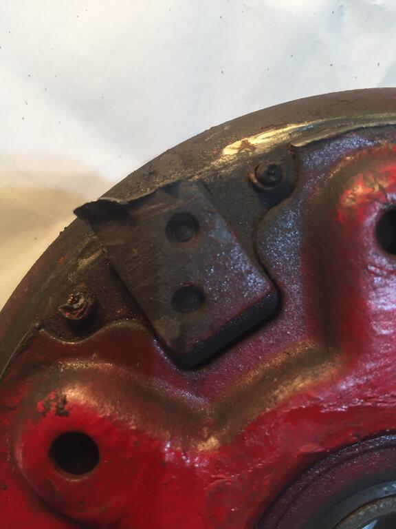

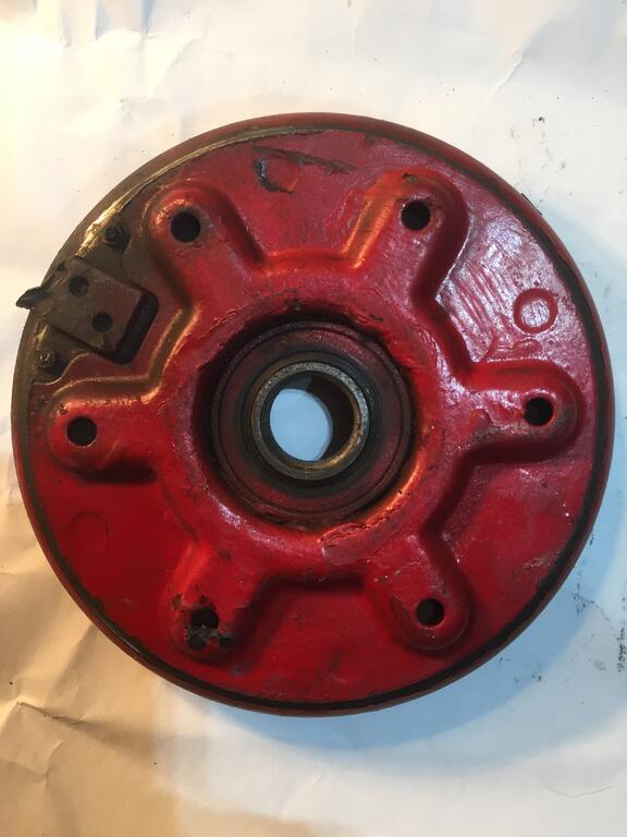

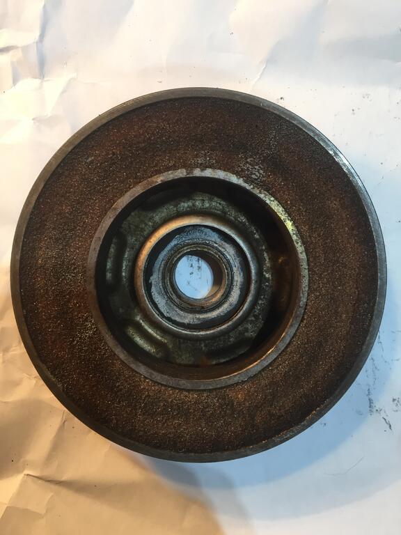

AndyZ 5 #30 Posted May 8, 2020 Bumping into this thread because it looks similar to my problem. Hope that's OK, I try not to start new threads if existing ones are appropriate. The PO of my '71 Raider 10 told me the PTO bracket broke at some point and she just snipped the wires and let it pinwheel - see the photos for the sad story. The wires are snipped right at the surface of the coil housing, and the bracket is, well... broken. The good news is after I removed the retaining bolt, the PTO slid right off, no forceful extraction required. It looks like someone had it off and reassembled it with anti-seize. The key and keyway looks good. I was hoping there was a way to get to the coil wiring from the inside to renew the wires, but it looks solidly potted. Do you know of any way to fix those wires? Or is the only way to keep it as an electric PTO to find another coil assembly somewhere? There was just one that sold on eBay this week but it was up and sold for a spendy $150. I'm not adverse to converting to a manual PTO. I've read most of the PTO threads here and am in agreement that a manual PTO can be engaged more smoothly than an electric. As well I don't have a mowing deck or any accessories requiring a PTO just yet, so I would rather not go a spendy route. The PO gave me a snowblower attachment but I already have a '65 Ariens Sno-Thro that I love. It looks like a manual conversion could be cheaper than sourcing a electric coil assembly. What would you do? Thanks! - Andy Share this post Link to post Share on other sites
daveoman1966 3,880 #31 Posted May 8, 2020 As my buddy Carl from 'Slingblade" would say./... "I'm studyin' on it...." 1 Share this post Link to post Share on other sites
daveoman1966 3,880 #32 Posted May 8, 2020 Check the FIELD for continuity. If that test fails, the field is grounded and MAY be beyond repair. If the FIELD has continuity, I'll suggest MAYBE a way to repair the cut-off bracket...MAYBE.. You can contact me via direct email to: daveoman@windstream.net EPTO FIX.docx Share this post Link to post Share on other sites
AndyZ 5 #33 Posted May 9, 2020 Thank you for a clear troubleshooting doc, Dave. I have 3.1 ohms wire-to-wire and open circuit from either wire to base. So I think the coil is good. If only the PO had left some wire hanging out to work with. She had installed some kind of funky metal plate over the PTO assembly and I think that was pinwheeling independently and cut/ground the surface around the plate and the wire ends. I'll send you a message off-line to see if you have suggestions. Thanks again to you and to the Red Square community for such a friendly and information-rich site! Andy Share this post Link to post Share on other sites
