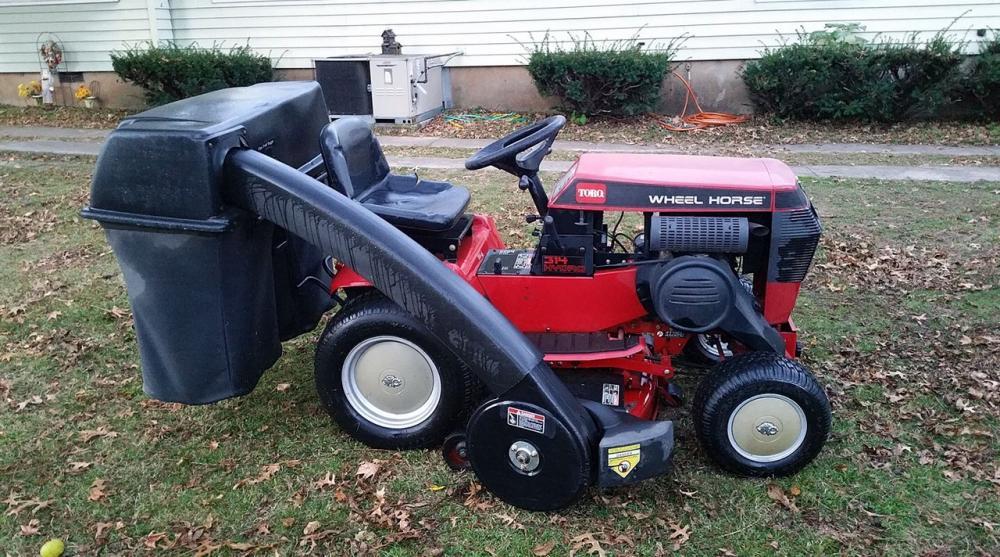

murr 0 #37 Posted April 14, 2020 On 3/13/2017 at 9:38 AM, George Washington said: I'm going to look at this beauty tonight. Its a 314-H with a 42 or 48 inch deck (not sure yet), canopy (not shown), and 480 hours on the meter. He is the 2nd owner and says its always been garaged. He says he would like to get $600 so I'm almost certain im bringing it home tonight to replace a junky craftsman but I'm curious on the total value of the tractor as a package deal as well as the individual pieces) and also just what everyone's opinion is of the 314H in general - Ill be using it just for mowing and light yard duty (I have a C-160 for heavy work). I know this is a great deal but I would just like to get as much info from others who are more experienced. I always feel better when I'm encouraged by others. This will be my 2nd wheel horse and my wife's first so I want to make sure she loves it as much as I do Share this post Link to post Share on other sites
murr 0 #38 Posted April 14, 2020 i have the same model and bagger. looking for manual for the bagger. specifically, how the belts can be reattached. any help would be great Share this post Link to post Share on other sites
WHX?? 57,087 #39 Posted April 14, 2020 (edited) Try searching in the file/manuals section your model number might help. Maybe the files Mod @gwest_ca can help you out too. Edited April 14, 2020 by WHX24 Manners Share this post Link to post Share on other sites
WVHillbilly520H 10,378 #40 Posted April 14, 2020 12 minutes ago, murr said: i have the same model and bagger. looking for manual for the bagger. specifically, how the belts can be reattached. any help would be great This should do it... Share this post Link to post Share on other sites
