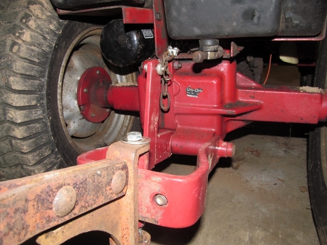

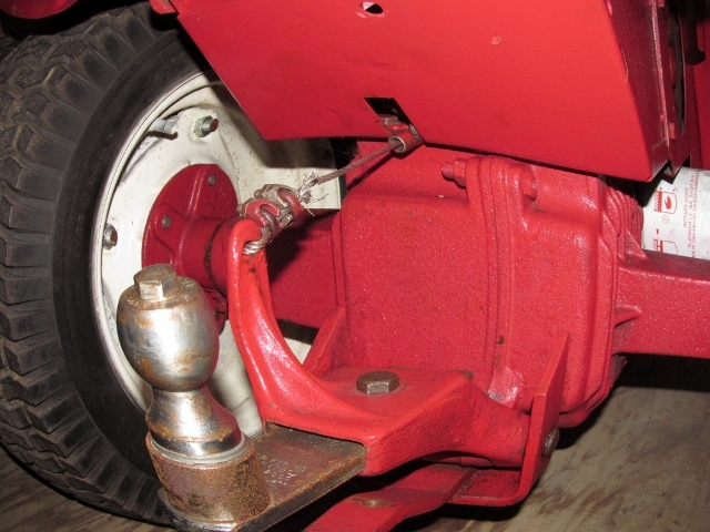

Ed Kennell 36,097 #15 Posted March 15, 2017 (edited) You need the clevis hitch ....I just sold my last one. I do have a sleeve hitch. Put an ad in our wanted section. This is the sleeve hitch. For both of these hitches to operate properly, you also need the rock shaft, bushings, and cable and sheath. Edited March 15, 2017 by Ed Kennell 3 Share this post Link to post Share on other sites

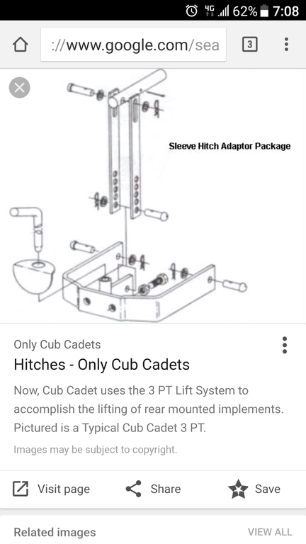

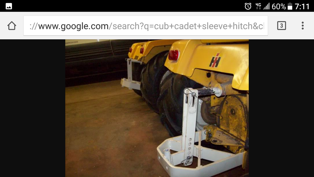

slim67 2,734 #16 Posted March 15, 2017 11 minutes ago, Ed Kennell said: You need the clevis hitch ....I just sold my last one. I do have a sleeve hitch. Put an ad in our wanted section. This is the sleeve hitch. For both of these hitches to operate properly, you also need the rock shaft, bushings, and cable and sheath. Is the slot also called a sleeve Ed? I thought the Brinly was called a sleeve aside from being called clevis. Thanks for clearing that up. 50 minutes ago, jellyghost said: I don't have a sleeve hitch. Does somebody make them new? What is the best way to get one. wheelhorseman1000 is a good start unless you find a used one like Ed suggested. Ill be needing one myself soon. 1 Share this post Link to post Share on other sites
Ed Kennell 36,097 #17 Posted March 15, 2017 (edited) I always referred to the Brinley type as a clevis hitch because the implement half is C shaped like a clevis and attaches with a pin like a clevis. I have seen the other one called both a slot and a sleeve hitch. I think both names fit that design. That's why I like pictures Slim. Edited March 15, 2017 by Ed Kennell 1 Share this post Link to post Share on other sites
WVHillbilly520H 10,369 #18 Posted March 15, 2017 As the way I was brought up in the garden tractor world the clevis hitch is the sleeve hitch as Cub Cadet referred it as sleeve hitches in their literature (and some refer to this as a 3 point style hitch and IMHO a little better set up being ALL mechanical linkage than WH with the cable and chain but I digress), but as Ed has said the implement attachment has a "C" to couple over the tractors' receiving hitch , and the older WH was a "slot" where attachments were pinned by/through thick flat bar, Jeff. 1 Share this post Link to post Share on other sites
Ed Kennell 36,097 #19 Posted March 15, 2017 There ya go Slim. You can call them sleeve, you can call them slots, or you can call them clevis. Just don't call them RayJay. 2 Share this post Link to post Share on other sites
slim67 2,734 #20 Posted March 16, 2017 1 hour ago, Ed Kennell said: There ya go Slim. You can call them sleeve, you can call them slots, or you can call them clevis. Just don't call them RayJay. I remember when my parents bought a brand new tiller for their sears, you had to buy the 3 pt adapter in order to use the new tiller. I thought I remember my Dad saying sleeve hitch and it stuck with me. I think I will just say Brinly since we all know what that is. Share this post Link to post Share on other sites
T-Mo-(Moderator) 4,365 #21 Posted March 16, 2017 Sleeve hitch is not a slot hitch. Sleeve hitch is a generic term and it's design is covered by an ISO (International Standard). It's a standard design used by all lawn and garden tractor manufacturers, as well as allied attachment manufacturers, i.e. Brinly, Agri-Fab, Ohio Steel, etc. The different tractor manufacturers may have their own term for a sleeve hitch, but they're all sleeve hitches per the ISO standard (ISO 9192) which has the term "Sleeve Hitch" in it's title. Cub cadet calls it a sleeve hitch, as well as Sears, MTD and others. Wheel Horse calls it a clevis hitch, while John Deere calls it Integral Hitch. But, they're all sleeve hitches designed to meet the ISO standard. A slot hitch, uses a slot in the hitch to engage an attachment, and was limited to just a few manufacturers, mostly Wheel Horse and a few others. I haven't seen the design used all cross all manufacturers like the sleeve hitch design, and I don't know if there is an ISO standard to it's design requirements. I hope this clears up the differences in those type hitches. We won't discuss the category 0 3 point hitches because that is an option that isn't readily available on most Wheel Horses and the attachments are very expensive and most aren't in production anymore since manufacturers have now gone to a limited category 1 3 point hitch design. For a new clevis hitch kit, go here: http://www.wheelhorseman1000.com/ Lowell is a vendor here at RS, you can see his vendor page here: http://www.wheelhorseforum.com/forum/141-wheelhorseman1000s-hitches-brackets-parts-and-more/ 5 Share this post Link to post Share on other sites
