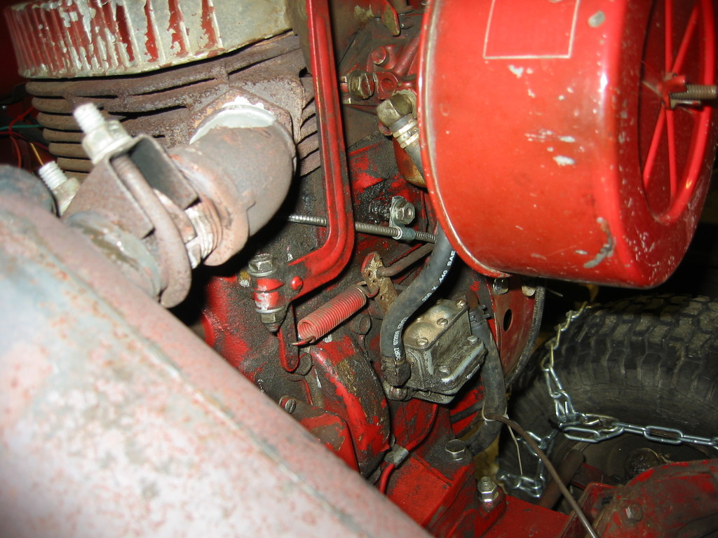

USHorse 41 #6 Posted April 1, 2017 Back again..now have time to tinker. Question regarding throttle cable and hook up. Something must be missing from this setup. Throttle cable directly connects to speed contol arm and one clamp fastens it to shroud. Should there be more hardware? PO has cobbled this tractor so up here and there so not sure what is right. Engine is k341 spec 71371 serial 14199379. Anyone have picture of proper set up? Sorry for no picture, problem loading. Share this post Link to post Share on other sites
stevasaurus 23,662 #7 Posted April 1, 2017 This is for an 8hp K181, but it should be about the same. Share this post Link to post Share on other sites

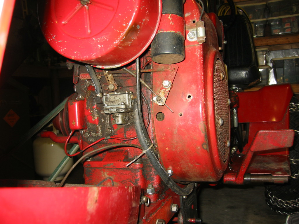

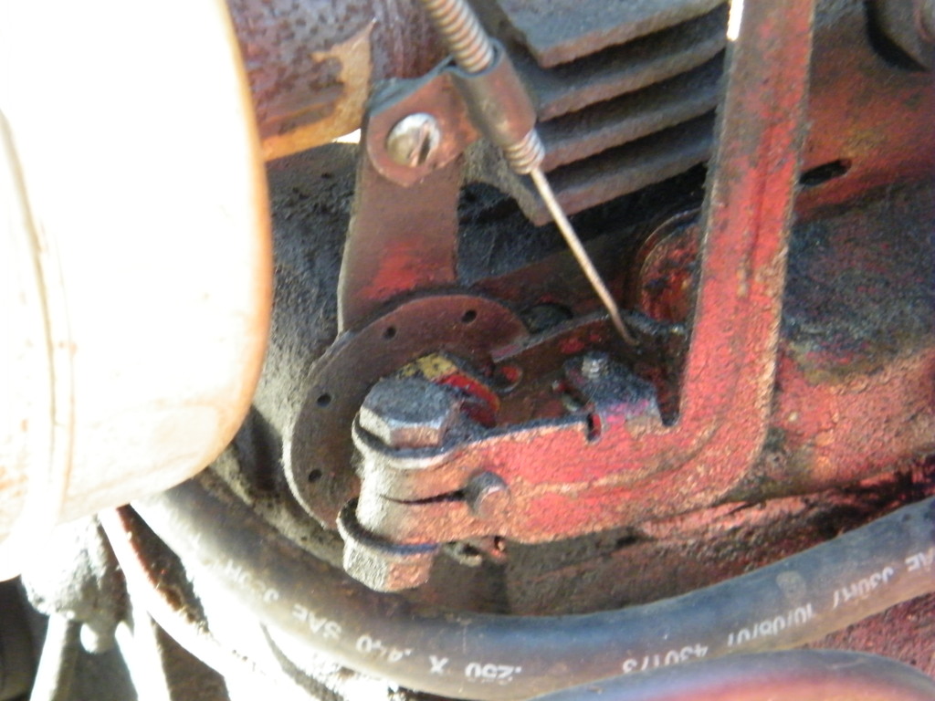

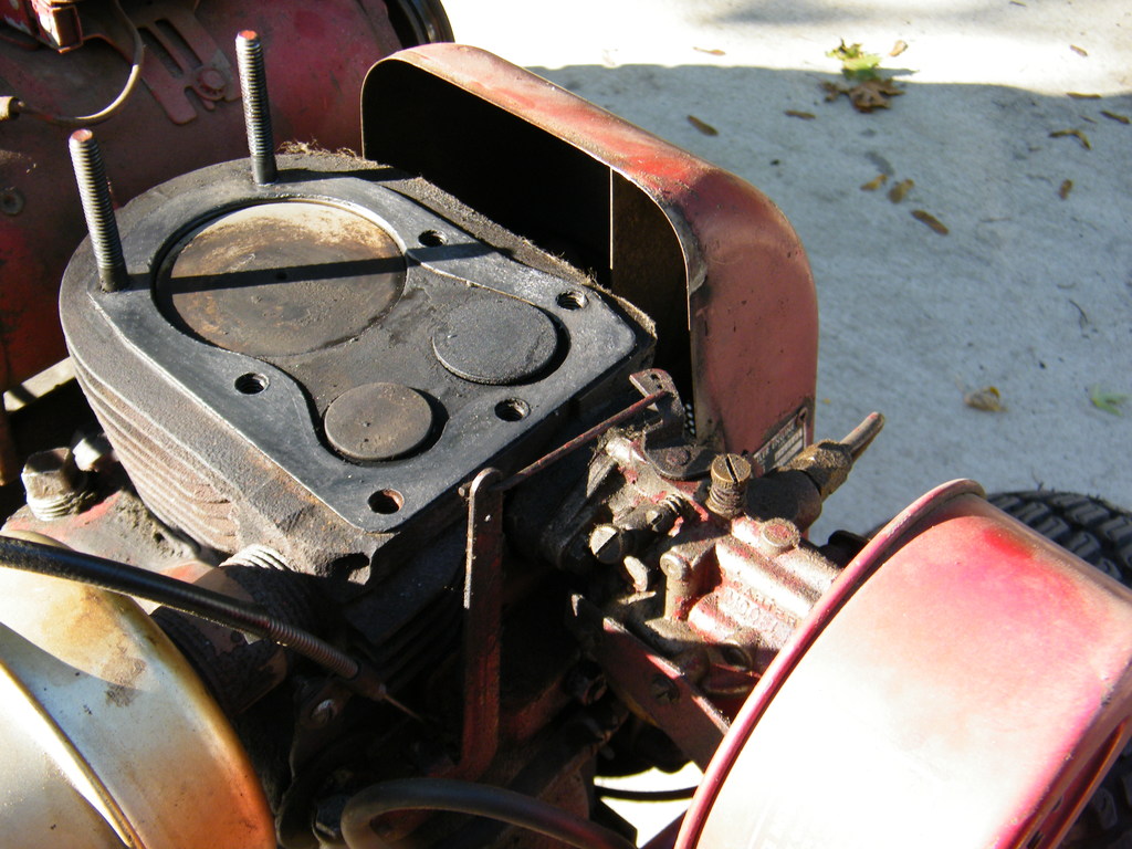

pfrederi 20,249 #8 Posted April 1, 2017 (edited) The big blocks used a different linkage than the 8hp There is a rock shaft on the air shroud, throttle cable goes on the bottom. Fixed link on the top goes to an arm mounted on the front of the block. There is a stop that limits the arms travel (high speed limit). The arm is connected to the governor arm by a spring then the governor arm to the carb by a fixed link Edited April 1, 2017 by pfrederi 2 Share this post Link to post Share on other sites

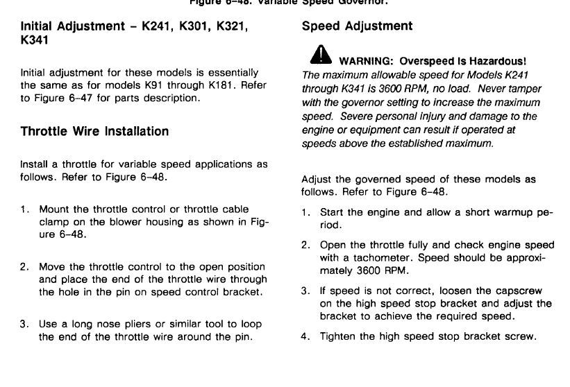

Sarge 3,470 #9 Posted April 2, 2017 Exactly a good reason to own the Kohler single cylinder engine manual - there is a digital copy in the manuals section on this forum . The high speed limit tab is to the right of the bolt on the center arm in the picture that has the governor spring on one side and the solid link to the throttle wire arm on the other side - just above the fuel pump . On a 341 or any big block , setting that high rpm limit is very important unless you like seeing cast iron exploding , lol . Manual can be downloaded here - Sarge Share this post Link to post Share on other sites
