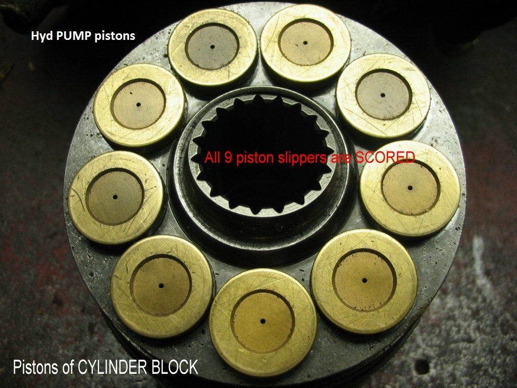

Aldon 4,832 #3 Posted March 11, 2017 You were given some specific info on one of the other threads. Perhaps your planning on it already but it is likely that your Hydro needs more work than gaskets. The brass slippers are very likely in need of attention or the unit may need replaced altogether. 1 Share this post Link to post Share on other sites

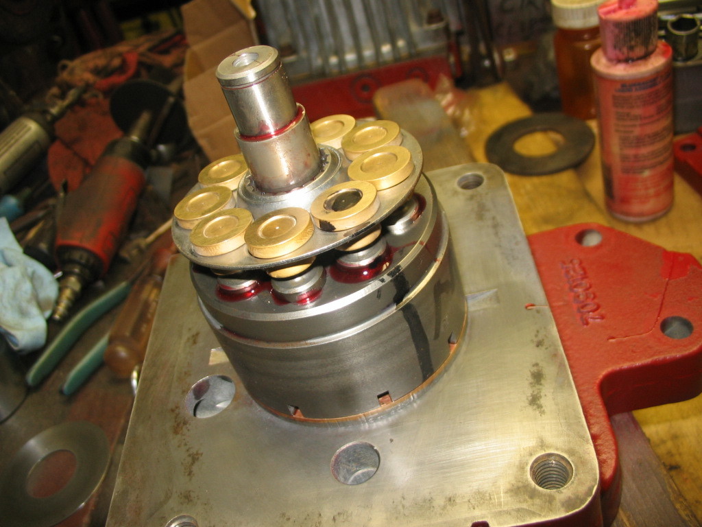

daveoman1966 3,884 #4 Posted March 11, 2017 The symptoms you dkescribe....ok cold, but power loss when warm... is positive sign that the internal brass piston slipper surfaces are worn and scratched, causing loss of pressure, leading to power loss. There are other internals that are similarly worn and need resurfaced. Follow the sundstrand manual to make the repairs. On reassembly, be certain to keep all parts white-towel clean with a thin coat of lube on the mating parts...I use the red engine assembly oil. 3 Share this post Link to post Share on other sites
