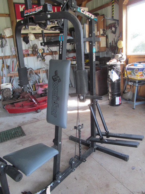

Ed Kennell 47,754 #6 Posted March 10, 2017 (edited) https://www.mcmaster.com/#3310t65/=16p2r2j Mc Master Carr unistrut channel. I have made a lot of U channel and angle iron pieces from square tubing I scavenge from old unwanted weight machines. The owners practically pay you to haul them away. The weights also come in handy . I like the second positive seat lock idea...very important safety item. Edited March 10, 2017 by Ed Kennell 6 Share this post Link to post Share on other sites

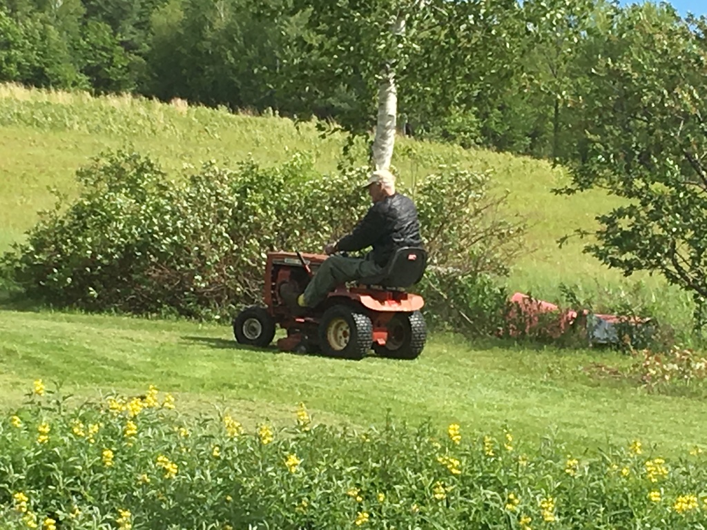

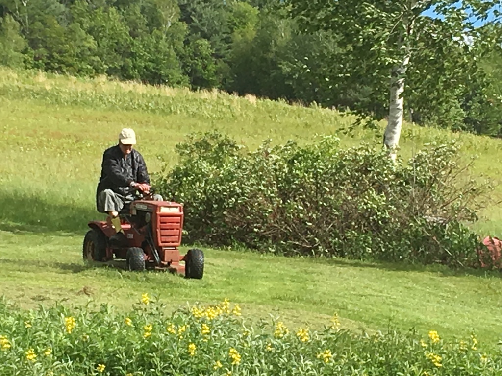

JimmyJam 542 #14 Posted June 5, 2017 Update: Delivered Uncle Slim's Commando 800 to his farm in Maine for first grass cut. Unistrut seat extensions & seat springs worked awesome for a 7 foot, 2" guy! 3 Share this post Link to post Share on other sites
slim67 2,825 #15 Posted June 5, 2017 1 hour ago, JimmyJam said: Update: Delivered Uncle Slim's Commando 800 to his farm in Maine for first grass cut. Unistrut seat extensions & seat springs worked awesome for a 7 foot, 2" guy! There's a tractor under that guy? For your sake I hope he's happy. 1 Share this post Link to post Share on other sites
JimmyJam 542 #16 Posted June 5, 2017 He loves it! Throwback. He remembers many a WH back in the day. Share this post Link to post Share on other sites
JimmyJam 542 #17 Posted June 5, 2017 On 3/10/2017 at 0:54 PM, Tankman said: What basketball team did your uncle play for? Celtics? When the seat is back far enough, think front weights. Uncle's nickname is "Slim" hence he weights about 135#. He was the State Deputy Forester District Mgr for the State of Massachusetts for many years after being a Korean War Veteran. An awesome guy! Love him dearly! No weights needed! Share this post Link to post Share on other sites
