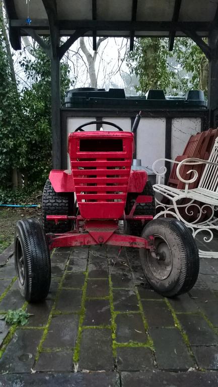

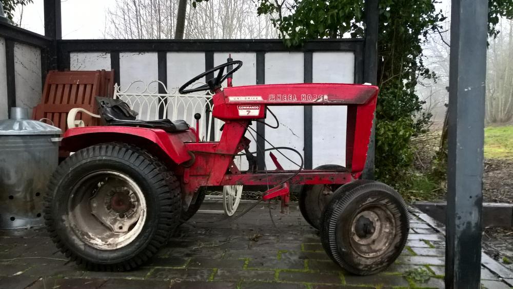

Redmarl 6 #1 Posted March 9, 2017 Hi, I was driving past a local junk shop last week and spotted a really cute little red tractor, I fell in love with it immediately. It will need some work but that's why I bought it, a nice project for my young aspiring engineer son and me. Turns out it is a Wheelhorse Commando 7 and this is all new to me, so can I pose a couple of questions? It bears the serial numbers 1145 and 404504 model number 1.3731 what year was it made? It has come with a loosely fitted 5hp Briggs & Stratton unit which I guess is not original, so what was? Any info would be gratefully received. Best regards to all. Mark Reynolds, engineer and his young apprentice Ashley. 6 Share this post Link to post Share on other sites

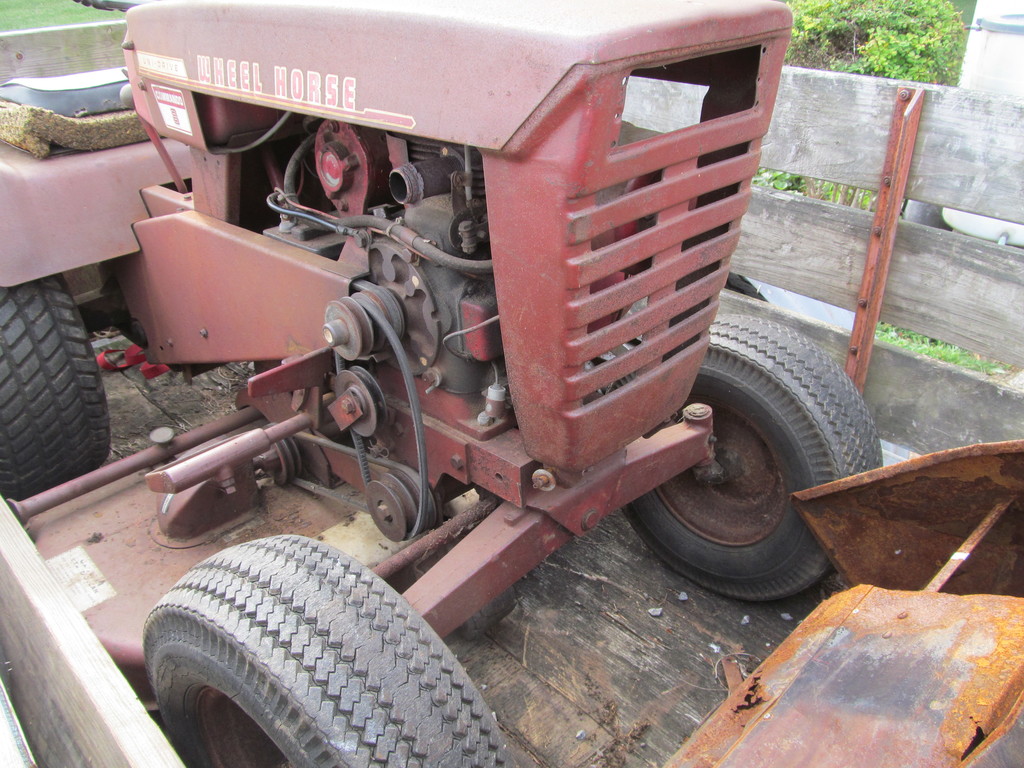

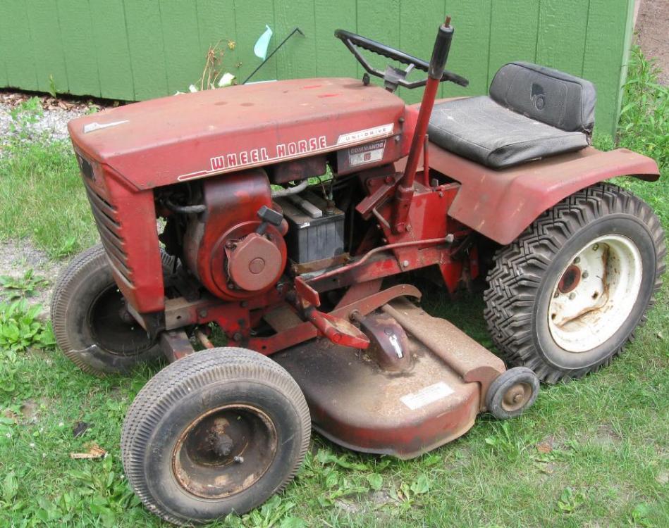

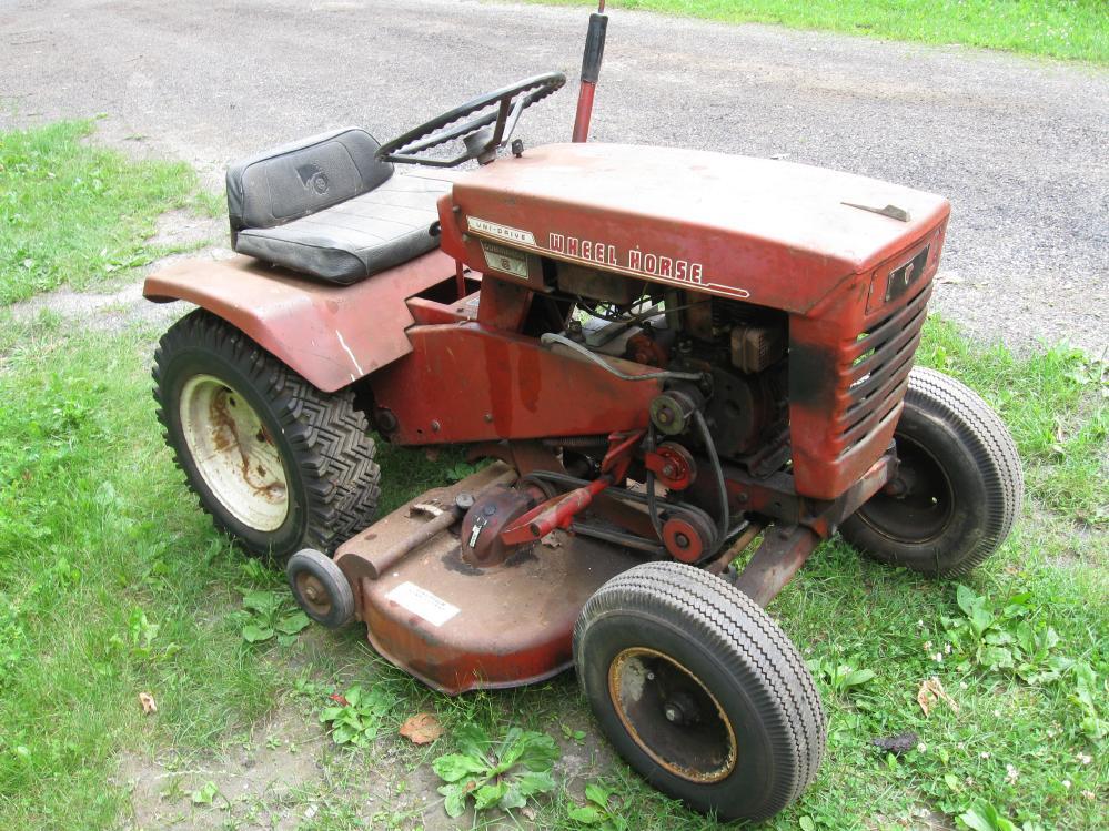

Ed Kennell 47,729 #4 Posted March 9, 2017 @Redmarl . I couldn't find any info on your tractor using those numbers. It does look similar to my 1968 Commando 8. M/N 1-4831 that has a 8HP K181S Kohler engine. Share this post Link to post Share on other sites

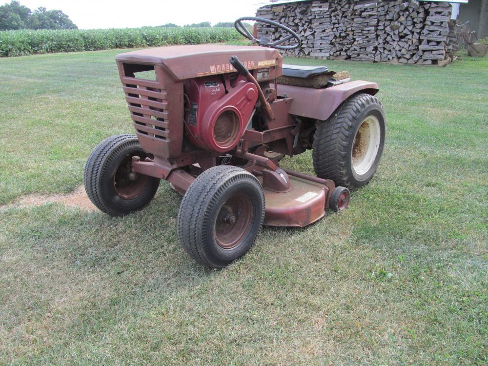

N3PUY 1,031 #5 Posted March 9, 2017 Mine has a 6HP Tecumseh Share this post Link to post Share on other sites

Anglo Traction 761 #13 Posted March 10, 2017 Welcome to RS Mark & Son Ltd ! . Good to see you've rescued one that initially looks a pretty reasonable condition generally for a short frame. Yes, a bit of a dilemma with the I.D of that model. They (U.S) exported WHs in greater numbers in the late 60s and before the Belgium Assembly Plant opened in March 69. Does your Tractor Model/Serial plate show as South Bend Indiana, or is it a Belgium Plate?. Your Number 1-3731 I suspect is a derivative from 1-3631 which was a 500 Special Model that had a Tecumseh H60 engine (if a 1968 machine). So they probably altered the Model Number to reflect the Hp rating of the engine that was fitted to yours which was probably a Techy H70 (7hp) and labelled it as a Commando 7. The Commandos 6 & 8 of 1968, I believe had 7inch wide rear wheels and the '68' 500 Special and the '69' Workhorse 700s had 6inch wide. You seem to have 6" wides on yours. Unlikely to find an Alloy H70 Techy in UK to get it back to original, so best look for a Cast Iron Kohler k181 for it, if you wish to get back to nearly what it should be like. Have a look through the Gallery section on here for the different models mentioned to look for similarities. Look forward to seeing your progress. Best place to come for any further help, so just ask. 1 Share this post Link to post Share on other sites
