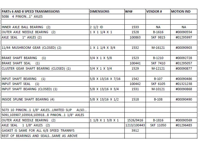

AR11 12 #1 Posted March 9, 2017 I have a 1980 1100 special with the 8speed transmission and the axle seals are leaking really bad, does anyone know the part number or suggest anything I could use to stop the leak Share this post Link to post Share on other sites
pfrederi 21,095 #2 Posted March 9, 2017 Welcome. Most likely you will have to replace the axle seals. It is not a hard job. There is a pinned topic at the top of this page that has the part numbers for transmissions. I copied the part applicable to you . You have a 5086 tranny with 1" axles.. There are lots of thread here about replacing axle seals. Hardest part is getting the hubs off. 1 Share this post Link to post Share on other sites
WHX?? 57,901 #3 Posted March 9, 2017 Check the side to side play on the axles once you have it on jack stands. If there is any movement. You may have to or should replace the 1528 outer bearings if there is. . Would have to split the cases to do that. Share this post Link to post Share on other sites
