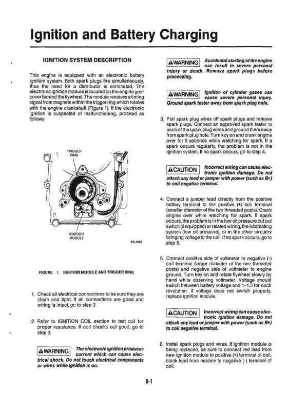

onanparts.com 185 #7 Posted March 7, 2017 16 minutes ago, Busted knuckles said: Wow thats alot from toro i found a onan parts website and it lists that toro number as cross reference and its 99 plus shipping. Im starting to beat the internet and find what im looking for. Thanks for that number glad to be here hope i can keep my old steel running for years to come. Unlikely Onan will run out of the modules anytime soon. Can't say for sure but the ebay ones for around $75.00 are imported from what we have heard. The genuine Onan modules are still made here in the U.S.A. Before replacing it though the module should be tested as shown here. Onanmoduletest.pdf 3 Share this post Link to post Share on other sites

Busted knuckles 0 #9 Posted March 7, 2017 I guess last question once i pull the flywheel does the stator need to come off or can i just get right to the module? Share this post Link to post Share on other sites
onanparts.com 185 #11 Posted March 7, 2017 9 hours ago, Busted knuckles said: I guess last question once i pull the flywheel does the stator need to come off or can i just get right to the module? Stator has to be removed to access the module and it's two mounting screws. The stator only has three screws. Easy to remove, just don't try to force it off the timing cover. Share this post Link to post Share on other sites
WH4FUN 8 #12 Posted March 7, 2017 I would change the trigger ring also.I have change the pick up before and the trigger ring failed shortly after. Cost is cheap versus tearing it down again. Share this post Link to post Share on other sites
