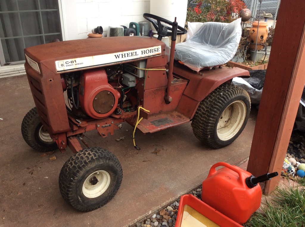

12 hp Kohler 1,020 #4 Posted March 3, 2017 Hey while we're on the c81 subject I have a 1978 c81 and was woundering if any one could give me an idea on the value. It does not have mower deck but it does run and is in decent condition. Really the only problem with it is that the seat is a little cracked up but other than that it is a great running tractor. 2 Share this post Link to post Share on other sites
