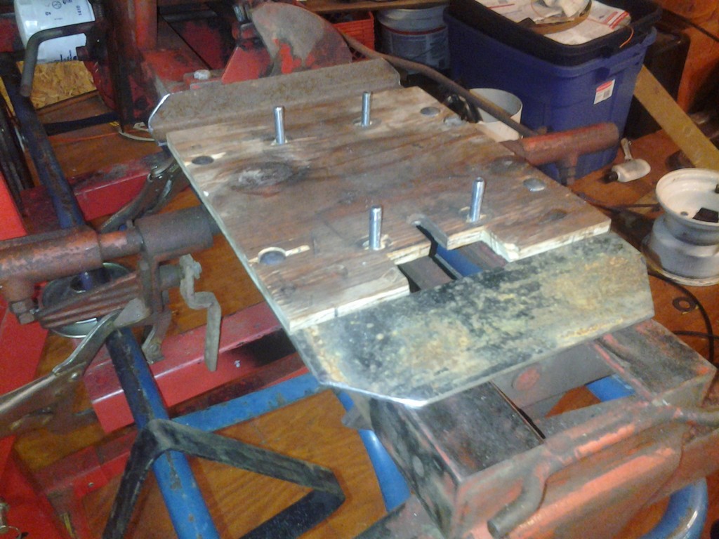

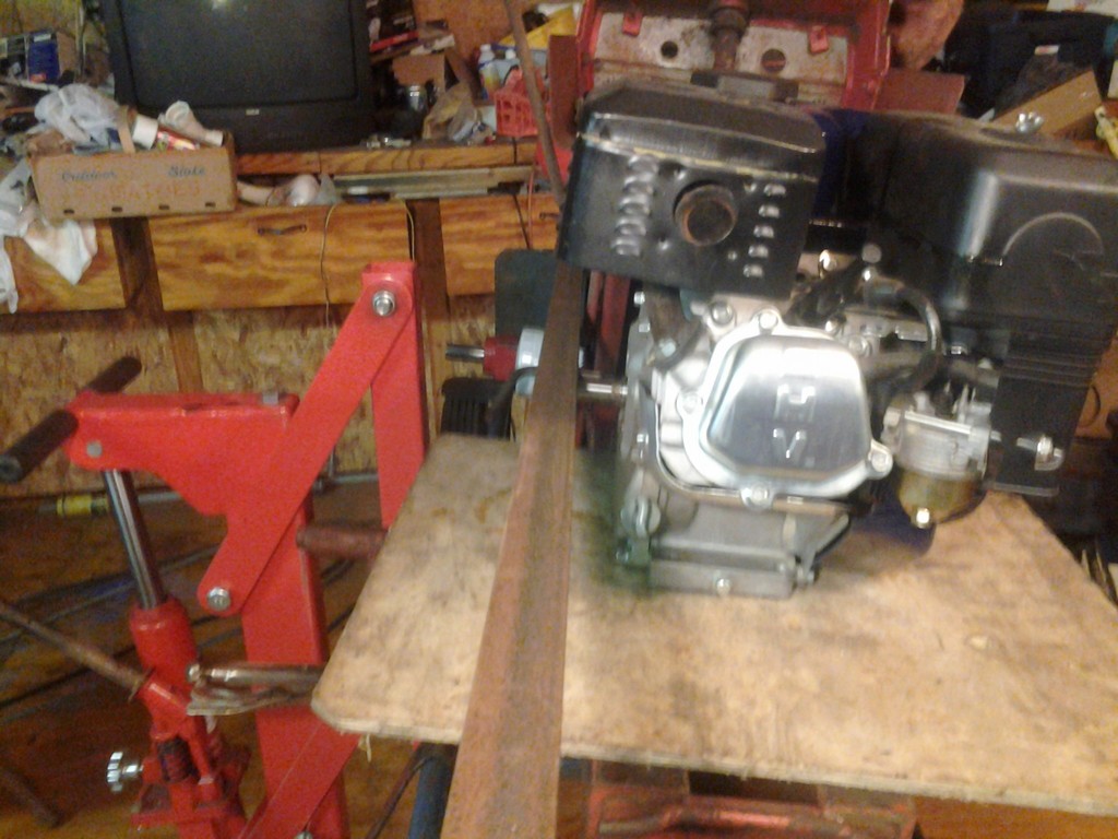

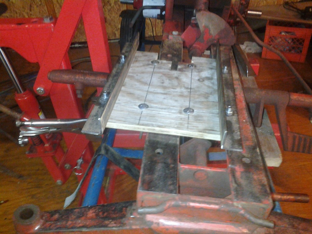

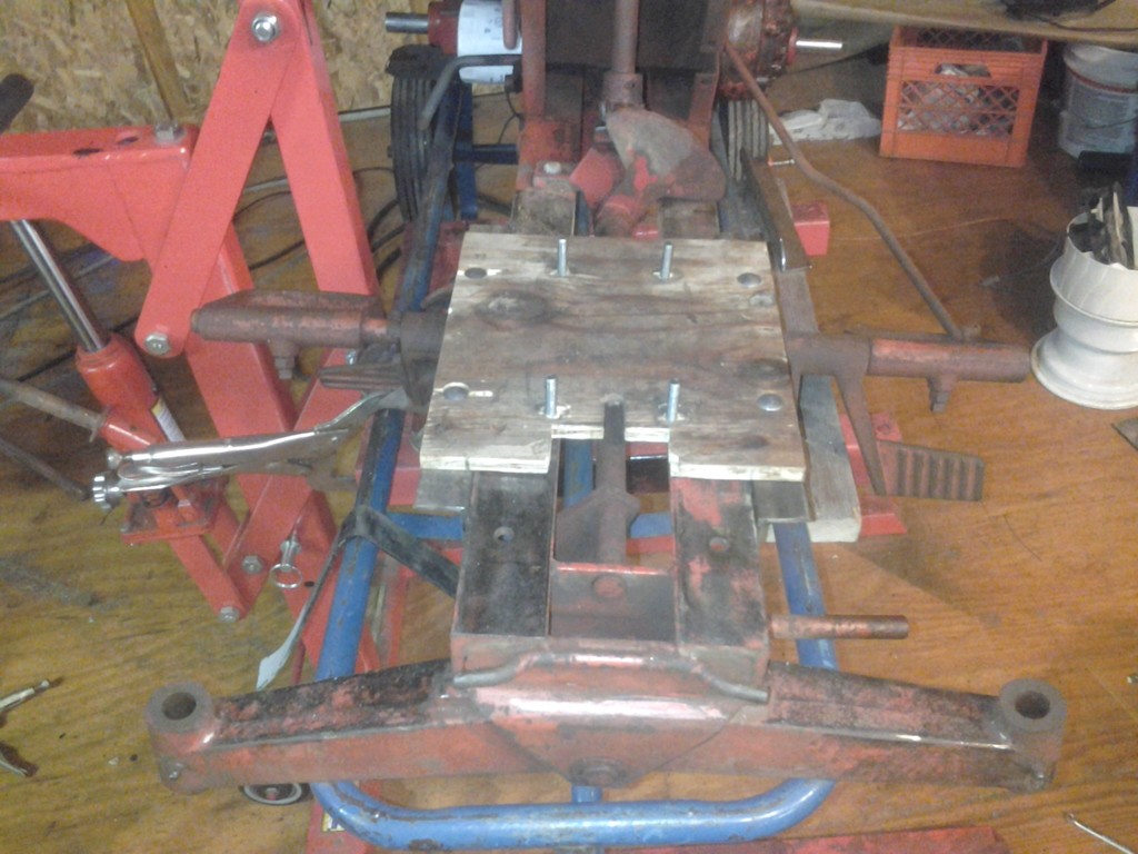

ohiofarmer 3,383 #9 Posted March 4, 2017 (edited) I did a HF swap in a small frame wagon puller. Harbor freight is super easy, but i did nor have a double drive pulley to think about an the wagon puller/sprayer First, i thought like a carpenter and made a perfectly square piece of plywood 16"x16" or so. Then I made sure that the engine was mounted perfectly square in the approximate center of the plywood. If it is not perfect, then adjustments can be made accordingly on the plywood Next, slide the plywood just to line up the pulleys. Once that was done, I marked the edges of the frame made the engine plate exactly 1.5" wider than the frame rails on each side and mounted 2 pieces of 1.5" angle underneath the plate that slide right next to the frame of the tractor. Table saws are nice to use for accuracy Now the engine is mounted perfectly square to the tractor. Add the pulleys and experiment with the engine sliding forward and back by c-clamping the angle irons to the frame. Once you are satisfied, drill the angles through the frame and bolt it in. I have always had problems trying to mount engines exactly accurate to a fixed plate. This system gives you a second chance. I will take some pictures of the process and post them ASAP. The first picture shows the engine mounted to the engine plate and pulley position aligned. Next,shows the angle irons added underneath letting the engine plate slide forward and back. The third shows the plate flipped over. the notch is for draining the oil. Notice that the angle irons stick out from the plate. That is so you can add hold downs to the front and back and fasten it through the top of the tractor frame, shown in the last picture. The sliding feature lets you clamp it on and run it to check the belt tension.before drilling Edited March 5, 2017 by ohiofarmer 1 Share this post Link to post Share on other sites
