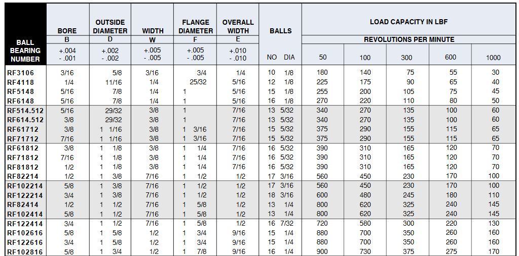

pfrederi 19,933 #13 Posted March 3, 2017 (edited) I have found Heim bearing in several older wheel horses...I believe them to be original equipment. Heim RF122214AP (Sealed on outside) Used to be made in USA do not know about now. About $8 at least from my supplier. Edited March 3, 2017 by pfrederi Share this post Link to post Share on other sites
doc724 925 #14 Posted March 5, 2017 On 3/3/2017 at 3:50 PM, pfrederi said: I have found Heim bearing in several older wheel horses...I believe them to be original equipment. Heim RF122214AP (Sealed on outside) Used to be made in USA do not know about now. About $8 at least from my supplier. I am away from my machines right now and no access to data. However, I believe the above cited P/N is the correct one for single sided sealed. change suffix AP to PP and you get sealed both sides. These are the ones I get from Motion Industries and I think they are about $12 each plus shipping. Outer races are machined, not stamped and yes, they are called "unground". I cannot remember if they are made in USA or Japan, but definitely NOT China. Share this post Link to post Share on other sites
