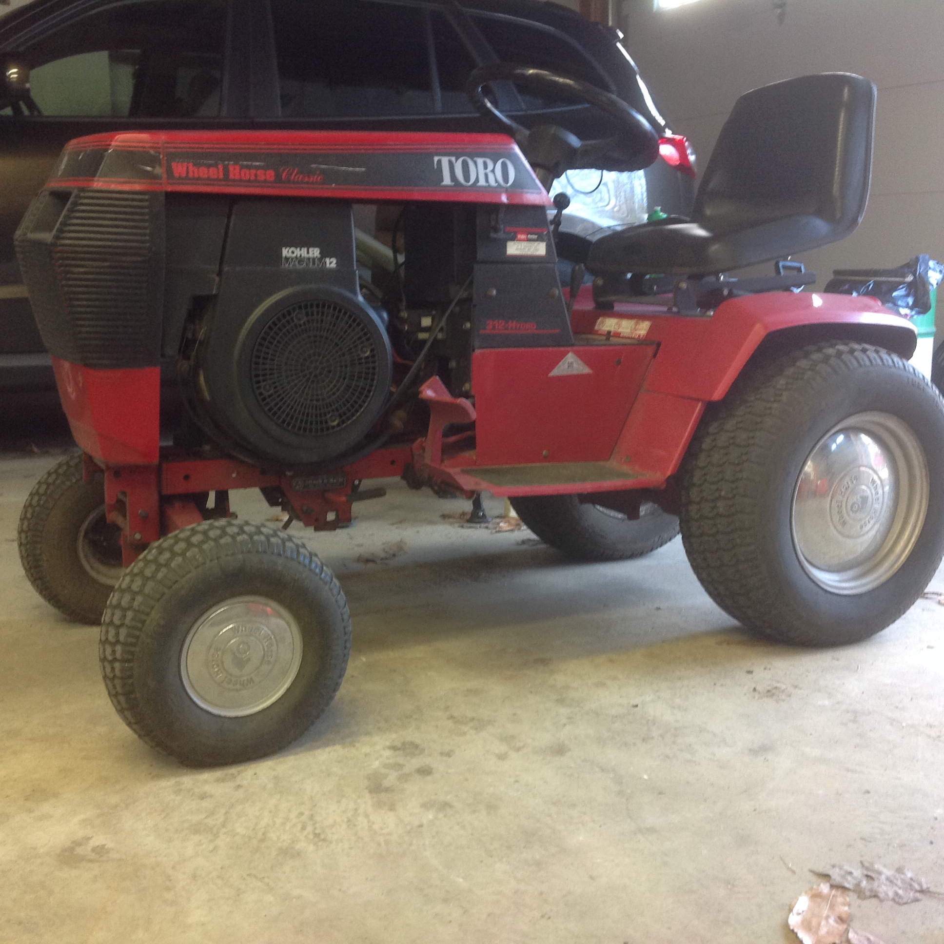

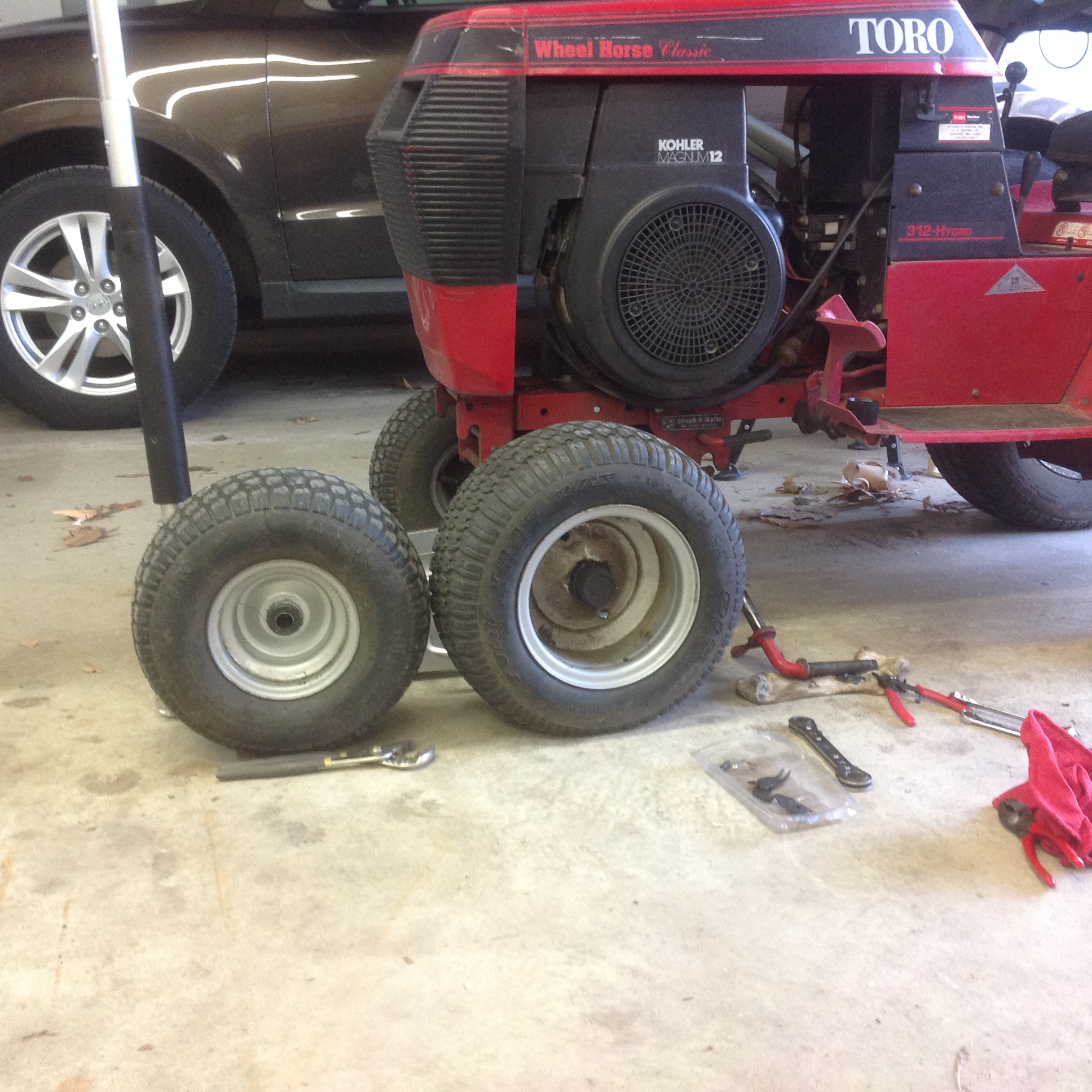

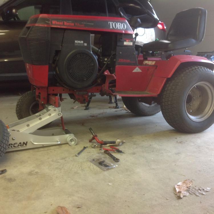

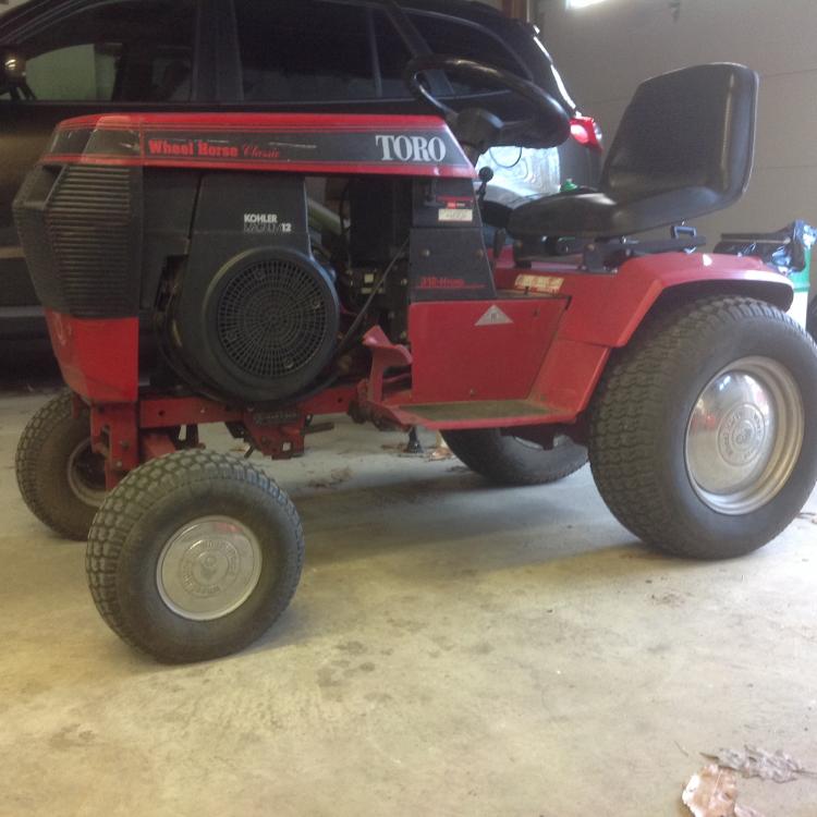

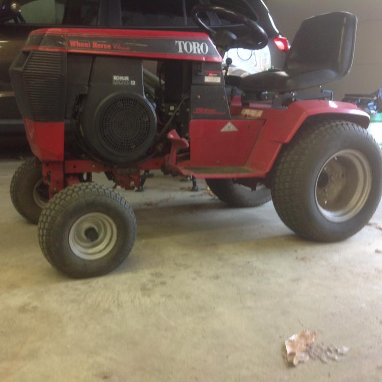

Sparky-(Admin) 26,868 #1 Posted February 26, 2017 Yesterday I picked up a 1990 312 Hydro. I like everything about it EXCEPT the itty-bitty front rims and tires. So my first task was to do the 8" rim and spindle upgrade. I made a trade with my neighbor....he got the 6" rims/tires and the hubcaps (I also don't like hubcaps) and in return I got the 8" rims/tires that matched the rears and the correct spindles. Definitly looks better! Next will be cast wheel weights and a plow bracket. Pics of course..... Mike...... Mike..... 10 Share this post Link to post Share on other sites

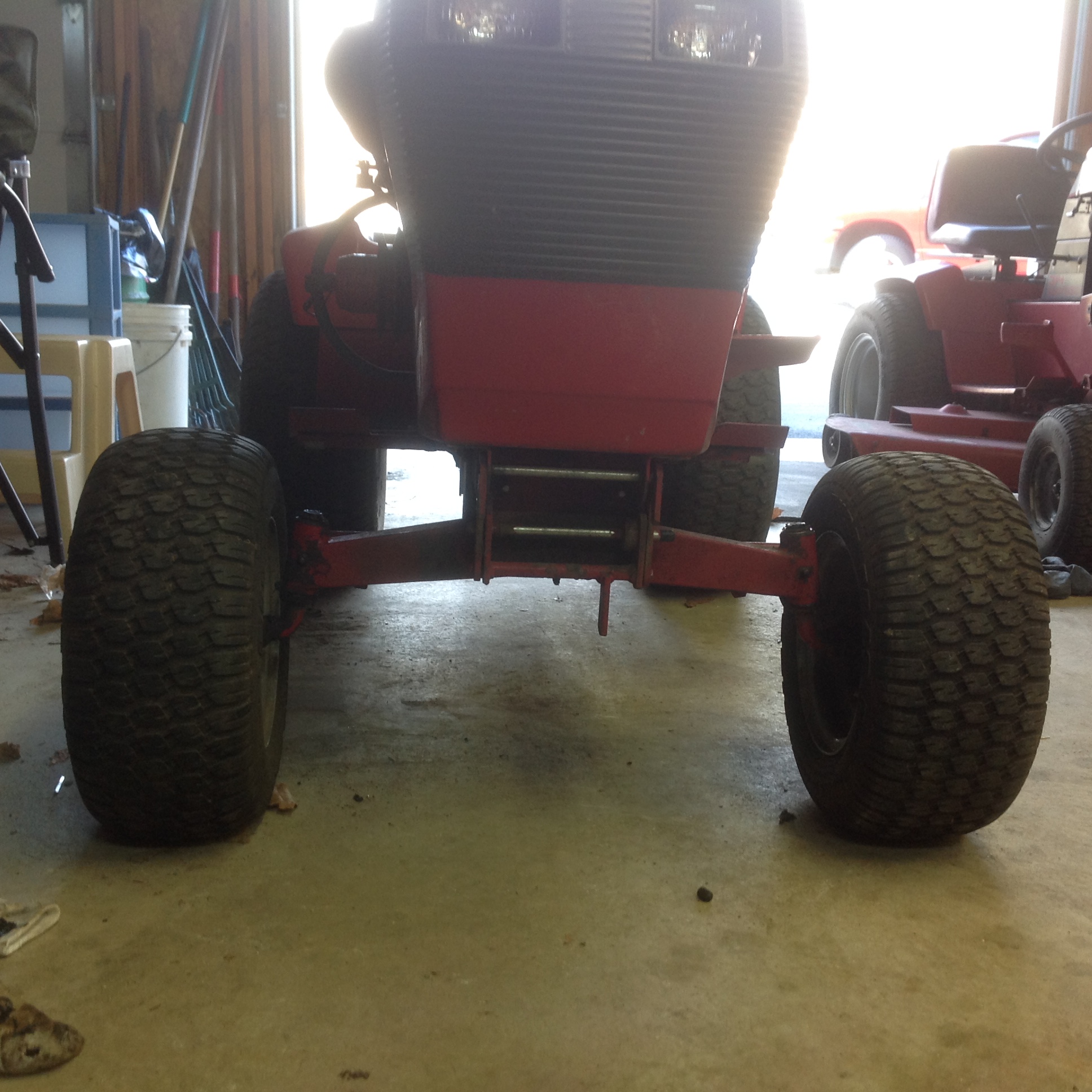

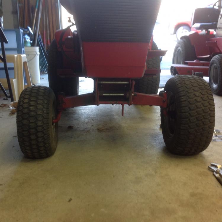

Sparky-(Admin) 26,868 #8 Posted February 27, 2017 1 hour ago, 953 nut said: If you plan to put a blade on the front the extra inch of clearance will be helpful. Actually there is no extra clearance if you install the spindles off the machine that the 8" rims came off. I did do the spindle swap so there is no clearance change. Mike..... 3 Share this post Link to post Share on other sites
aHorseofCourse 261 #9 Posted February 27, 2017 I just did this to my 308. What's the difference in the spindles? Share this post Link to post Share on other sites
Sparky-(Admin) 26,868 #10 Posted February 27, 2017 14 minutes ago, aHorseofCourse said: I just did this to my 308. What's the difference in the spindles? The spindles that came with tractors with 6" rims are taller. This was done to keep the tractor level. If you swap to 8" fronts and keep the original spindles your tractor is approximately 1" higher in the front. Not a big deal, but I wanted mine to be level. Mike.... Share this post Link to post Share on other sites
pfrederi 21,342 #11 Posted February 27, 2017 8" ride better on rough ground Share this post Link to post Share on other sites
aHorseofCourse 261 #12 Posted February 27, 2017 1 hour ago, Sparky said: The spindles that came with tractors with 6" rims are taller. This was done to keep the tractor level. If you swap to 8" fronts and keep the original spindles your tractor is approximately 1" higher in the front. Not a big deal, but I wanted mine to be level. Mike.... Ahh I see. I did notice the front end looked high after I puts the 8's on. I have a lot of hills at my place so the extra inch is welcomed. Share this post Link to post Share on other sites
