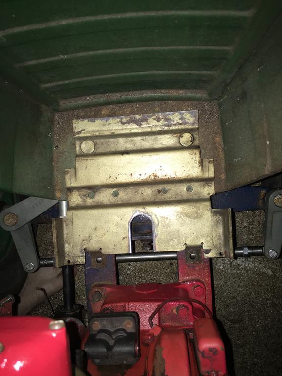

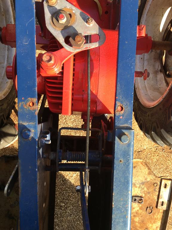

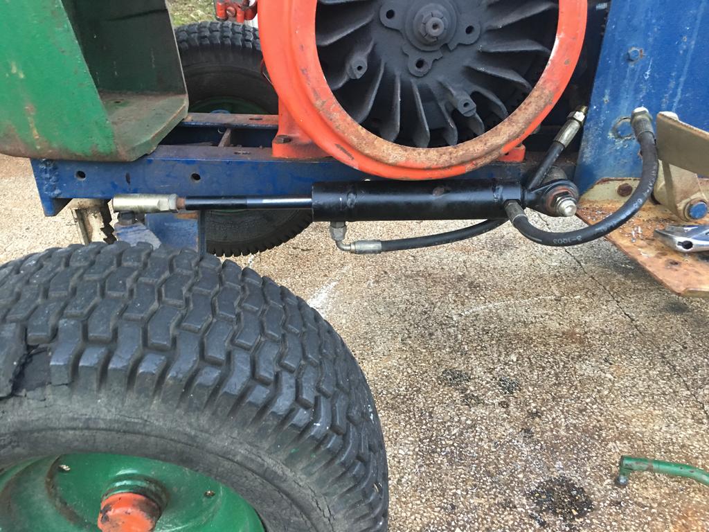

19richie66 17,937 #126 Posted November 1, 2017 Thanks Todd! Power steering cylinder mounted. Need to get another 90* hose when I get them made. Mounting valve is next. 1 5 Share this post Link to post Share on other sites
JPWH 6,544 #127 Posted November 1, 2017 Can't wait to see how you do the valve and control. Jay 2 1 Share this post Link to post Share on other sites

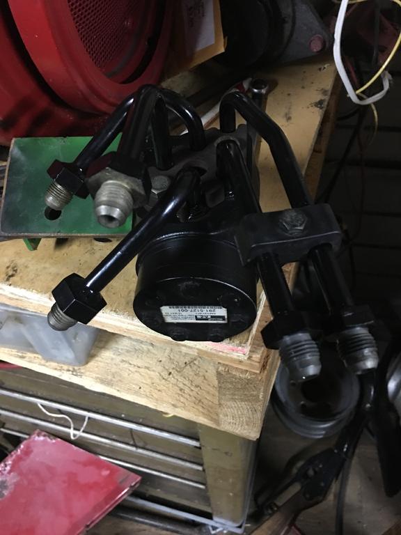

19richie66 17,937 #128 Posted November 1, 2017 (edited) Me too! This is somehow getting mounted where the fan gear sits now. I will be using the stock steering tower as the power steering shaft is the same diameter as the gt14. I will simply mount the valve, insert the shaft and cut it to length, weld the pieces back together and reinstall the steering tower. Sounds easy, hope it is. Then I will get all my hoses made. Edited November 1, 2017 by 19richie66 4 1 1 Share this post Link to post Share on other sites
JPWH 6,544 #129 Posted November 2, 2017 Gee Whiz. And I was figuring it would be challenging. lol 3 Share this post Link to post Share on other sites

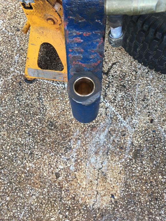

19richie66 17,937 #130 Posted November 5, 2017 Axle and spindles were a little on the worn side. Reamed out the axle to just under 1" and installed 7/8" id x 1" od brass bushings. Waiting for a 7/8" reamer to finish this up. Should take out all my slop. 5 1 Share this post Link to post Share on other sites

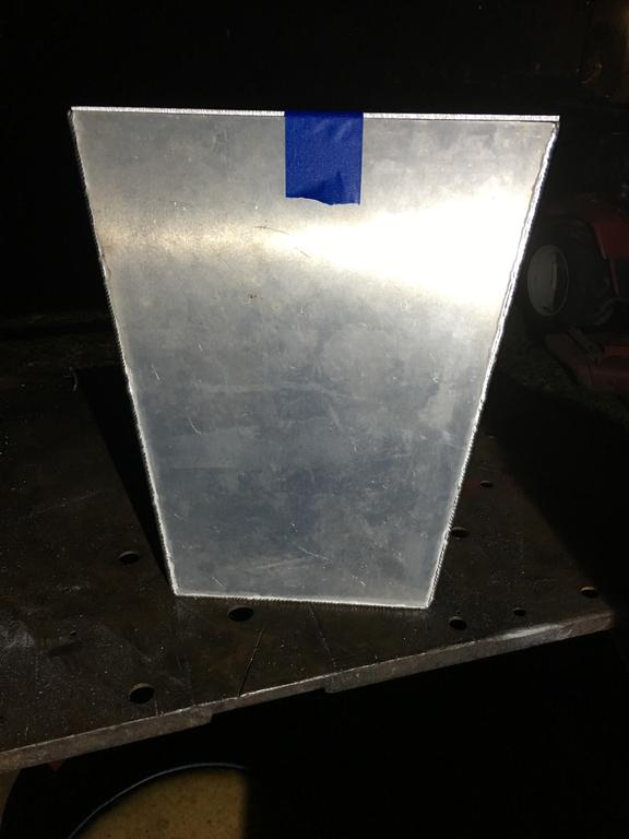

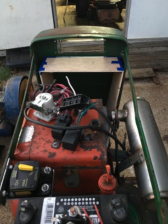

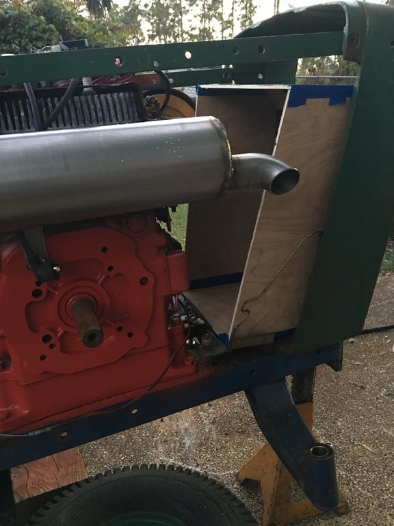

19richie66 17,937 #131 Posted November 6, 2017 Also today I thought I would try my pattern on some plywood for my fuel tank before I have the aluminum cut. Looks like it will work just fine. 9 1 Share this post Link to post Share on other sites
Aldon 4,833 #132 Posted November 6, 2017 Looks like your making great progress! 2 1 Share this post Link to post Share on other sites
JPWH 6,544 #133 Posted November 6, 2017 I see you use the same blue nails I do. 7 Share this post Link to post Share on other sites
19richie66 17,937 #134 Posted November 6, 2017 23 minutes ago, Aldon said: Looks like your making great progress! Trying to but this time change makes it hard. 11 minutes ago, JPWH said: I see you use the same blue nails I do. The blue is fuel proof 5 Share this post Link to post Share on other sites

ebinmaine 80,898 #136 Posted November 6, 2017 32 minutes ago, Aldon said: Looks like your making great progress! 9 minutes ago, 19richie66 said: The blue is fuel proof Maybe so but not having one WHOLE side in place (could) cause a small, slight leak. ....... 3 Share this post Link to post Share on other sites
19richie66 17,937 #137 Posted November 6, 2017 Well I have tile coming this week so the bathroom saga continues 💰💰💰. When I get that finished, IF the boss doesn't find anything else for me, I might get some more play time. 28 minutes ago, ebinmaine said: Maybe so but not having one WHOLE side in place (could) cause a small, slight leak. That is the see through side. Saves me from having to put a fuel gauge in it. 2 1 Share this post Link to post Share on other sites
ebinmaine 80,898 #138 Posted November 6, 2017 4 minutes ago, 19richie66 said: That is the see through side. Saves me from having to put a fuel gauge in it. Oh ! Ok. I get it now.... Not a bad idea. Share this post Link to post Share on other sites

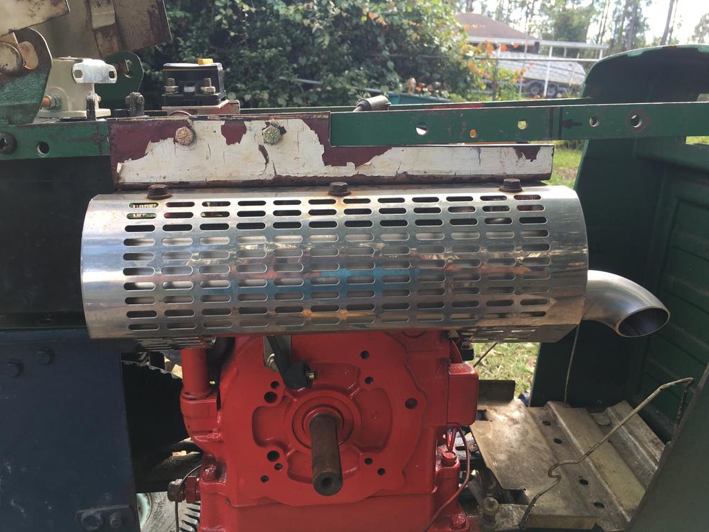

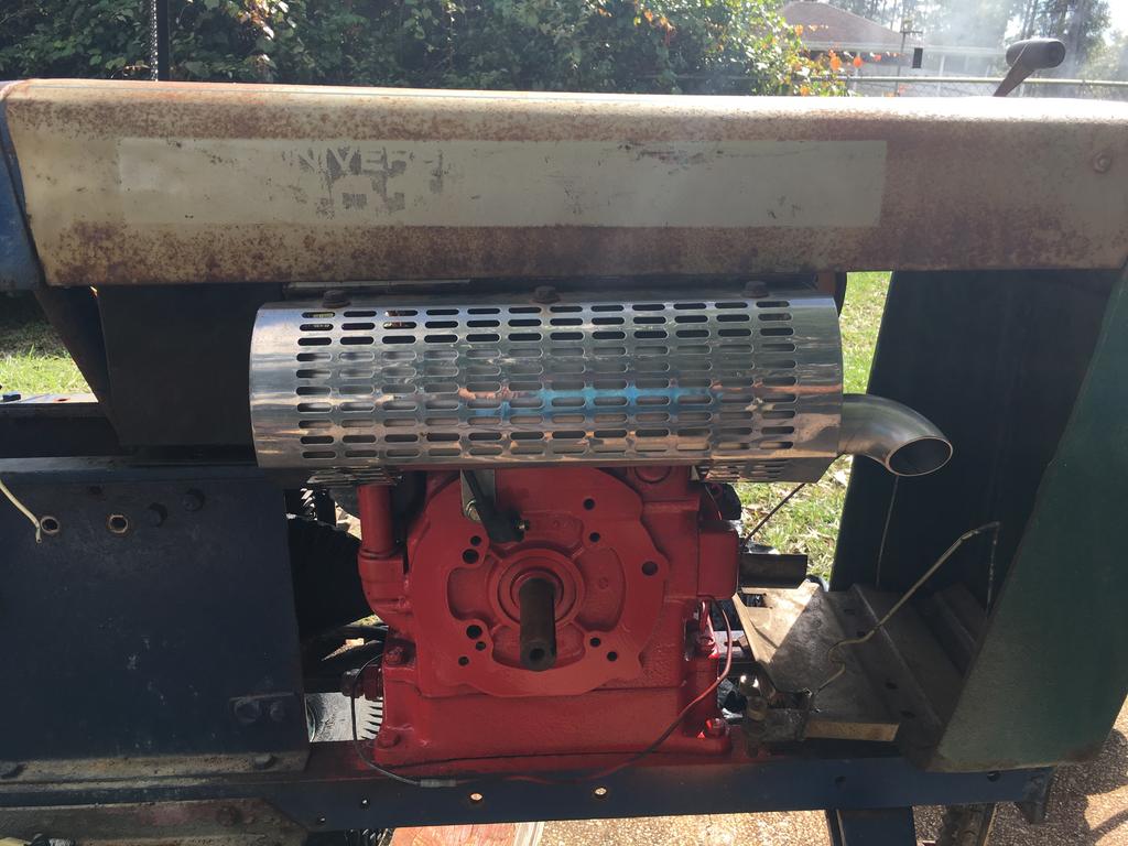

19richie66 17,937 #139 Posted November 6, 2017 Got the muffler guard mount made and installed. Need to make a lower bracket to keep it from vibrating. Also trying to get some electrical components mounted so I can make my wiring harness. 3 4 Share this post Link to post Share on other sites

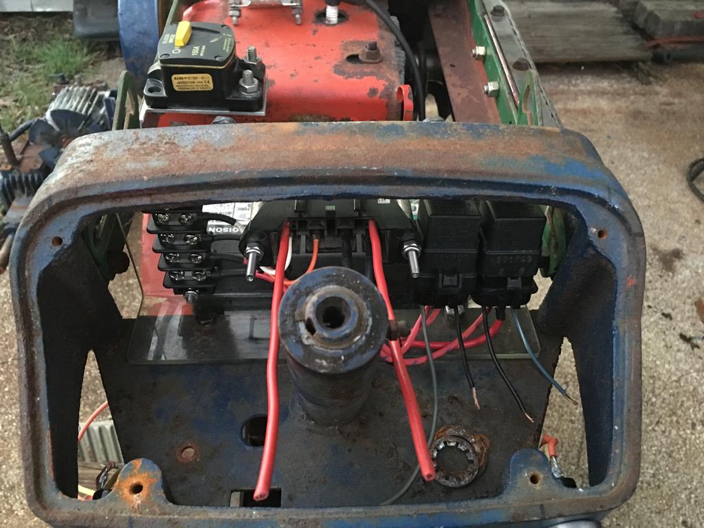

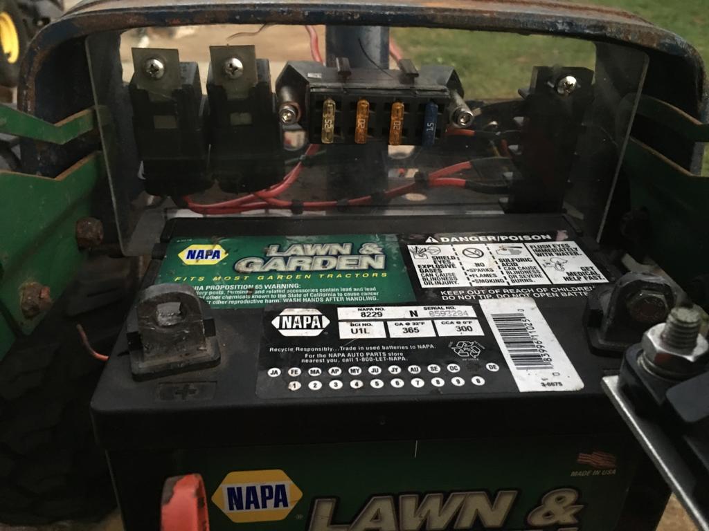

19richie66 17,937 #140 Posted November 13, 2017 While enjoying the nice cool evening breeze , I Started the wiring for the "firewall" I made from lexan. It will get painted so its not see through. I have two relays here, one for electric fuel pump and the other for the starter. Two fuses for switch power for a horn😂 And a power socket(cig lighter). I have a whelen patrol car switchbox I will be gutting and using the switches from that for headlights, fender lights and tail lights. Got to figure out a spot for a volt gauge. 2 4 Share this post Link to post Share on other sites

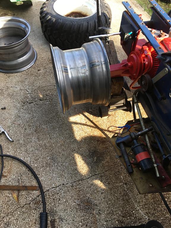

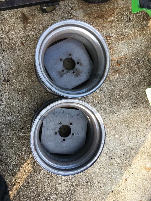

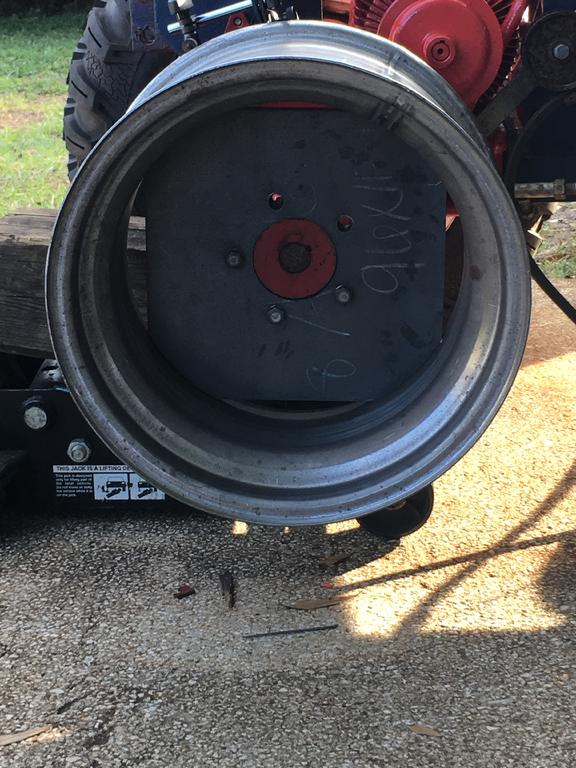

19richie66 17,937 #141 Posted November 26, 2017 (edited) New hoops welded up for the back. Bought rim shells from speedway and got the centers cut from a guy in ohio from 3/8" plate. It's like having built in wheel weights. These things are heavy. Just got to decide on what color I want to paint them. It's either Charcoal grey or gloss black. Also got the new front axle bushings reemed out and my "new" spindles installed. Thanks @Aldon. Worked great. Making a new stainless tie rod and have a new rod end for the steering cylinder. Waiting on the post man..... Edited November 26, 2017 by 19richie66 9 Share this post Link to post Share on other sites
Aldon 4,833 #142 Posted November 26, 2017 I have seen Gt14’s With rims painted navy Hayes Gray.... i personally liked it as it gave it an industrial look. Black is a nice color but gets dirty quick. i like the look of the new rims! 1 1 Share this post Link to post Share on other sites

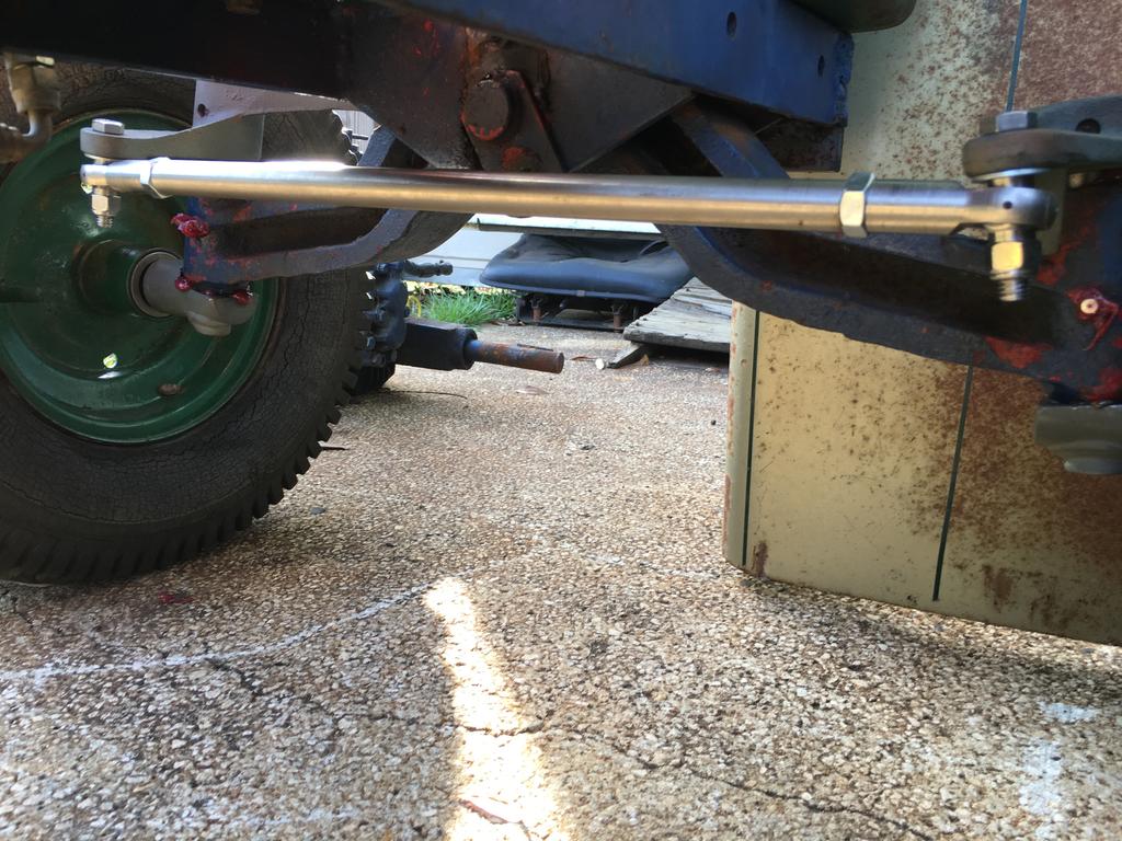

19richie66 17,937 #143 Posted December 4, 2017 New stainless tie rod/rod ends and a longer motion control lever. 4 3 Share this post Link to post Share on other sites

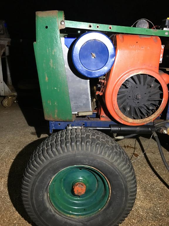

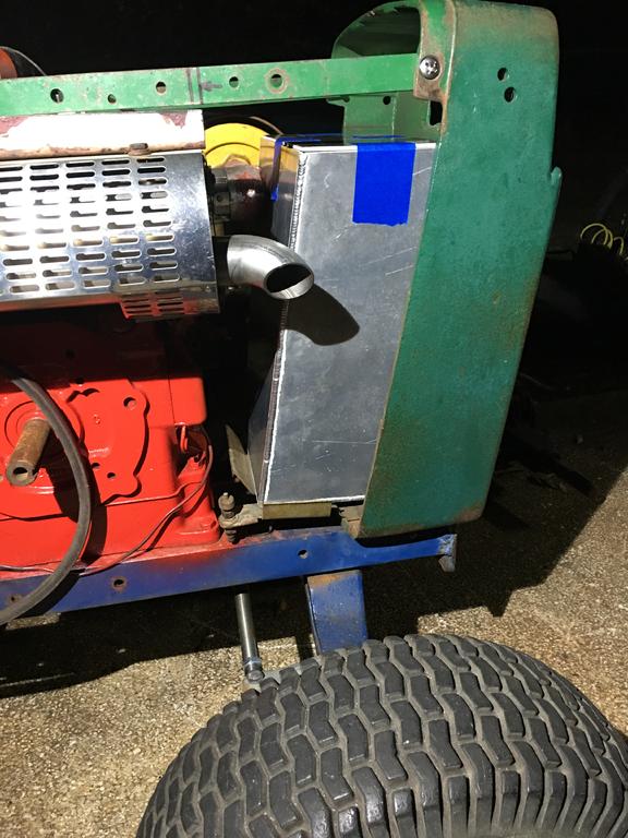

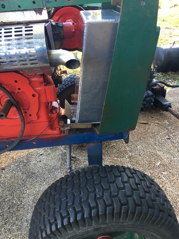

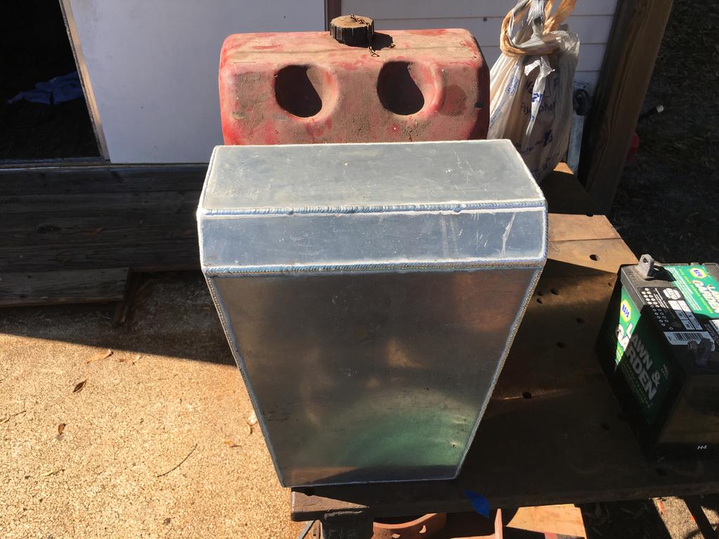

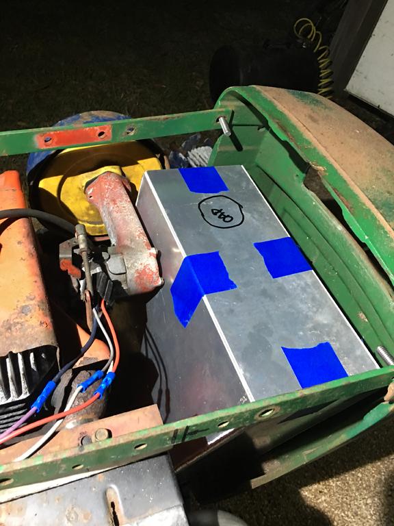

19richie66 17,937 #144 Posted December 8, 2017 Final test fit after cutting the front of the tank for the headlights. Filler neck and outlet on order. Almost there! 5 Share this post Link to post Share on other sites
elcamino/wheelhorse 9,363 #145 Posted December 8, 2017 Did you weld the gas tank ? 1 Share this post Link to post Share on other sites
ztnoo 2,302 #146 Posted December 8, 2017 No heat shield??? Seriously??? 1 Share this post Link to post Share on other sites

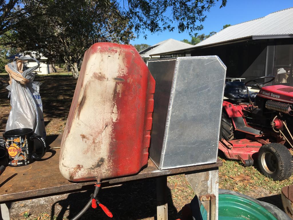

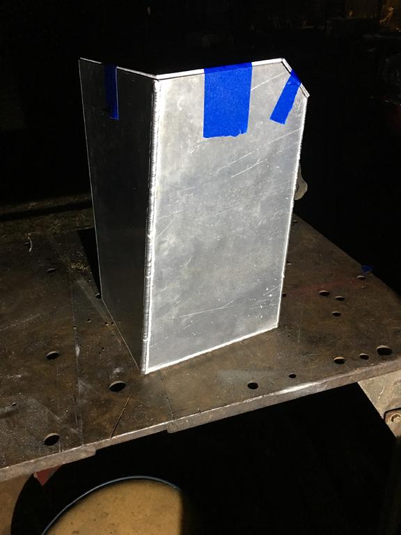

19richie66 17,937 #147 Posted December 8, 2017 8 minutes ago, elcamino/wheelhorse said: Did you weld the gas tank ? My son is welding it for me. I drew up all the measurements / pattern and my nephew cut the plate on his plasma table. 5 minutes ago, ztnoo said: No heat shield??? Seriously??? Let's see. 1) Not yet...It's not done. 2) The tank is not plastic 3) the exhaust manifold is a magnum style manifold that comes 90*out of the head, not 45* forward as the original does. It comes nowhere close to the tank. 4) if I need a heat shield, He will weld me one up from aluminum. I already have it planned out should it be needed. Seriously 7 Share this post Link to post Share on other sites
19richie66 17,937 #148 Posted December 10, 2017 Plenty of room. 3 4 Share this post Link to post Share on other sites

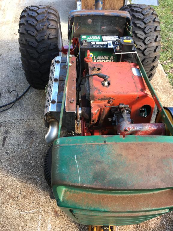

RandyLittrell 3,946 #149 Posted December 11, 2017 (edited) Man, that tank looks awesome!! Thats some mighty fine welding! Do you think there will be an issue with heat? Plastic kinda insulates, but the aluminum might heat up a little faster. I am assuming you probably have a plan already, just curious. I am going to be picking up a GT-14 myself early next year, so I am watching all the threads carefully!! Randy Edited December 11, 2017 by RandyLittrell 1 1 Share this post Link to post Share on other sites
19richie66 17,937 #150 Posted December 11, 2017 (edited) Thanks for the compliments. He does a good job. I am proud of him and the work he does. After cutting and notching the lower mounting plate, the tank sits at least 6" away from the exhaust manifold as I pushed it into the nose as far as it will go without hitting the headlight sockets. They will be replaced with LED's anyways. Also I do not have a 45* pipe coming out of the motor. It is a magnum style manifold. It comes off the head but goes straight out because of the way its made. I'll get a picture tomorrow after I get it back. My son is welding the filler neck and vent/outlet bungs on it tomorrow. I don't think it will need a shield but if it does, it has already been planned. Edited December 11, 2017 by 19richie66 1 2 Share this post Link to post Share on other sites
