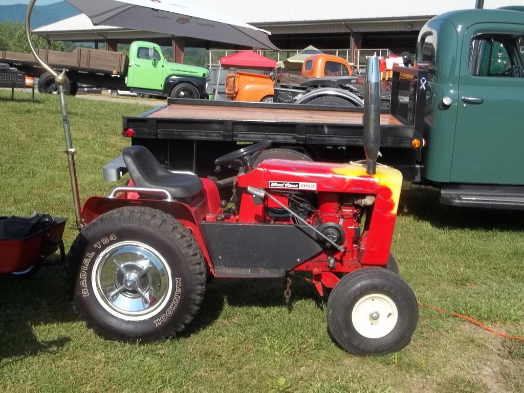

953 nut 68,529 #251 Posted March 14, 2018 9 minutes ago, 19richie66 said: It is unbelievable that 2 tractors, different models and transaxles, 15 years later the parts would fit in the same holes. Everyone knows the Ponds were thrifty, this just proving the point. Same thing with rear hubs, front axle assemblies, dash housings and hoods (well almost! just 3 1/4" off) are the same on the '63 953 and '70 GT-14. You wouldn't expect them to retool when they already have the molds and dies on hand. 6 Share this post Link to post Share on other sites

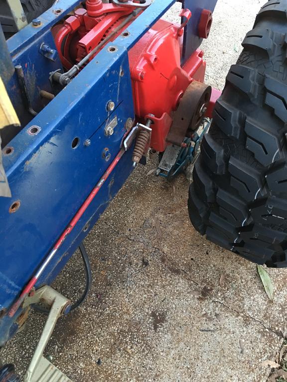

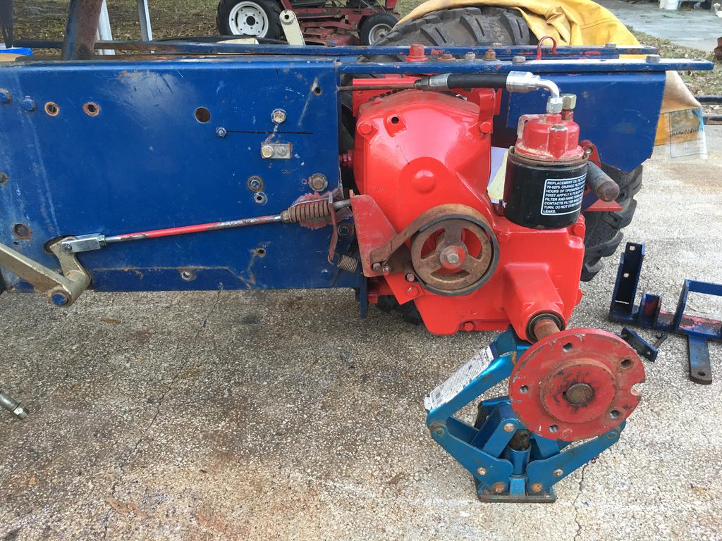

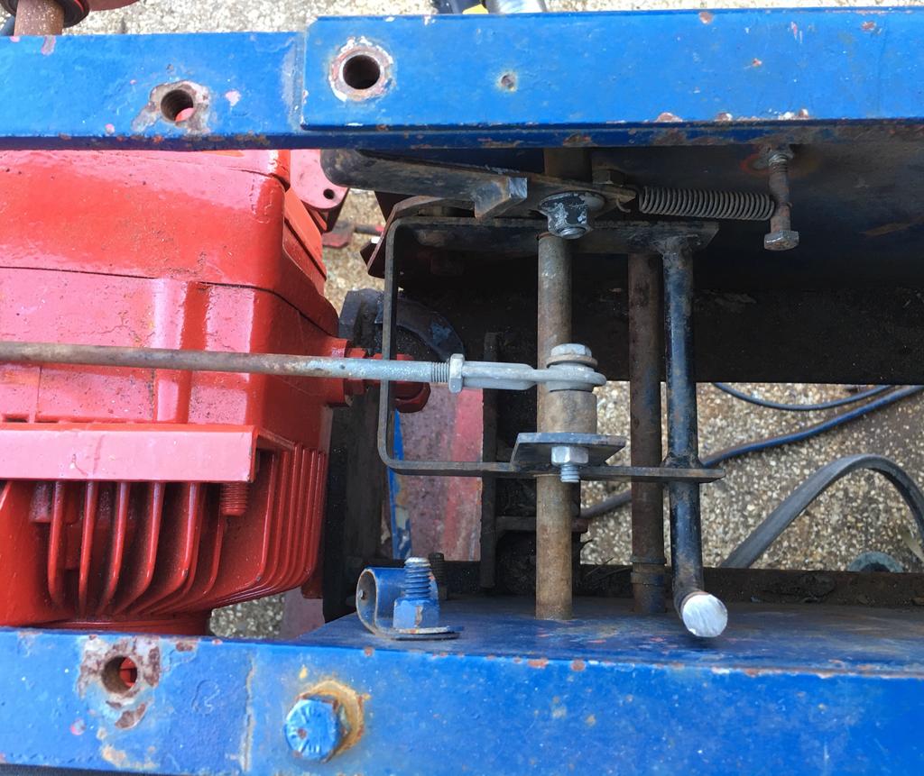

19richie66 17,932 #254 Posted March 14, 2018 (edited) Ok so more backyard brake engineering going in today. Got my slot cut for my rod to move back n forth in, trimmed a little off of it to clear a bolt. Just need to thread it for a clevis rod end and redrill a hole for the connecting bolt that goes through the brake band bracket. Needs to move out about 1/2” to line up. I got all of the motion control group mounted and the parking brake lock installed with the release spring. Just need to tweek the levers for clearance and make a new top plate. Think I might just leave the hand control lever for now to see how I like it. Running out if time and dont know if the foot control thing is going to happen yet. Little things here and there but I think she’s gonna work just fine. Edited March 15, 2018 by 19richie66 2 7 Share this post Link to post Share on other sites

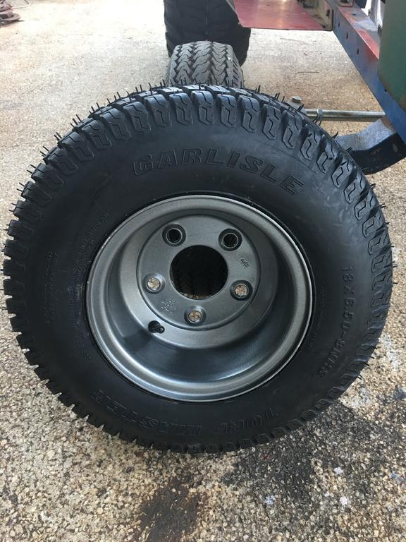

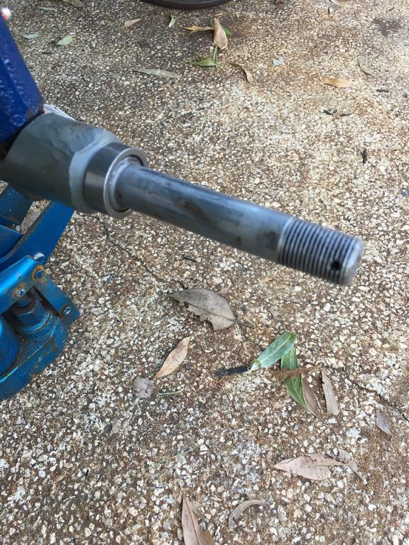

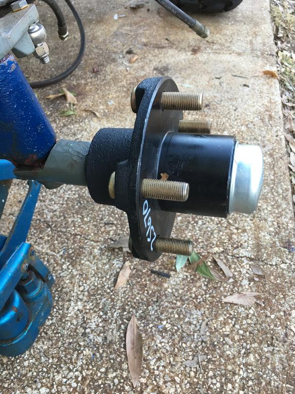

19richie66 17,932 #256 Posted March 16, 2018 (edited) Well today skittles got some new front hubs. I bought some 5 lug trailer hubs and wheels. I had to install a 3” long spanner to increase the axle size to 1” for the bearings. Also I took a 3/4” wide bushing (1” id x 1-1/4” od) and split it for the seal to ride on. New bearings, taces, hubs & seals. I just got my front wheels back from paint so they are going to sit for a while and harden up before putting tires on it. So I had to put my extra trailer wheels on it for now. Not sure I like the skinnies but I cannot wait to get my other wheels and tires on it. Also got the tensioner figured out today. Still have to make a spring tab for the tension spring. Edited March 16, 2018 by 19richie66 3 10 Share this post Link to post Share on other sites

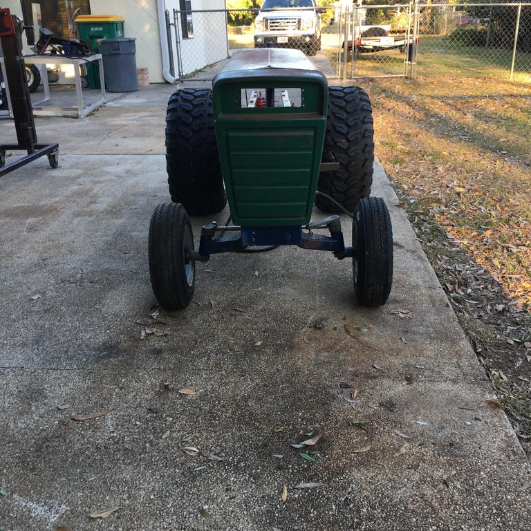

953 nut 68,529 #262 Posted March 16, 2018 10 hours ago, 19richie66 said: Not sure I like the skinnies I think the BIG and little makes a great combo. 1 1 Share this post Link to post Share on other sites
RandyLittrell 3,945 #263 Posted March 16, 2018 1 hour ago, 953 nut said: I think the BIG and little makes a great combo. Me too, I really like the skinnier tri-ribs with ags on the back! Randy 1 1 Share this post Link to post Share on other sites
19richie66 17,932 #264 Posted March 16, 2018 Being in the sandy soil area I am in, tri ribs would trash what little yard I have left when turning. Will probably get a set later and put them on these wheels just to change up. These are 4.80x8 and they nose dive the tractor just a hair. Share this post Link to post Share on other sites
953 nut 68,529 #265 Posted March 16, 2018 I have 5.70-8 tires on this 953 and it sits level. 3 3 Share this post Link to post Share on other sites

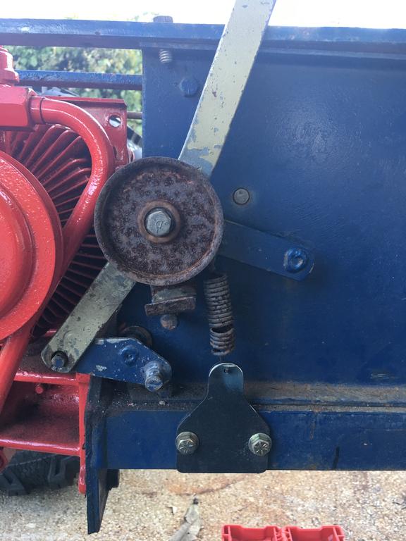

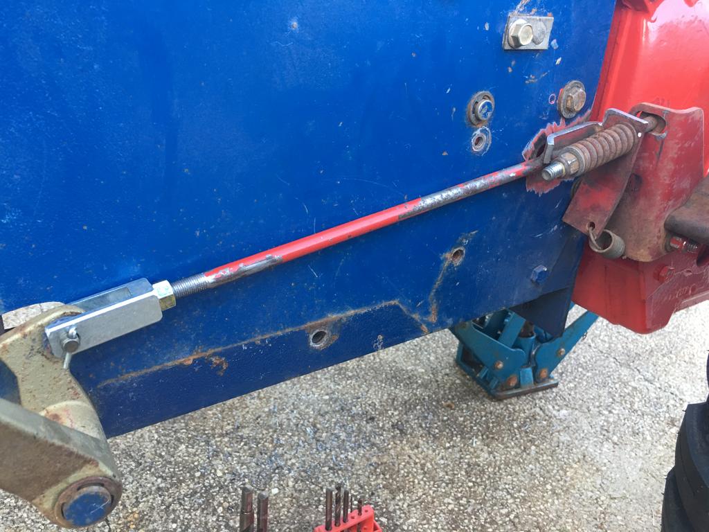

19richie66 17,932 #266 Posted March 16, 2018 Belt tensioner is finished and functional as well as the brake linkage. 5 Share this post Link to post Share on other sites

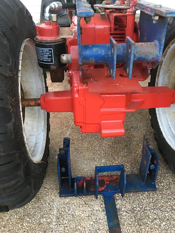

19richie66 17,932 #267 Posted March 17, 2018 Hydro filter mounted. Now just have to figure out my hydraulic hoses, lengths and fittings. Called Lowell and hope to be getting him to make me some. All parts are wheel horse but the power steering valve and cylinder. 3 1 Share this post Link to post Share on other sites

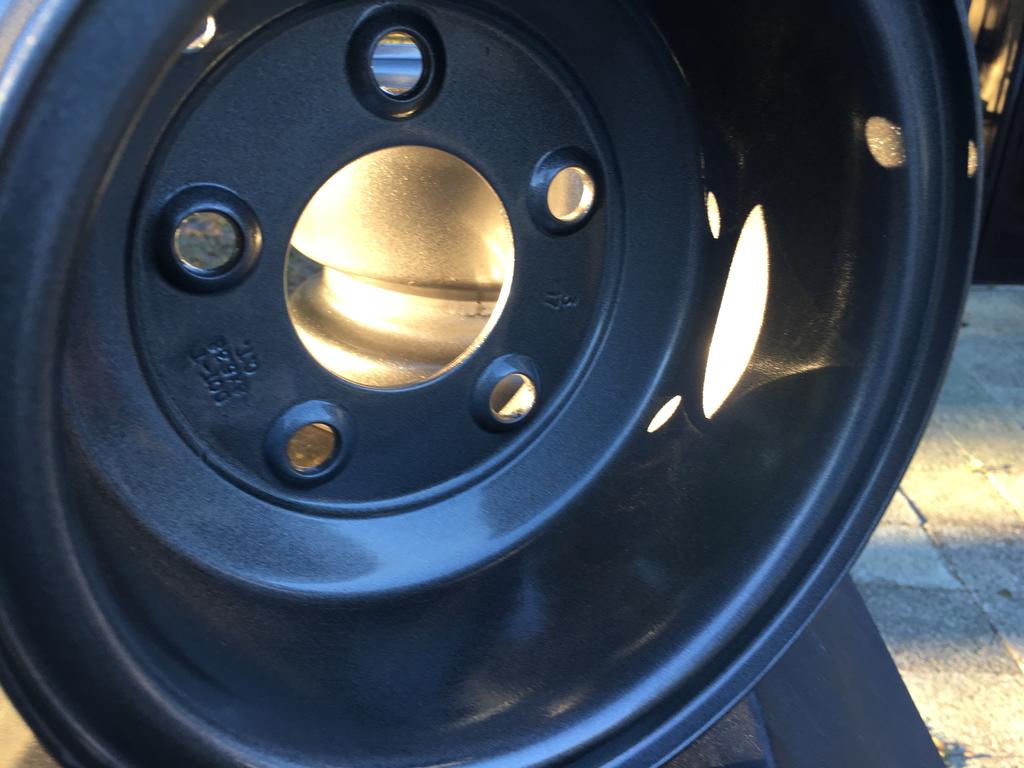

19richie66 17,932 #270 Posted March 20, 2018 Wheels are done. Just need stems and chrome lug nuts. 3 6 Share this post Link to post Share on other sites

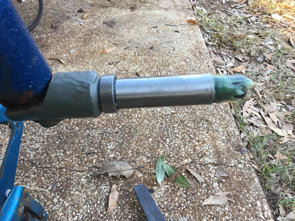

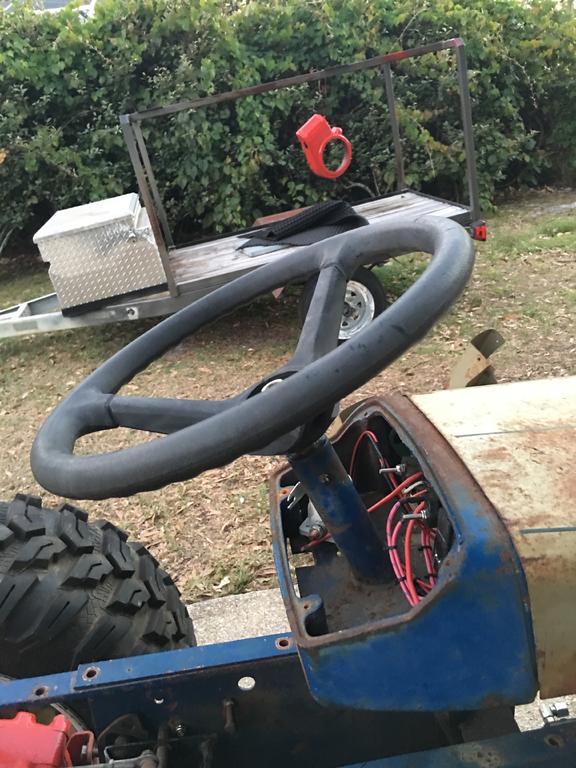

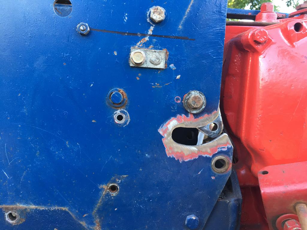

19richie66 17,932 #274 Posted March 29, 2018 (edited) Lengthened the steering shaft today 3” so I could get my wheel on it. Fits nice now. Figured while I had the welder out and nice weather I would go ahead and notch the shifter cage to clear the hydraulic fitting that is on the front of the pump. Welded that, all the cracks in the usual places on the rear of the fenders and the rear cross brace behind the seat. Also beat the dimples out of the extra set of rear fenders and hammer & dollied the rest of the sheet metal for the fender mounts. Also I have @wheelhorseman lowell making my hoses. Hope to have them soon and then I can get her plumbed and hopefully operational. Just Chuggin’along Edited March 29, 2018 by 19richie66 3 6 Share this post Link to post Share on other sites
