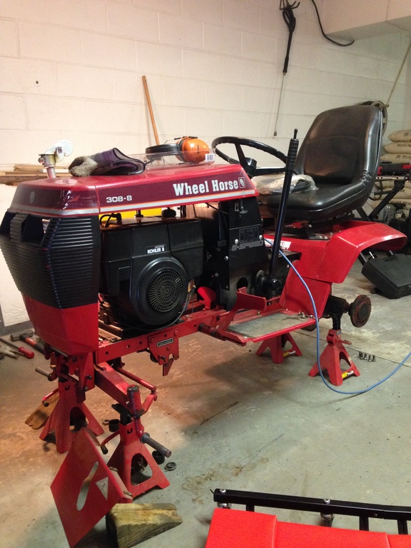

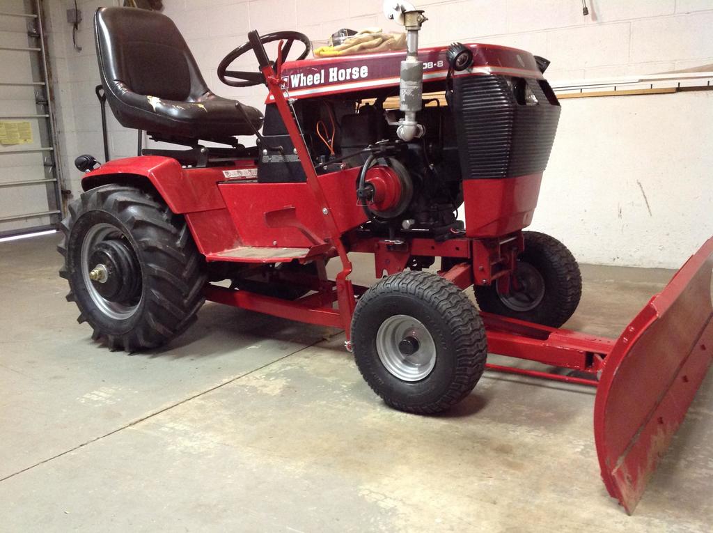

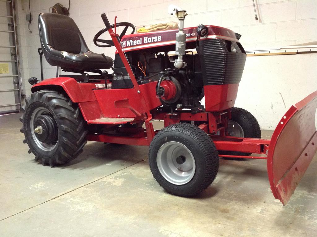

aHorseofCourse 261 #1 Posted February 26, 2017 Starting off with the basic horse I bought from my neighbor for $145. The 37" deck was beyond repair but I have a Deere I mow with so I didn't need that. I just needed a wood/dirt hauler and snow machine. I'd rather have an 8 speed than automatic so I decided to upgrade the 308 rather than buying a bigger 400 or 520. Another reason for the repower. I've always been partial to Briggs motors, so I thought why not drop one of the smoothest running and reliable engines I know of in there. A 42ci 18hp opposed Twin. Finally found one on eBay last fall. After tearing it apart it turned out to be too far gone to restore but it was off a wheel horse, I'm guessing a work horse. So it gave me all the tins, pto, and engine mount I needed. Then a friend of mine found a nearly identical twin off a craftsman that he gave me. So between the two I can make one. And so it began... What I started with Started off repainting the wheels, new rubber, and wheel weights. Carlisle turf II front and tru power lugs in back. I don't have a torch so you'll have to excuse the crude angle grinder cuts. 1" bolt with barbell weights. 55lbs of weight and 15 for the bracket each side. 12 Share this post Link to post Share on other sites

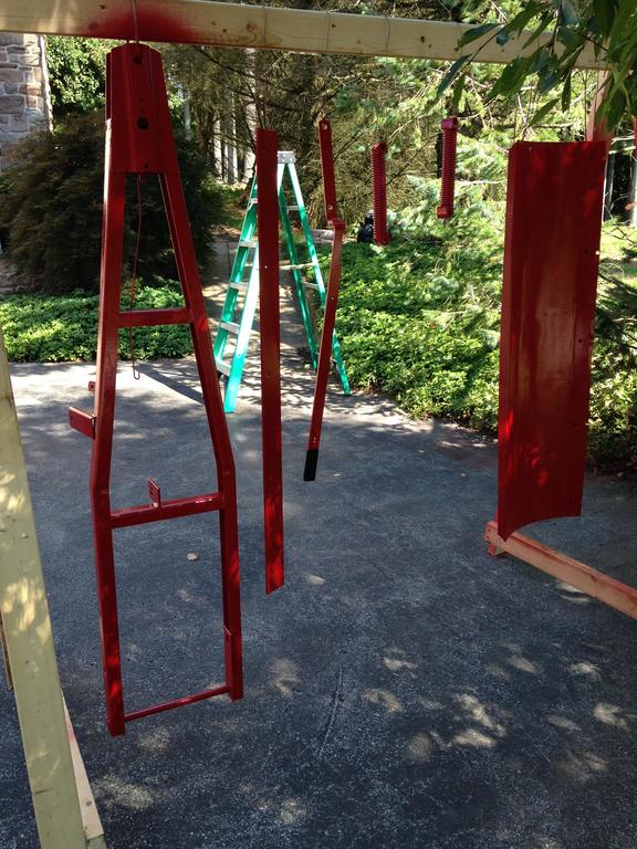

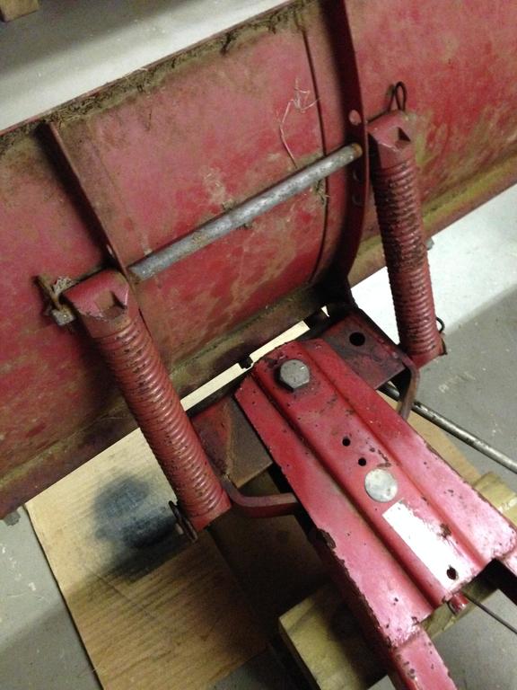

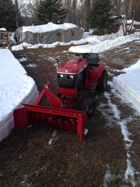

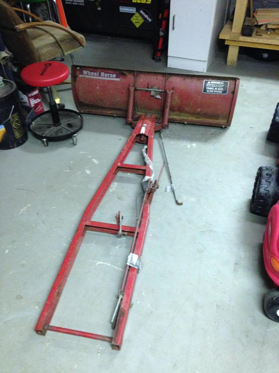

aHorseofCourse 261 #2 Posted February 26, 2017 Found a single stage and blade on Craig's list last year. The blower was in mint condition and just needed geased basically. The blade was in typical condition and just needed a weld and paint job. 13 Share this post Link to post Share on other sites
Aldon 4,832 #3 Posted February 26, 2017 Like the Briggs opposed twins myself. Look forward to seeing the result. Share this post Link to post Share on other sites

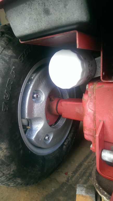

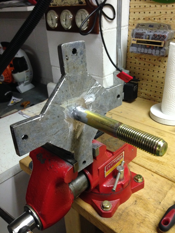

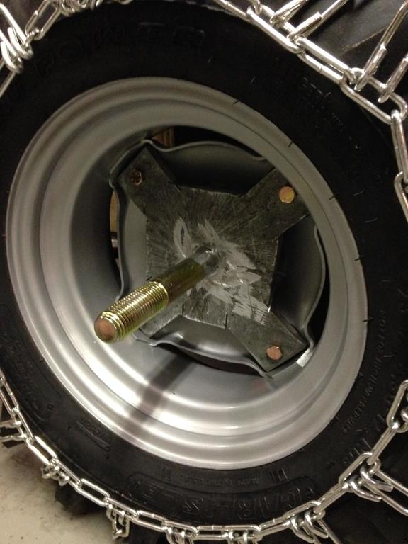

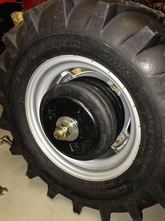

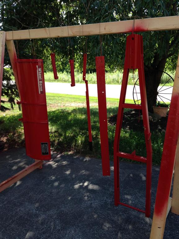

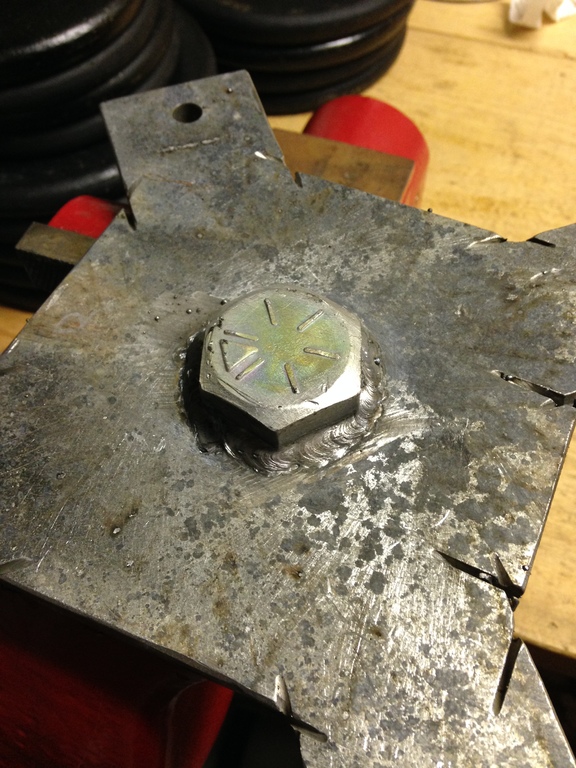

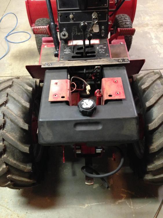

857 horse 2,588 #4 Posted February 26, 2017 1 I like the detail you put into the weight bracket,,,,how it fits into the wheel.....nice forthought,,,,,, 2 paint job looks amazing......I have an entire machine apart ,,,ready for sanding and paint,,,Is that Sunrise Red,???? 3 We will be looking for you at THE BIG SHOW in June in Ardentsville,PA,,,bring a lawn chair and that neighbor,,,, stay a while,,,,thank=you for sharing.... Howard 857 Horse in VA 2 Share this post Link to post Share on other sites
aHorseofCourse 261 #5 Posted February 26, 2017 11 hours ago, Aldon said: Like the Briggs opposed twins myself. Look forward to seeing the result. Only problem is parts are very hard to find now. I just rounded up everything I needed took a few months 1 hour ago, 857 horse said: 1 I like the detail you put into the weight bracket,,,,how it fits into the wheel.....nice forthought,,,,,, 2 paint job looks amazing......I have an entire machine apart ,,,ready for sanding and paint,,,Is that Sunrise Red,???? 3 We will be looking for you at THE BIG SHOW in June in Ardentsville,PA,,,bring a lawn chair and that neighbor,,,, stay a while,,,,thank=you for sharing.... Howard 857 Horse in VA 1. Thank you it took a lot of test fitting to get it right 2. It is I.H. red from tractor supply. I mix it with the reducer and hardener and spray it out of a gun on my compressor. It goes on great and is very durable and shiny as its real oil based paint http://www.tractorsupply.com/tsc/product/majic-town-country-tractor-truck-implement-1-gal-i-h-red?cm_vc=-10005 3. I will keep that in mind thanks 2 Share this post Link to post Share on other sites

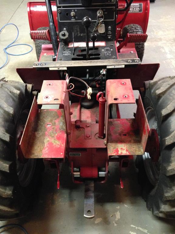

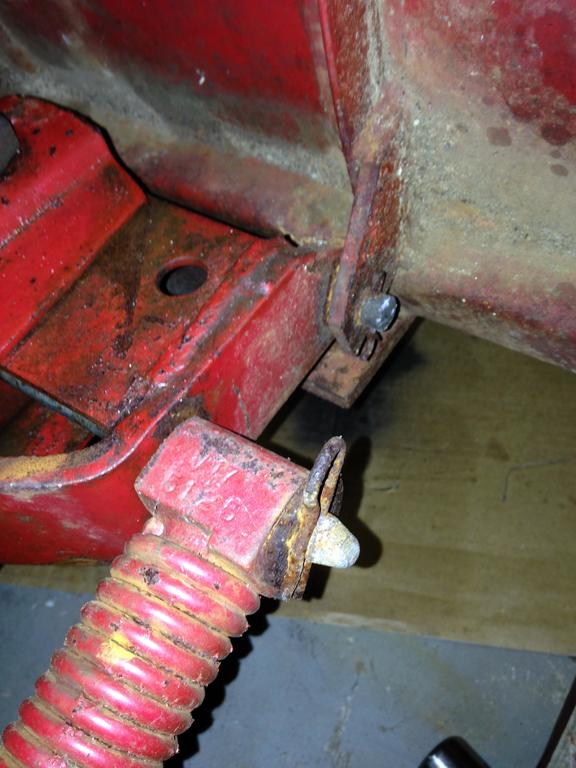

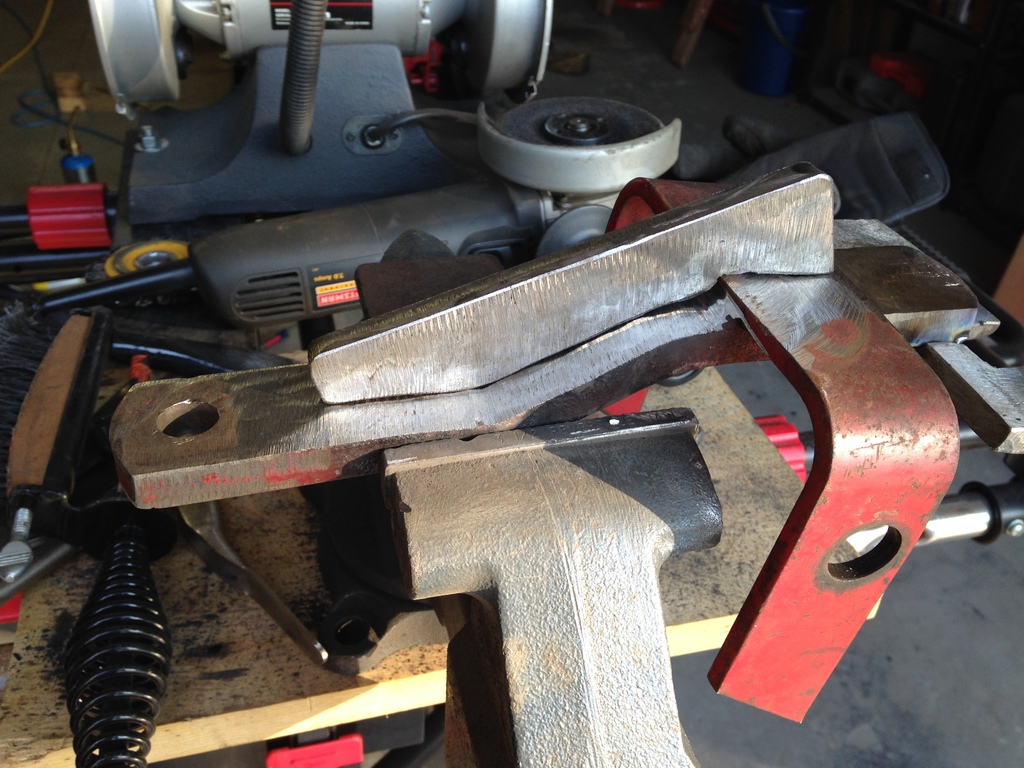

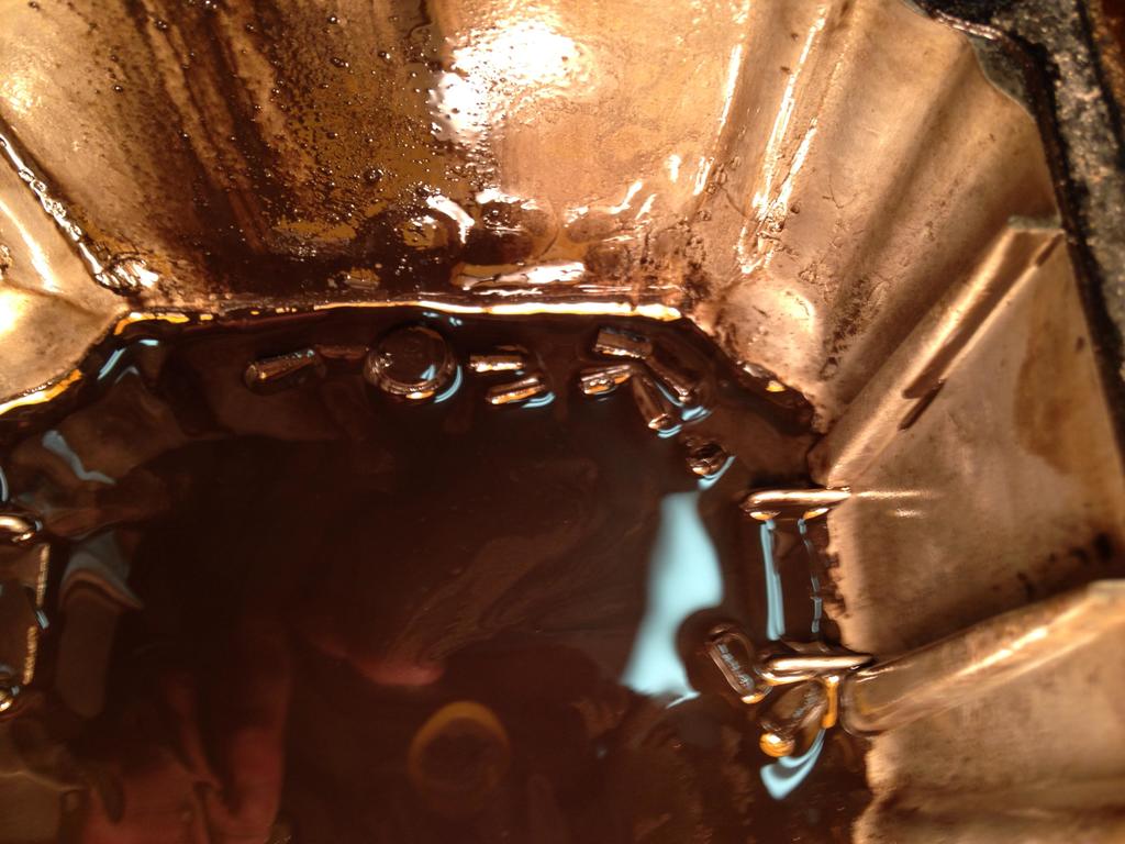

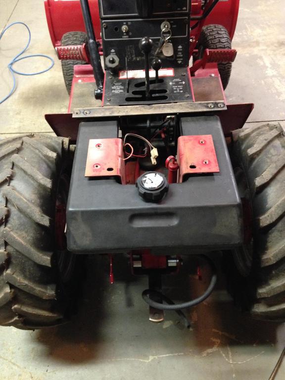

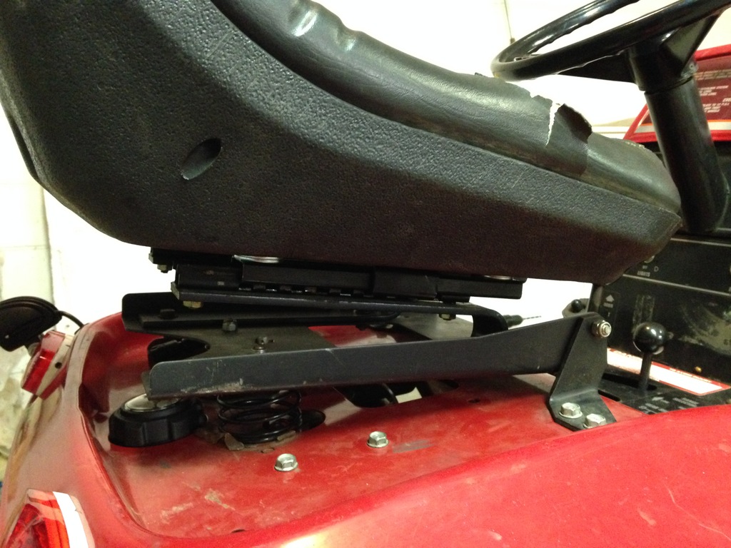

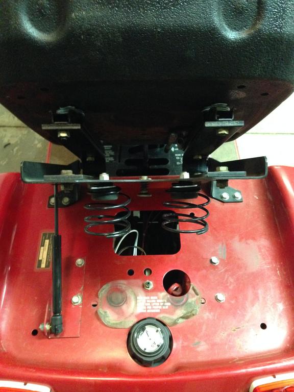

aHorseofCourse 261 #6 Posted February 26, 2017 More progress. My hitch was bent down pretty far so I bent it back and strengthened it up. Also added a plate to spread the weight out on the under side of the tranny the tank on on my little 8 horse Kohler is on the engine so I had to get one off a 310 on eBay. Also found a seat bracket with the springs and adjuster. Got a new shock at autozone. 5 1 Share this post Link to post Share on other sites

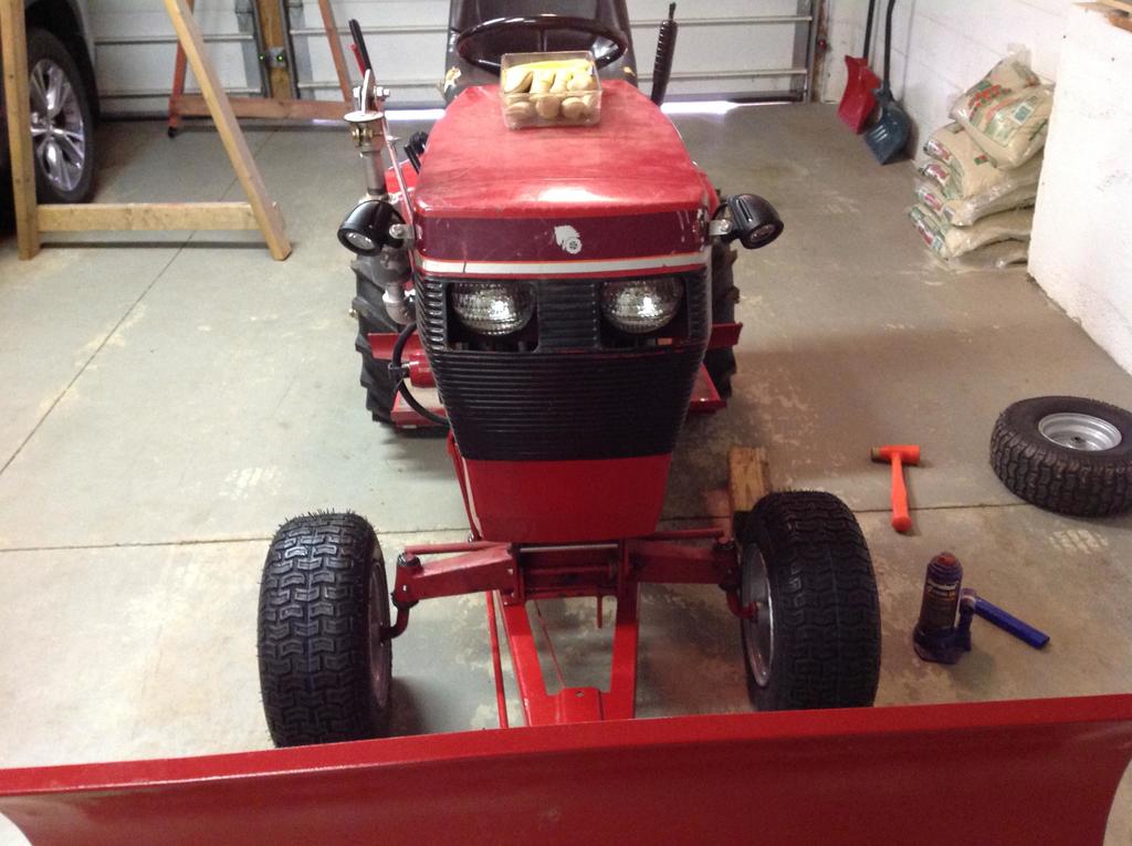

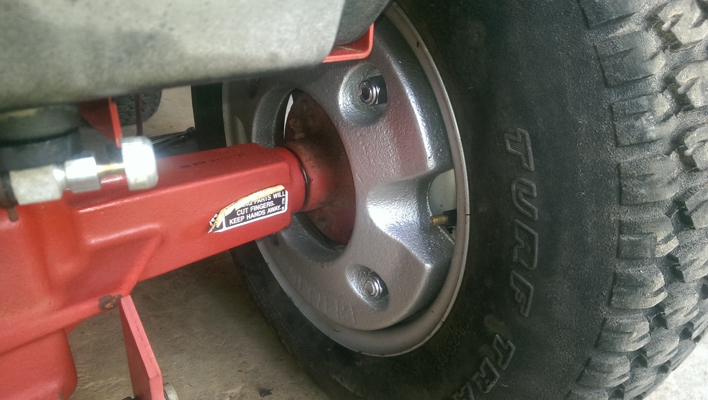

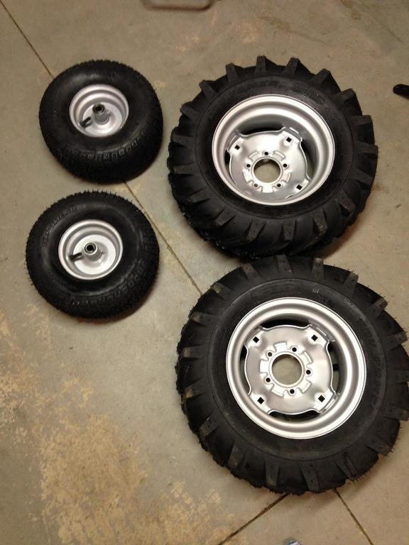

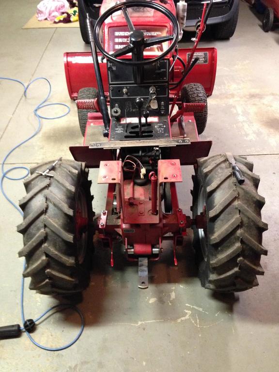

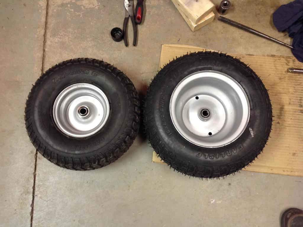

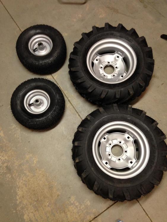

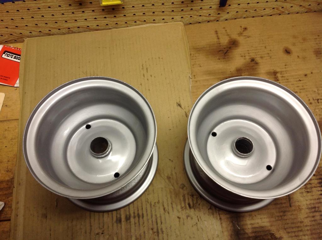

aHorseofCourse 261 #10 Posted February 28, 2017 Also did the 8" wheel upgrade. Originally I did this to get more clearance with the blade. I didn't realize until yesterday the spindles are different for the larger wheels and the front stays the same height. I think I'm going to leave it as is because I really need the clearance. I am selling the 6" wheels if anyone is interested. Tires and repaint are only a year old. 7 Share this post Link to post Share on other sites

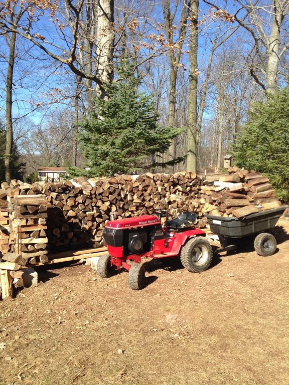

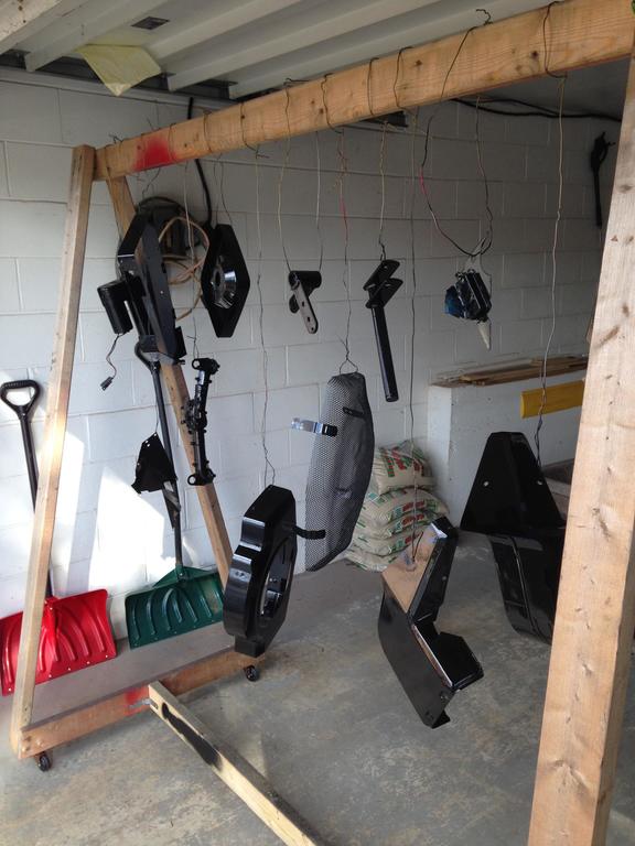

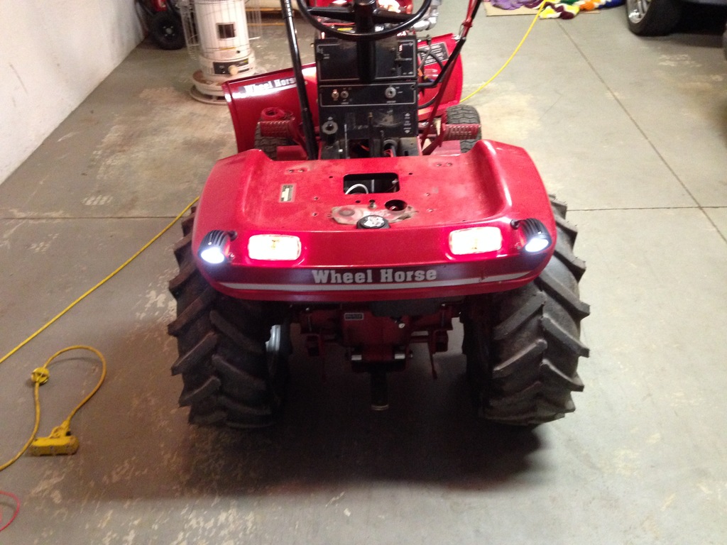

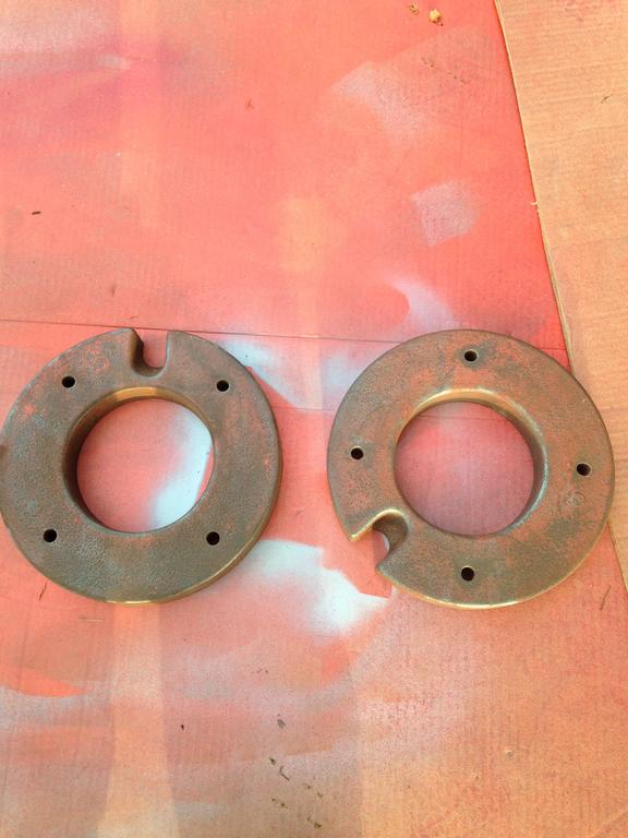

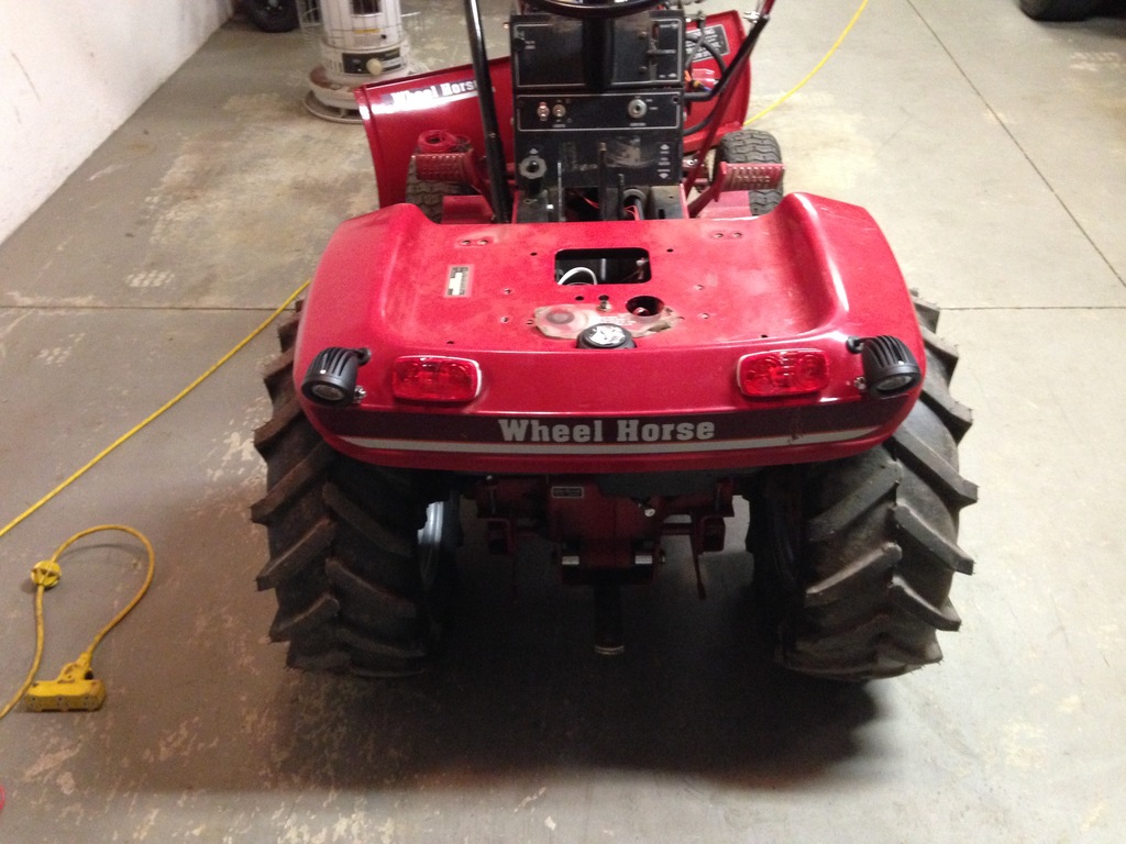

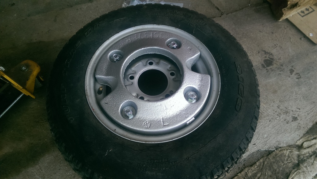

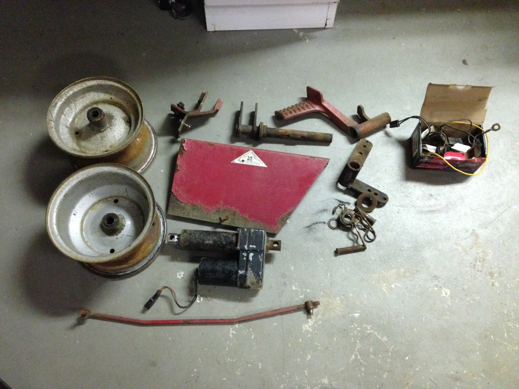

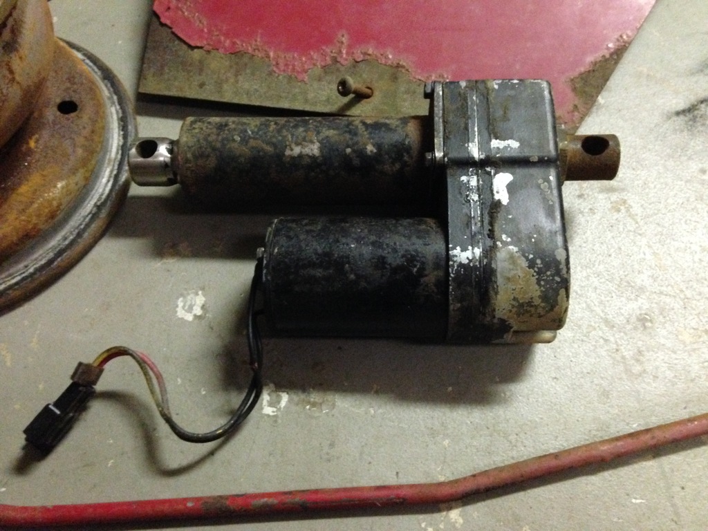

aHorseofCourse 261 #11 Posted February 28, 2017 This is the last update and where I'm at now. I recently found the holy grail on eBay, electric lift kit. Guy was selling a non running 417-8. I messaged him and said I'd be interested in the lift and front wheels if he didn't sell it and wanted to part it out. About a week later he was tearing it apart. Also had inside rear weights I got. They are about 25lbs each. Not sure if they are wheel horse parts, did wheel horse offer these? I am in the process of painting this stuff now, along with the engine tins. I took the actuator apart (forgot to take pictures) and greased everything real good. I can't believe how heavy duty this thing is made. 2 Share this post Link to post Share on other sites

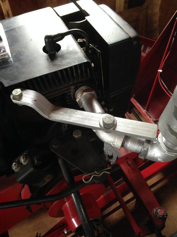

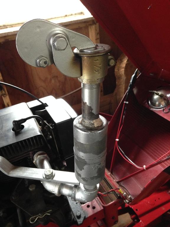

jeff lary 173 #12 Posted February 28, 2017 Tell me about your muffler, looks homemade did you build it? 1 Share this post Link to post Share on other sites
aHorseofCourse 261 #13 Posted February 28, 2017 3 hours ago, jeff lary said: Tell me about your muffler, looks homemade did you build it? Hi. Yes I made it. Just 3/4" pipe and one of those straight through mufflers you can get anywhere. It has the pipe thread on the one end. Actually sounds really good on the old Kohler. Oh and a tractor supply rain cap. I'll get some better pics of it 1 Share this post Link to post Share on other sites

PSully 61 #16 Posted March 1, 2017 I really like the wheel weight idea! 1 Share this post Link to post Share on other sites

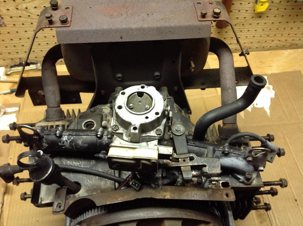

aHorseofCourse 261 #18 Posted March 2, 2017 Thanks for the kind words everyone. 10 hours ago, craftsmanmowerfreak said: i just got rid of my workhorse gt1642. when i got it had no engine. i put a 12hp kohler on it from a c-125. i will tell you this. if you plan on putting a 18hp briggs on it look for a belt guard off a workhorse gt1642 has they are different from what is on your machine now Very good info thank you for sharing. Pics of the exhaust. Kind of a slapped together setup but it works and sounds good. The pipe coming out of the muffler I just kind of jammed and cross threaded in the muffler then put some exhaust putty on. 1 Share this post Link to post Share on other sites

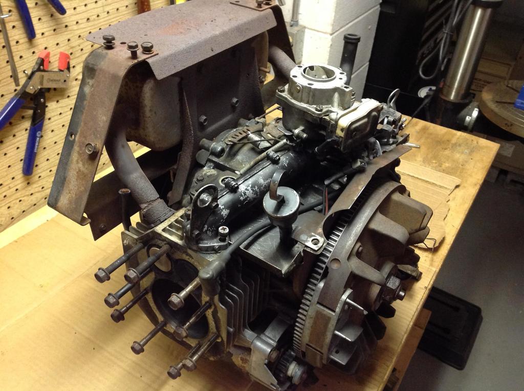

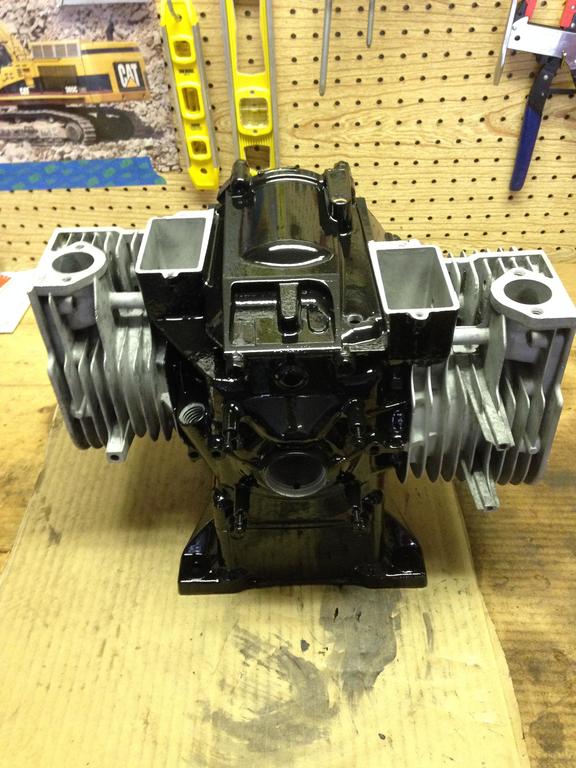

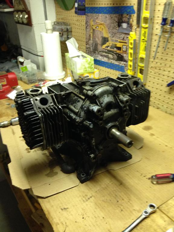

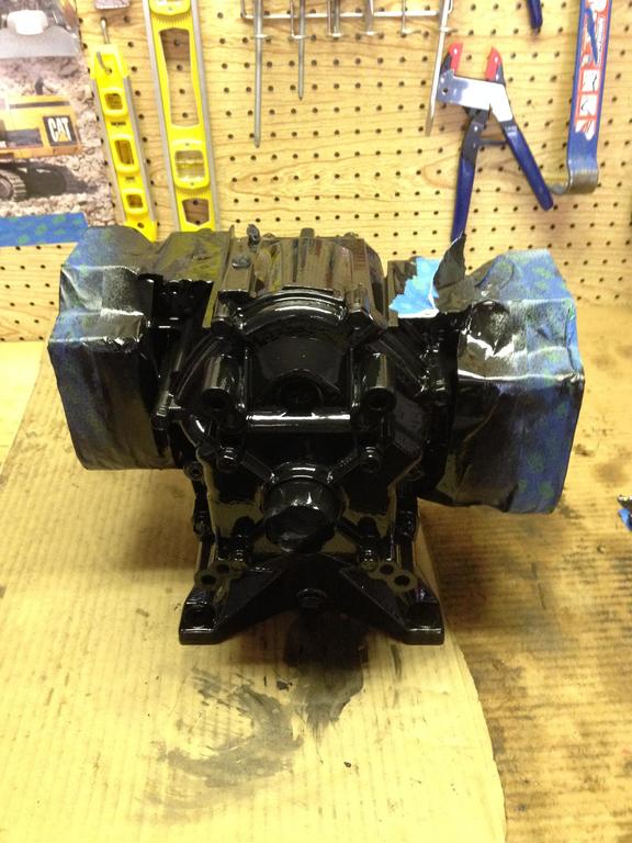

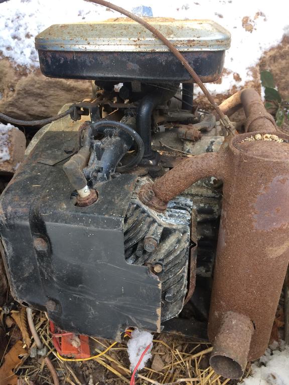

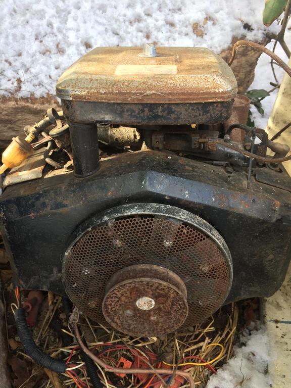

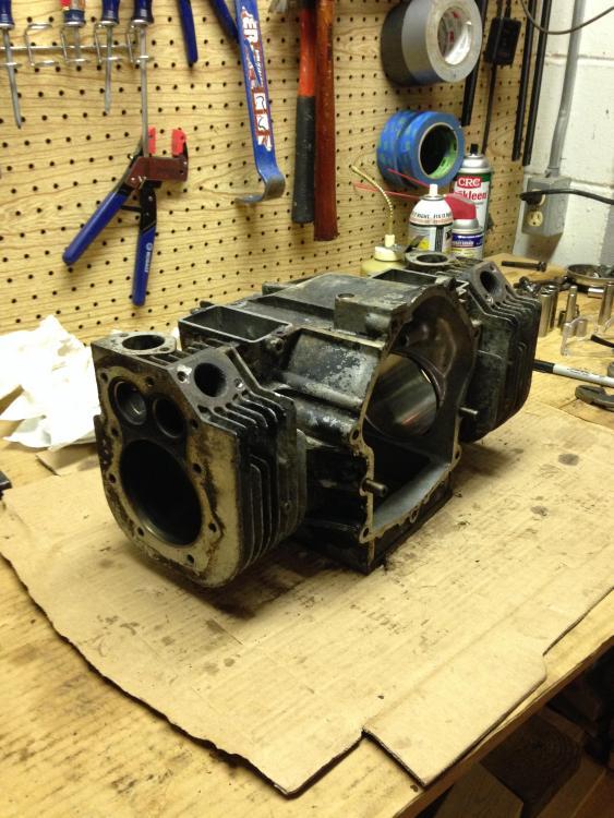

aHorseofCourse 261 #19 Posted March 2, 2017 Now on to the engine saga. This is the Briggs 18 opposed twin I got off eBay after some disassembly. It is just flat wore out. Cylinders are about .020 over already and a valve seat has come loose and ran like that for awhile. Governor is missing half the teeth and the timing pin was sheared off. There was a strange spring holding the throttle on the carb in place. I am willing to bet it ran in the condition it's in. Can't kill a Briggs! This is the block I'm rebuilding. Tins, carb, and oil pan are off the junk engine. This one sat for a few years so it had a lot more rust than the junk one. Much more to come! 2 Share this post Link to post Share on other sites
WVHillbilly520H 10,379 #20 Posted March 2, 2017 I don't know if those wheel weights are WH but I used a set of CUB ones on one of my 520s, Jeff. 2 Share this post Link to post Share on other sites
aHorseofCourse 261 #21 Posted March 4, 2017 On 3/2/2017 at 5:51 PM, WVHillbilly520H said: I don't know if those wheel weights are WH but I used a set of CUB ones on one of my 520s, Jeff. They fit perfect on there. I haven't tried to fit mine yet, just took the guys word they were on there. The more I look at mine the more I don't think they are wheel horse parts. 1 Share this post Link to post Share on other sites
mike416 14 #22 Posted March 4, 2017 On 3/1/2017 at 9:38 PM, aHorseofCourse said: Now on to the engine saga. This is the Briggs 18 opposed twin I got off eBay after some disassembly. It is just flat wore out. Cylinders are about .020 over already and a valve seat has come loose and ran like that for awhile. Governor is missing half the teeth and the timing pin was sheared off. There was a strange spring holding the throttle on the carb in place. I am willing to bet it ran in the condition it's in. Can't kill a Briggs! This is the block I'm rebuilding. Tins, carb, and oil pan are off the junk engine. This one sat for a few years so it had a lot more rust than the junk one. Much more to come! In a world of Kohler and Onan, it's really neat to see an opposed twin Briggs getting some deserved attention. Keep up the great work! 2 Share this post Link to post Share on other sites
aHorseofCourse 261 #23 Posted March 4, 2017 34 minutes ago, mike416 said: In a world of Kohler and Onan, it's really neat to see an opposed twin Briggs getting some deserved attention. Keep up the great work! Thanks so much! The Briggs is definitely an underdog in the wheel horse world. Got the engine tins, block, electric lift, and wheel weights painted this week. Might get the lift put on tomorrow. I am going to start a new topic in the engine section for the Briggs rebuild. It's just too much for one thread. 1 Share this post Link to post Share on other sites
