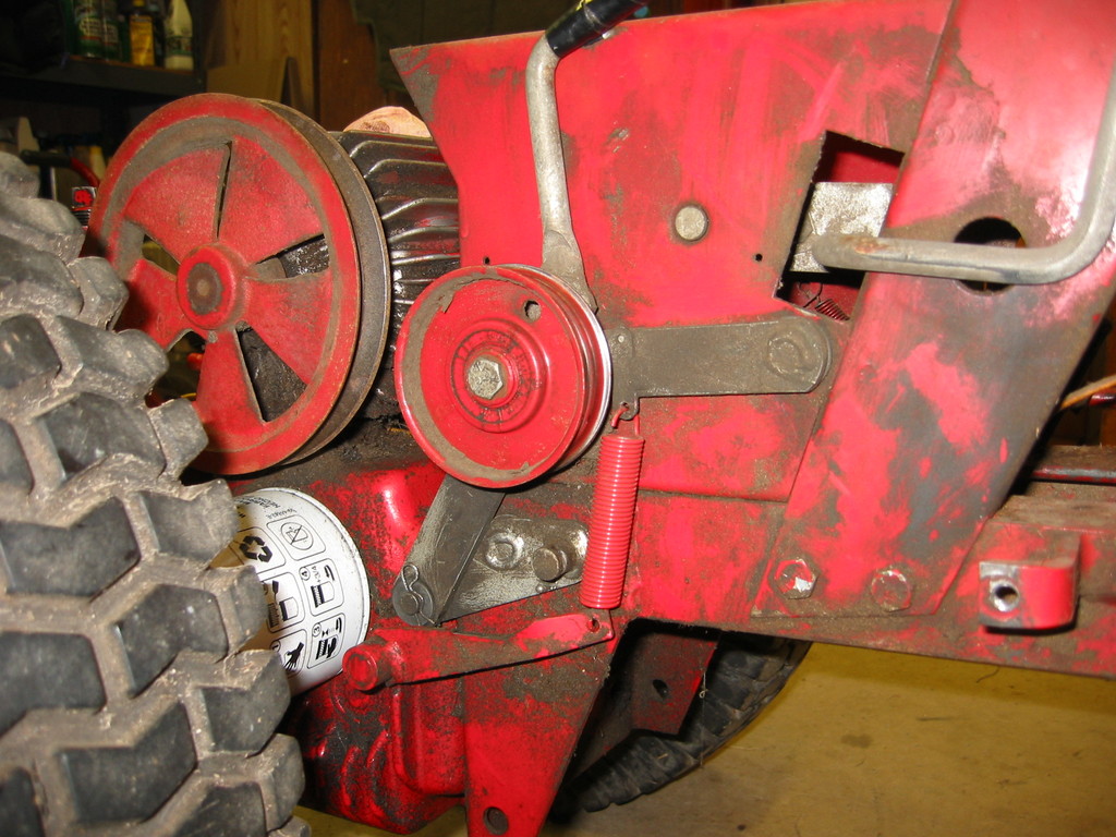

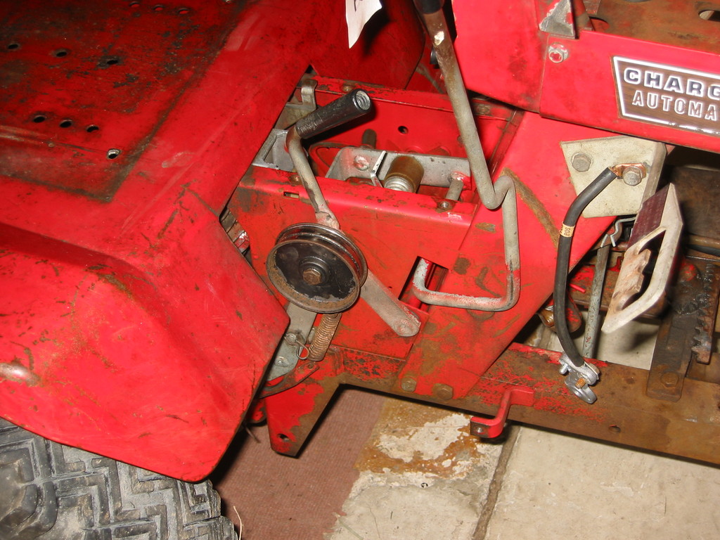

pfrederi 21,306 #10 Posted February 26, 2017 (edited) Did this just happen?? Check the spring (goes from the idler pulley linkage to the brake arm coming out of the tranny.)did it break /stretch?? When you push down on the brake lever you are helping the spring put tension on the belt when you release there may be slippage if the spring is bad. (Note the belt passes under the idler pulley) Edit Second picture give a better view of teh spring. That spring is all there is to apply tension to the drive belt Edited February 26, 2017 by pfrederi 1 Share this post Link to post Share on other sites
Schrumgmc 150 #11 Posted February 26, 2017 Thanks man. Just what I needed, where can I buy a spring? 1 Share this post Link to post Share on other sites
pfrederi 21,306 #12 Posted February 26, 2017 #6135 still from Toro about $8. the one in the second picture i just got from my dealer about 2 months ago 1 Share this post Link to post Share on other sites
