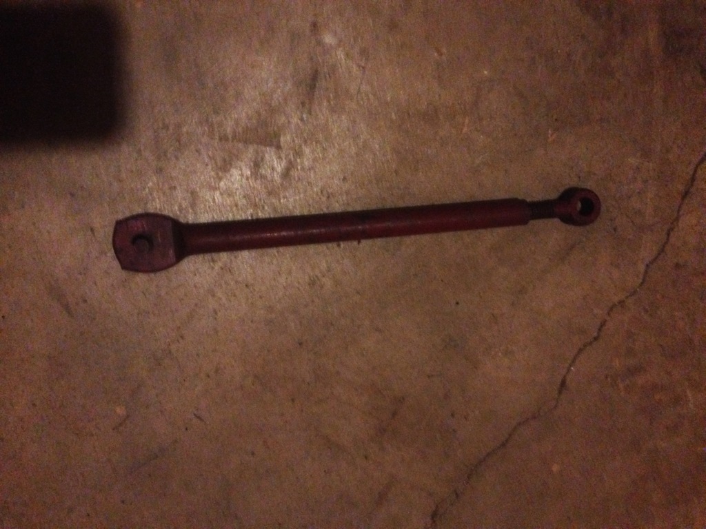

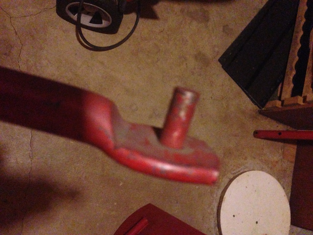

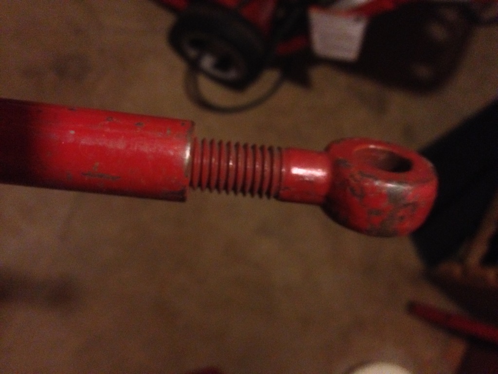

Lane Ranger 11,741 #4 Posted February 20, 2017 (edited) I am going to disagree with 953 nut on this one. The 953/1054 hydraulic pump and cylinder if properly operating should be able to lift the front end wheels of your tractor off the ground. The 953/1054 was one of the heaviest early Wheel Horse tractors but a good operating pump and lift cylinder on the tractor with proper amount of hydraulic fluid should eaily be able to lift the tractor off the ground while pushing the snowplow downward. The pressure in the system is above 300 lbs psi from everything I have read. The 953/1054 plow had a hard lift piece on it that allowed the pump to use its pressure in that way, Here are three pictures of a New Old Stock hard lift for the snowplow/dozer blade used on the 953/1054. Edited February 20, 2017 by Lane Ranger 5 Share this post Link to post Share on other sites

953 nut 63,841 #7 Posted February 20, 2017 5 hours ago, Lane Ranger said: disagree with 953 nut on this one. Feel free, just going on the systems on mine, none of which have been rebuilt. I know they have pressure in the downward direction but wasn't sure if it was that great. 5 hours ago, Lane Ranger said: The 953/1054 plow had a hard lift piece on it that allowed the pump to use its pressure in that way, never saw one of those before. I use a chain to connect the snow plow to the rocker shaft. I'll have to look for one of those thingies! 1 Share this post Link to post Share on other sites

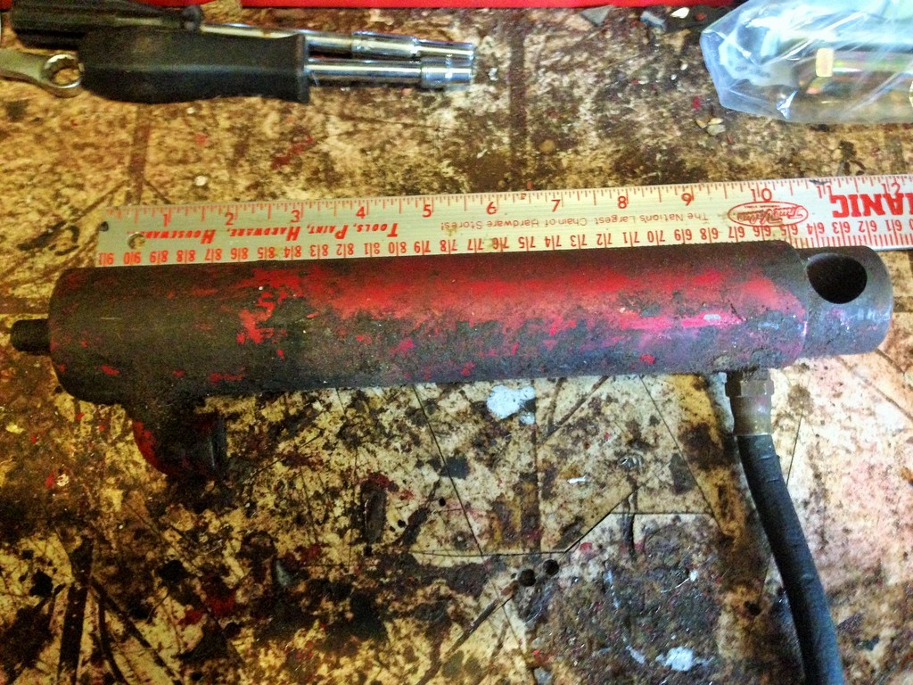

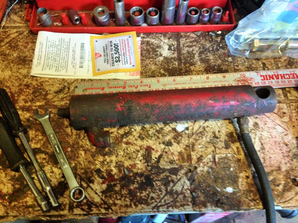

BOB ELLISON 2,983 #9 Posted February 22, 2017 @Lane Ranger are the lift cylinders rebuildable on the 1054 ? I looked at mine and I don't believe it is. Also I sat my pump on my work bench and the spool valve fell into the tank about 2 inches and now I think I'll have to open it up to get it back to top. I probably should open it any ways to clean it . inquiring minds want to know. 2 Share this post Link to post Share on other sites
Lane Ranger 11,741 #10 Posted February 24, 2017 Take it to a good reliable hydraulic shop. I have one that is sealed and has not yet been rebuilt but they tell it can be done and they reweld it. Some of the 953/1054 cylinders were screw-in types -not welded. Lowell S. (wheelhorseman1000 Vendor on Red Square) bought two from me last year at the Big Show in Gettysburg to rework. I am not sure what he learned by that process. I plan on having the one extra on my workbench redone at a hyraulics show that does a lot of industrail and mining hyraulic equipment repair. Bob: The big Snap ring must have come off your spool valve and I believe you can still get those. You can change the O ring and the shaft oil seal when you have yours apart. Look on Wheelhorseman1000 's Vendor website for his 1054/953 hydraulic parts. 2 Share this post Link to post Share on other sites
953 nut 63,841 #11 Posted February 24, 2017 The pump and cylinder on 953s are basically the same as the HY-2 and 3 and the manual for them is a lot clearer than what is in the 953 manual. The cylinder can be taken apart by unscrewing the pipe thread fittings at both ends. As Lane said, you can get repair parts from Lowell. http://www.wheelhorseman1000.com/product-p/hy-es.htm 3 Share this post Link to post Share on other sites
wheelhorseman 3,244 #12 Posted February 24, 2017 (edited) On 2/21/2017 at 6:46 PM, BOB ELLISON said: @Lane Ranger are the lift cylinders rebuildable on the 1054 ? I looked at mine and I don't believe it is. Also I sat my pump on my work bench and the spool valve fell into the tank about 2 inches and now I think I'll have to open it up to get it back to top. I probably should open it any ways to clean it . inquiring minds want to know. Yes it is I have done many! When I was reading this thread I realized that I did not have an ad for this on my store so here is a http://www.wheelhorseman1000.com/product-p/00010.htm Edited February 24, 2017 by wheelhorseman1000 2 Share this post Link to post Share on other sites
Lane Ranger 11,741 #13 Posted February 25, 2017 Well now that I see Lowell's ad -that is where I am sending my cylinder ! $57 is a bargain for a rebuilt one ! And we all know Lowell does great work ! We are very lucky to have someone of the caliber of expertise doing what he is doing ! 4 Share this post Link to post Share on other sites
