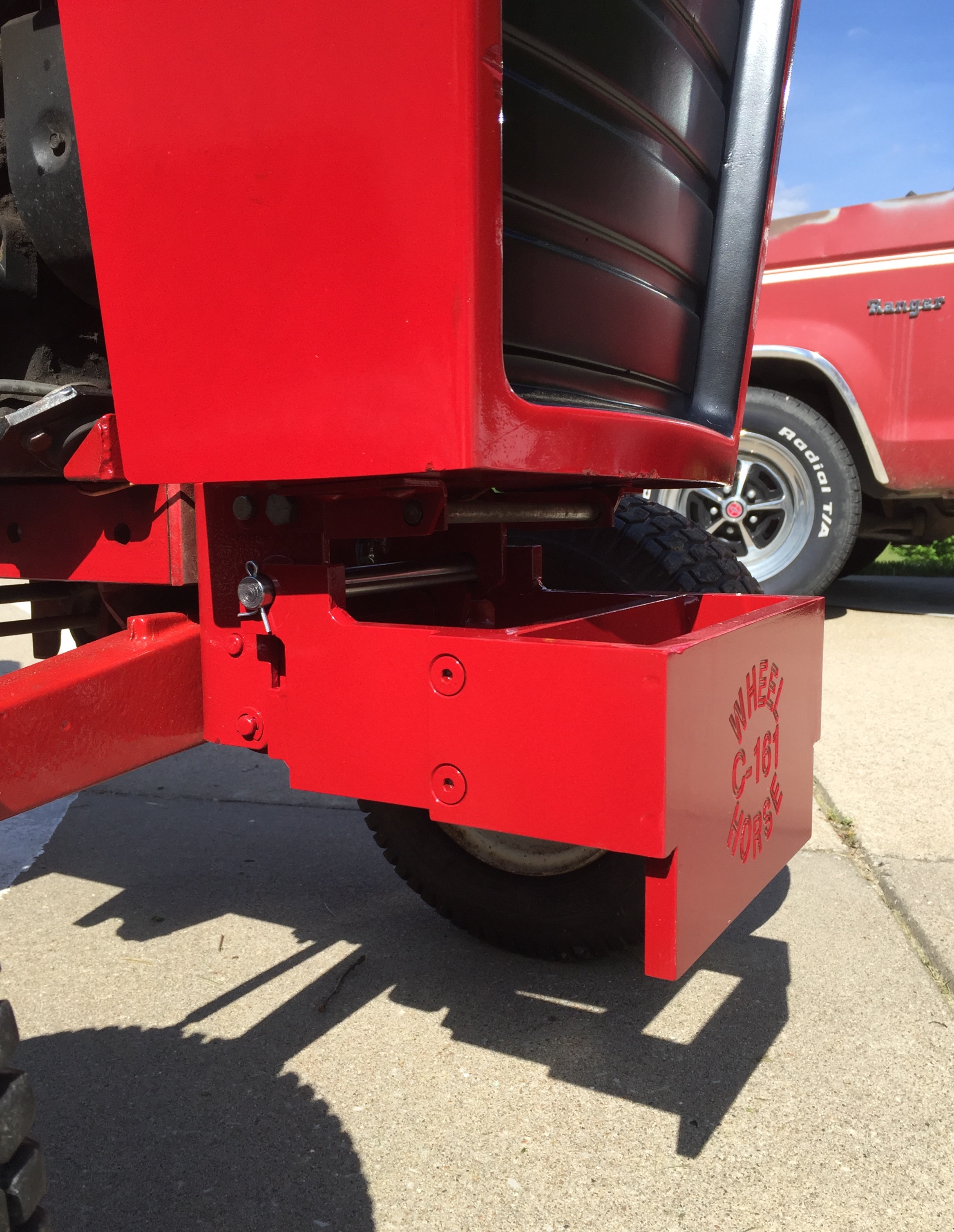

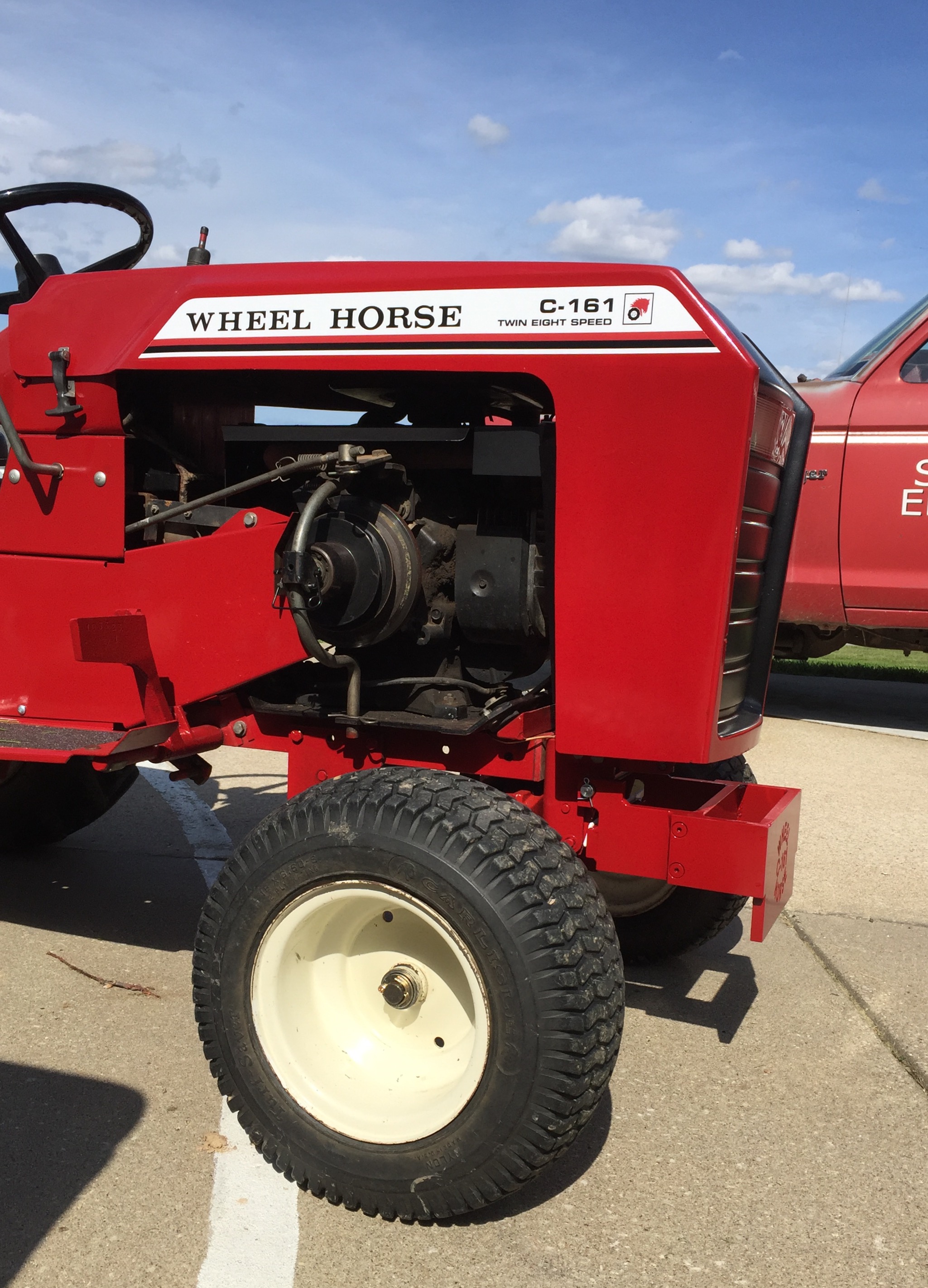

cschannuth 3,819 #11 Posted February 22, 2017 I used this on my dad's 78 C-161 for some touch up and it matched really well. It dries hard and fast. Premium Decor 12 OZ, Gloss Fiesta Red Enamel Spray Paint PDS96-AER i get it from True Value Hardware and its $3.59 per can. I've tried everything and this is the best I've found. In the images below the weight hanger was rattle canned with the Fiesta Red and it matches the hood pretty well. 3 Share this post Link to post Share on other sites
WHX?? 54,980 #12 Posted February 22, 2017 That weight hanger is awesome @cschannuth 3 Share this post Link to post Share on other sites
cschannuth 3,819 #13 Posted February 22, 2017 9 minutes ago, WHX9 said: That weight hanger is awesome @cschannuth Jeff (WVHillbilly520H) made that for me. I just prepped and painted it. Thanks! 2 Share this post Link to post Share on other sites

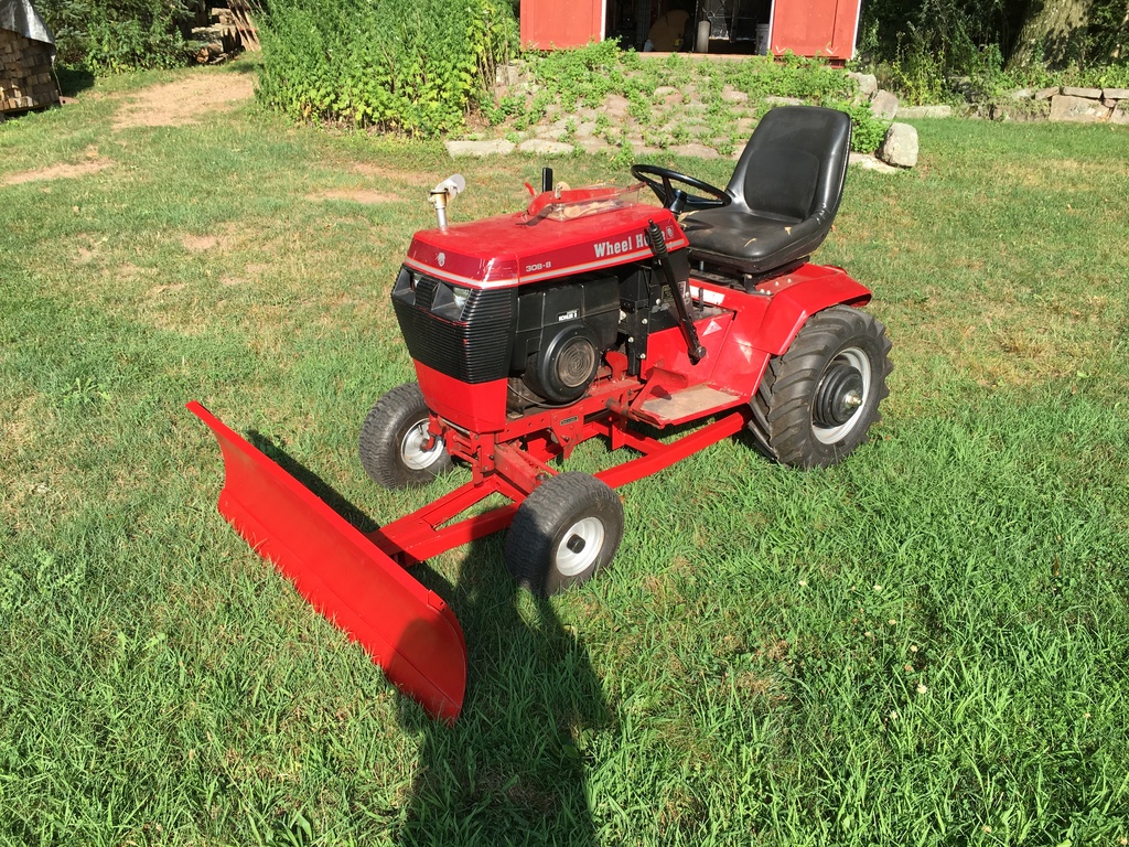

aHorseofCourse 261 #17 Posted February 27, 2017 Blade is painted with tractor supply and the tractor is factory 1 Share this post Link to post Share on other sites
tallen4392 71 #18 Posted February 27, 2017 is that ih tractor supply paint ?looks good I like those weights on rear .. What size are those rear tires looks good .. Share this post Link to post Share on other sites
