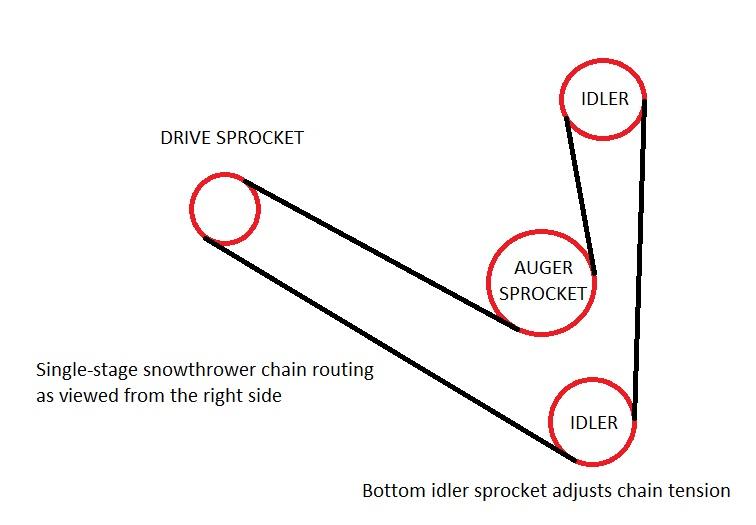

mocalessbrown 0 #45 Posted October 10, 2019 is there a diagram showing the routing of the chain on a 1997, 520H tractor, snow thrower model 79360 Share this post Link to post Share on other sites
gwest_ca-(File Mod) 12,494 #46 Posted October 21, 2019 On 10/10/2019 at 7:03 AM, mocalessbrown said: is there a diagram showing the routing of the chain on a 1997, 520H tractor, snow thrower model 79360 Yes there is but can't find them now. Here is another. Garry Share this post Link to post Share on other sites
