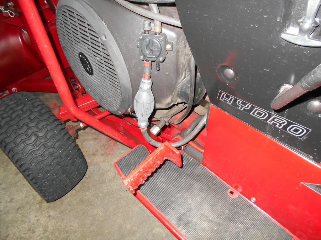

520 man 6 #1 Posted February 12, 2017 Tractor had been sitting for a month or so and would have cranked a long time before starting. With the primer, I pumped it until it felt hard then just touched the key to start and the machine roared to life. This is the test machine. If it works properly then I will install one on all of my 520's. Fuel line is long in this picture. If primer is to be permanent I will properly shorten the line. Cleat 6 Share this post Link to post Share on other sites

Jerry77 1,218 #4 Posted February 12, 2017 I put one on my 314-8 before I gave it to my son -- huge difference -- should have done it years ago - got mine thru a marine supply - seems watercraft use these extensively...one caveat - make sure it is installed vertically so the built in check valve works..on a horizontal plane it will drain back to the tank.... 1 Share this post Link to post Share on other sites

Texas Todd 1,026 #8 Posted February 12, 2017 I gave that a whirl on my 312-8, but couldn't keep the fuel filter full once it was running. May have got a bad one and it was sucking air and losing prime. May give it another go with a new one. Share this post Link to post Share on other sites

Stormin 9,988 #13 Posted February 12, 2017 6 hours ago, Jerry77 said: make sure it is installed vertically so the built in check valve works..on a horizontal plane it will drain back to the tank.... The one on the C-121 is vertical just before the pump. The C-125 one is horizontal above the transmission. There's a square hole under the seat and I can get at it that way. Three squeezes are all that's required, even if not run for a few weeks. Share this post Link to post Share on other sites
Jerry77 1,218 #14 Posted February 12, 2017 3 hours ago, squonk said: Any marina Any marina should do - there is a lot of difference in quality between brands, but the marinas stock the good stuff. gonna cost you around 20-25 bucks.... 4 hours ago, Texas Todd said: couldn't keep the fuel filter full That sounds like weak fuel pump... Share this post Link to post Share on other sites
Texas Todd 1,026 #15 Posted February 12, 2017 20 minutes ago, Jerry77 said: That sounds like weak fuel pump... Nope. Took the primer bulb off and stays full fine now. 1 Share this post Link to post Share on other sites

cleat 8,986 #17 Posted February 17, 2017 When I blow through the primer bulb there does seem to be a fair bit of resistance. Pump seems to pull fuel through although I have not used the tractor, just ran it in the garage (with exhaust fans running). That is why it is hooked up temporary, so I can put it back to original if the primer idea does not work out. We got a big dump of snow a few days ago but I used the big tractor and cab to clear that. I started this thread at work where for some reason I can't log into my main account. Share this post Link to post Share on other sites
