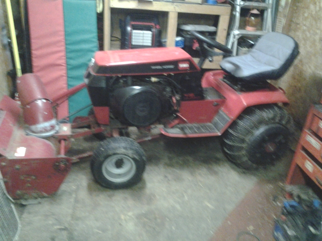

Cee245 853 #1 Posted February 12, 2017 Hey all, I have a 97 416h with 800hrs. I've had it for about 7 years. I haven't had too much trouble with it.... I did a mostly cosmetic re-store of the tractor, painted the metal, re did a couple electrical connections, coil, plugs ect.That was a few years ago... Last summer it would run for an intermittent amount of time. It would run excellent 5-15 min and shut down on a hot day >80 and ran longer on a <60 degree day but would still just lose all power at once... I wait an hour and it started right up and ran great for a short time and shut down again . BUT, once winter came, It runs perfectly. I've used it about 10 times this winter for about and hour each time and it's started and run as expected. I know of a couple things to check but I haven't dealt with this before. Any suggestions are are appreciated. 1 Share this post Link to post Share on other sites

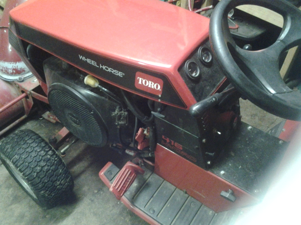

Cee245 853 #12 Posted February 13, 2017 The fuses all look good. I had my Dad redo that part of the wiring. The fuses are all sealed individually in a rubber holder. I'm not strong at electrical stuff. (He fixed my wiring and I rebuilt his 416-8 transmission) I now have that tractor. I made out on that deal! Lol This pic shows where the fuses are now. Look below the fuel pump and a little right. They are in those red little boot things. 1 Share this post Link to post Share on other sites
