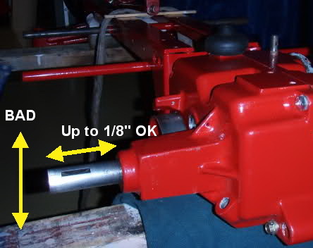

953 nut 67,646 #3 Posted February 11, 2017 Be sure the axles have no up/down or side to side movement, this would indicate bad bearings. Take a look at this thread, it should be helpful. 1 1/8" seal is SKF 11050 1" seal is SKF 7410 These are common industrial supply seals and can be bought at Grainger or NAPA. of that 1977 B-100. Share this post Link to post Share on other sites
rmaynard 17,458 #4 Posted February 11, 2017 3 hours ago, 953 nut said: Be sure the axles have no up/down or side to side movement, this would indicate bad bearings... Just to elaborate: 1 Share this post Link to post Share on other sites
