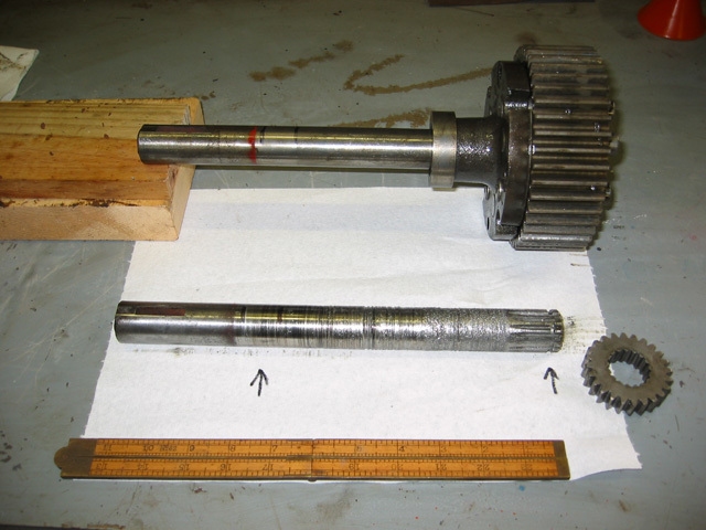

Rustyred 63 #1 Posted February 10, 2017 Hi guys, My transmission is cleaned up and ready for assembly! The gasket of course will be new. I have put out the question of whether my gear damage warrants a replacement in another thread. Two questions: 1. Are there any parts to a transmission that should be replaced every time it is taken apart? This thing is from 1979 - probably never taken apart before. 2. One axle needle bearing had fallen apart and I will replace it. The other one is fine. Would you replace it anyway? Or was the other just faulty? Thanks again for the advice! Share this post Link to post Share on other sites
pfrederi 20,680 #2 Posted February 10, 2017 For about $6.00 (my bearing guys price not Toro they are common bearings) I would replace the other needle bearing Needle bearing failure is not a good thing. This is what happens when an axle needle bearing fails All the seals , Input, Brake and axles should be replaced again they are readily available from bearing houses and cheap. 5 Share this post Link to post Share on other sites
Rustyred 63 #3 Posted February 12, 2017 I appreciate the response - the picture was helpful and I can say I got lucky - the bearing was shot and the axle was not yet damaged. 1 Share this post Link to post Share on other sites
