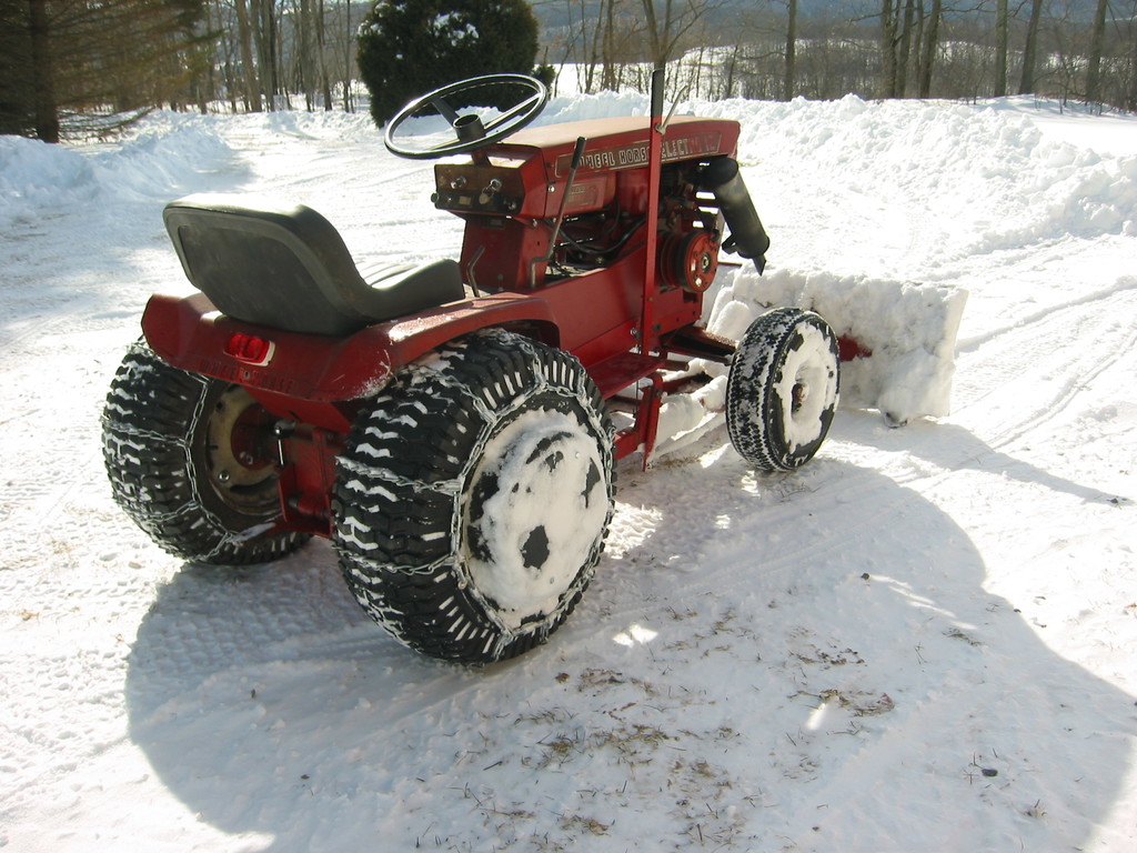

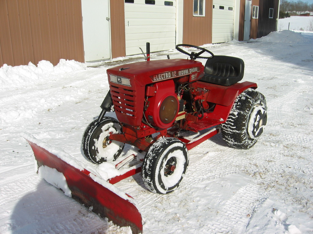

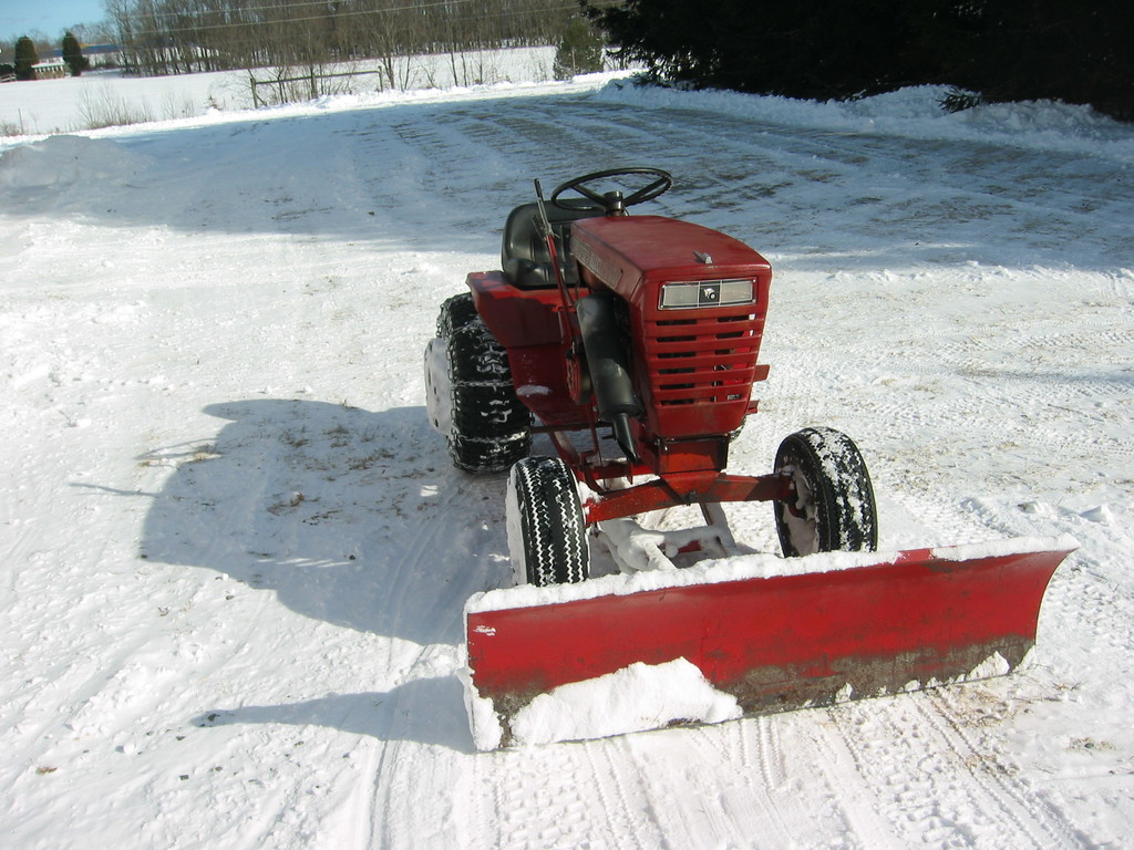

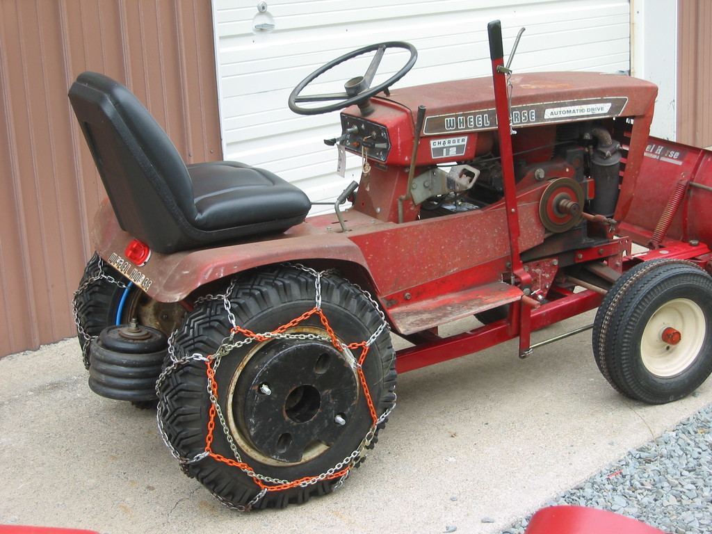

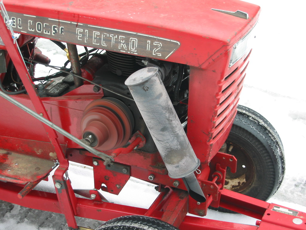

pfrederi 19,930 #1 Posted February 10, 2017 I have had roller chain on my primary plow horse for some time. Been pleased but never had the opportunity for an almost direct comparison. Used the primary, Charger 12 yesterday. Took out the backup plow tractor Electro 12 today...what a difference!!!. I knew the back up wouldn't push quite as well as she has regular garden tractor chains on fat turf tires and not as much weight. She did OK pushing but the front end slid sideways way too much as she doesn't have roller chains on the front. I have to see if i have enough in stock and as soon as the snow melts off her she is getting #40 chain. First pic is primary girl...last 3 backup. 13 Share this post Link to post Share on other sites

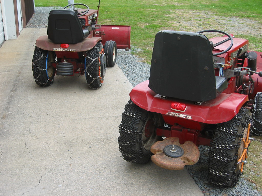

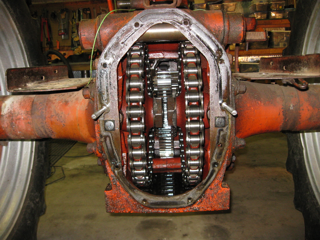

pfrederi 19,930 #6 Posted February 10, 2017 Sorry the best I have right now. Cocktail hour You asked about other chains...I was wondering if anyone had gone bigger than #40. Maybe like the chain drive in my big tractor (Case DC3) 4 Share this post Link to post Share on other sites

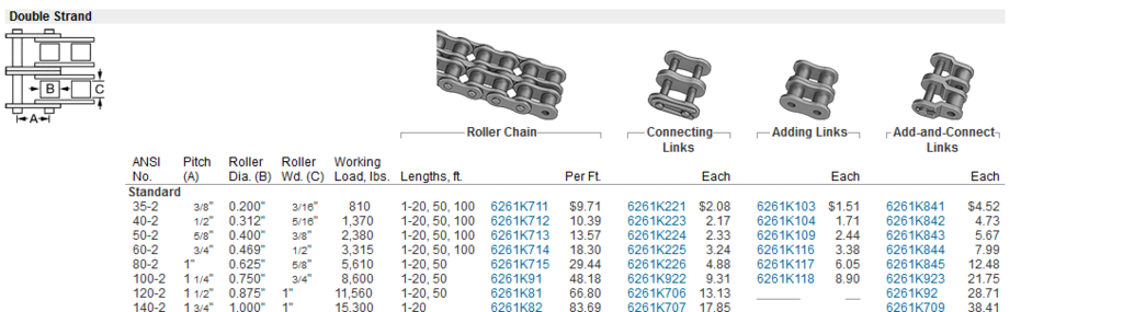

pfrederi 19,930 #10 Posted February 10, 2017 Anyone looked at double chain to reduce any tendency to "roll over" 2 Share this post Link to post Share on other sites

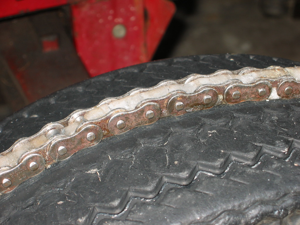

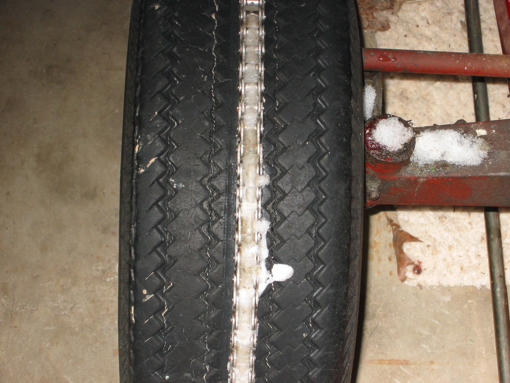

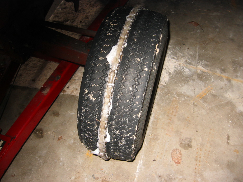

pfrederi 19,930 #18 Posted February 11, 2017 Here are mine on the older narrower front tires. 3 Share this post Link to post Share on other sites
oldlineman 1,654 #19 Posted February 11, 2017 I left all the air out and made the chain as short as possible and then aired the tires up. You have to keep the air up or they will come off. Sure helps its like the front is glued to the ground. 5 Share this post Link to post Share on other sites
DennisThornton 4,773 #20 Posted February 11, 2017 4 hours ago, oldlineman said: I will get a picture tomorrow of mine if I can Dennis. I didn't plow this last snow storm mostly because it will get to 45 and 50 next two days and also the yard is not frozen and I have a hard time getting back to the shed , diggs up sod. Bob I wanted to see how much they "cut into" the bulge of the tread. Thank you! Share this post Link to post Share on other sites
