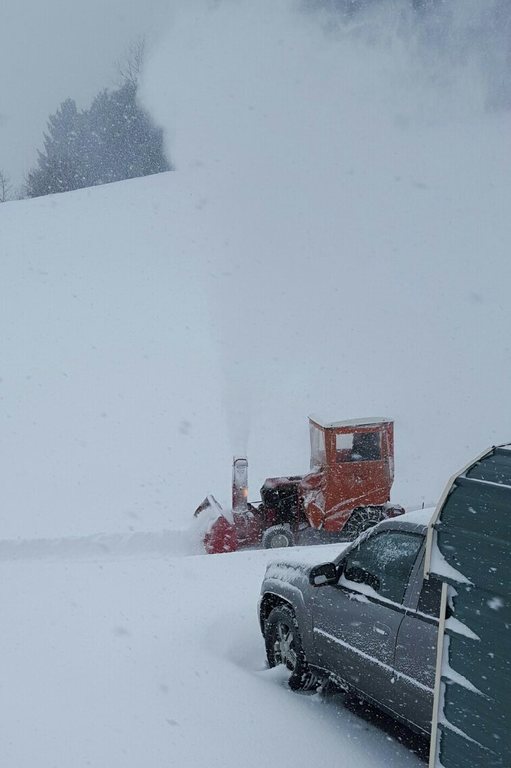

Kurt-NEPA 756 #32 Posted February 9, 2017 We finally got a little snow in NE Pennsylvania. About 7 inches. I got a little seat time. 5 Share this post Link to post Share on other sites
WVHillbilly520H 10,379 #33 Posted February 9, 2017 Gotta love the 2stage and cab with the Onan singing it sweet music, Jeff. 13 minutes ago, Kurt-NEPA said: We finally got a little snow in NE Pennsylvania. About 7 inches. I got a little seat time. 1 Share this post Link to post Share on other sites
Kurt-NEPA 756 #34 Posted February 9, 2017 (edited) 21 minutes ago, WVHillbilly520H said: Gotta love the 2stage and cab with the Onan singing it sweet music, Jeff. It sure is sweet music Jess. Best set up I've ever had. The 20HP Onan and 2 Stage was handling 20" drifts with ease and throwing the snow onto my neighbors lawn. I love it. Edited February 9, 2017 by Kurt-NEPA 2 Share this post Link to post Share on other sites

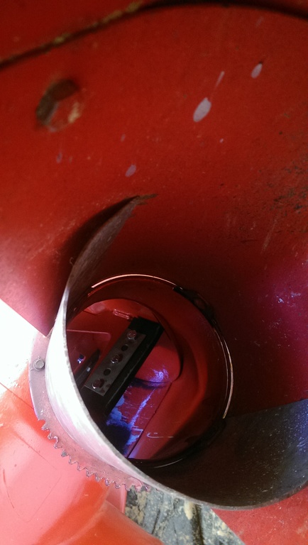

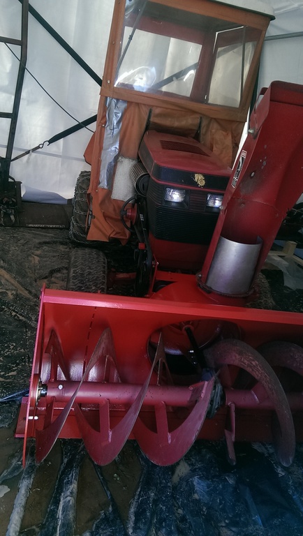

WVHillbilly520H 10,379 #37 Posted February 9, 2017 6 minutes ago, Kurt-NEPA said: You are so right Jeff. I have a single stage on my 88 520H, it does a fine job. But my two stage is fantastic. And once you have a cab, you'll never go back. BTW, I put paddle extensions on the impeller on my two stage. I highly recommend them. It went from shooting snow 30ft to sending off as much as 100 ft. Yes, did that to the one I got and rebuilt the fall of 2015 that I run on my bought new anniversary 520, plus greaseable lock collar bearings and solid stone deflector in the bottom section of the chute,here's the pic from last Feb here in VA, Jeff. 3 Share this post Link to post Share on other sites
WHX?? 58,308 #38 Posted February 9, 2017 Here I sit broken hearted paid a nickel only far.....all it did was get cold here...I WANNA MOVE SNOW Wait till I do Jeff's upgrades and get my deuce rockin....... prolly only get dustings then 1 Share this post Link to post Share on other sites

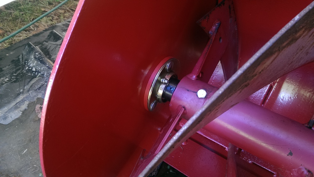

Kurt-NEPA 756 #39 Posted February 9, 2017 2 minutes ago, WVHillbilly520H said: Yes, did that to the one I got and rebuilt the fall of 2015 that I run on my bought new anniversary 520, plus greaseable lock collar bearings and solid stone deflector in the bottom section of the chute,here's the pic from last Feb here in VA, Jeff. I did the cam lock greaseable bearings on the auger shaft too. Highly recommended. I also added a center brace from the frame down to the auger gear box. It really cut down on vibrations. I'll have to try that solid stone deflector, it might keep the snow going up the shoot better. My driveway is paved, so no stone worrys there. Also, I am running rubber chains. So far I really like them. But I have yet to try then on ice. 1 minute ago, WHX9 said: Here I sit broken hearted paid a nickel only far.....all it did was get cold here...I WANNA MOVE SNOW Wait till I do Jeff's upgrades and get my deuce rockin....... prolly only get dustings then I did my 2 stage rebuild in 2015. I took almost two years for us to get some decent snow. I've been really bummed. Share this post Link to post Share on other sites

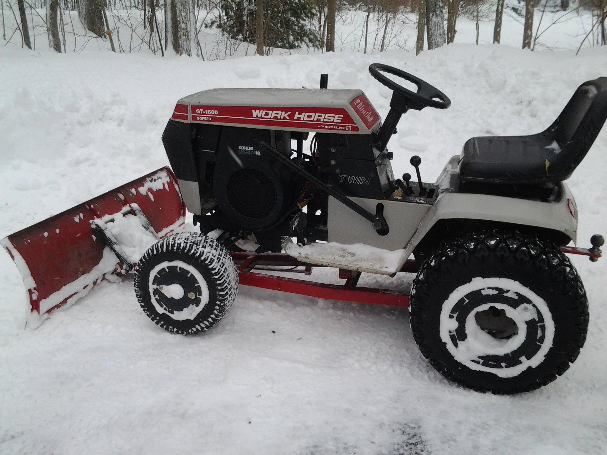

Sparky-(Admin) 26,563 #40 Posted February 9, 2017 I was home alone so no action shots...but my Ariens walk behind and my "mutt" GT-1600 handled it just fine. Mike.... 3 Share this post Link to post Share on other sites

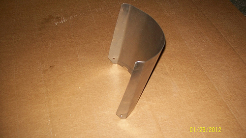

WVHillbilly520H 10,379 #41 Posted February 9, 2017 (edited) 16 minutes ago, Kurt-NEPA said: I did the cam lock greaseable bearings on the auger shaft too. Highly recommended. I also added a center brace from the frame down to the auger gear box. It really cut down on vibrations. I'll have to try that solid stone deflector, it might keep the snow going up the shoot better. My driveway is paved, so no stone worrys there. Also, I am running rubber chains. So far I really like them. But I have yet to try then on ice. I did my 2 stage rebuild in 2015. I took almost two years for us to get some decent snow. I've been really bummed. I'd like to see a picture of that frame gearbox brace, had the solid deflector on the single it really does help "shoot" the snow up and out the chute, Toro actually offered it on the '97 and later models through the Xi's and still shows available on Partstree. Edited February 9, 2017 by WVHillbilly520H Share this post Link to post Share on other sites
WHX?? 58,308 #42 Posted February 9, 2017 9 minutes ago, Kurt-NEPA said: I've been really bummed. Thanks for the encouragement 1 minute ago, WVHillbilly520H said: I'd like to see a picture of that frame gearbox brace When I get ready to tie into mine this summer you guys are gonna be first to get the call! 2 Share this post Link to post Share on other sites
Kurt-NEPA 756 #43 Posted February 9, 2017 (edited) 8 minutes ago, WVHillbilly520H said: I'd like to see a picture of that frame gearbox brace, had the solid deflector on the single it really does help "shoot" the snow up and out the chute, Too actually offered it on the '97 and later models through the Xi's and still shows available on Partstree. Pic of my frame to auger gear box brace. I'll have to check out that solid deflector. Looks like I could fab one up. 6 minutes ago, WHX9 said: Thanks for the encouragement When I get ready to tie into mine this summer you guys are gonna be first to get the call! It always seem to work this way. If I delay mounting my blowers and cab, then we get dumped on and I'm out in the shop working in 20 degree weather. Such is life. When you are ready for the rebuild ask away. This is a really rewarding project. Edited February 9, 2017 by Kurt-NEPA 2 Share this post Link to post Share on other sites
WVHillbilly520H 10,379 #44 Posted February 9, 2017 Thanks for the brace pic ,looks like something extra to fab up this summer, and I made my deflector myself from a post here on RS on a single stage, Jeff. 1 Share this post Link to post Share on other sites
WHX?? 58,308 #45 Posted February 9, 2017 15 minutes ago, Kurt-NEPA said: When you are ready for the rebuild ask away. This is a really rewarding project. Thanks Kurt that looks easy enough to make even for my limited fab skills! Does that sub plate mount to the bolts that hold the gear box halves together? Is the stone deflector that piece of pipe in the chute? As shown in Jeff's pics? Share this post Link to post Share on other sites
Kurt-NEPA 756 #46 Posted February 9, 2017 13 minutes ago, WHX9 said: Does that sub plate mount to the bolts that hold the gear box halves together? Yes, that is what I did. 1 Share this post Link to post Share on other sites

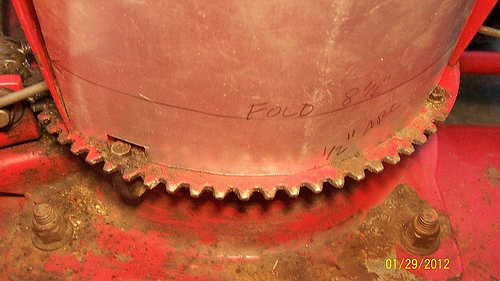

WVHillbilly520H 10,379 #47 Posted February 9, 2017 9 minutes ago, WHX9 said: Thanks Kurt that looks easy enough to make even for my limited fab skills! Does that sub plate mount to the bolts that hold the gear box halves together? Is the stone deflector that piece of pipe in the chute? As shown in Jeff's pics? Jim ,yes the silver pipe is the stone deflector, I made mine from 6" diameter exhaust tubing .080" wall thickness (probably overkill) but it can be bought already made from Toro, Jeff. 2 Share this post Link to post Share on other sites
