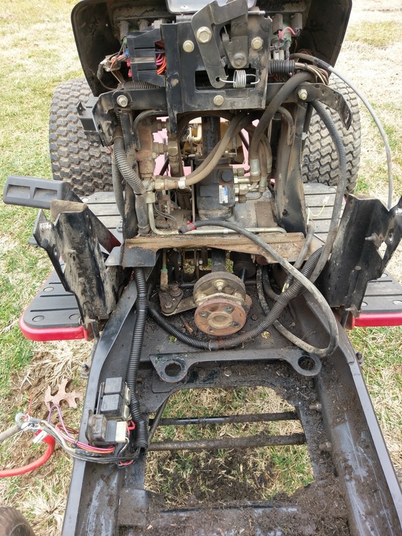

maxiblue 352 #16 Posted February 13, 2017 As far as the D-250 there is no problem getting parts for the engine, fuel pumps, starters, water pumps, generators, and distributor any thing else are easy to get. If you have a problem getting parts I would be happy help any one. That Renault 845cc engine has been around from 1962 thru 199? . Yes the tractor is some what larger and is metric and not interchangeable with other wheel horse tractors. only disappointing is the steering its not power, but will modify that this year. 1 Share this post Link to post Share on other sites
WVHillbilly520H 10,378 #17 Posted February 13, 2017 6 hours ago, maxiblue said: As far as the D-250 only disappointing is the steering its not power, but will modify that this year. Wonder if the tilt column with hydraulic unit from the xi series would work for you? I can get you a better pic of you think that might be something of father interest? Jeff. 1 Share this post Link to post Share on other sites
maxiblue 352 #18 Posted February 14, 2017 (edited) HI thanks for the idea, I have an electronic power steering unit out of a 2002 Saturn very compact no pumps or hoses. Will take picture and add it tomorrow . this is electric power steering unit Edited February 15, 2017 by maxiblue 1 Share this post Link to post Share on other sites
