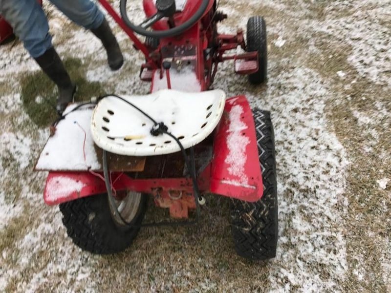

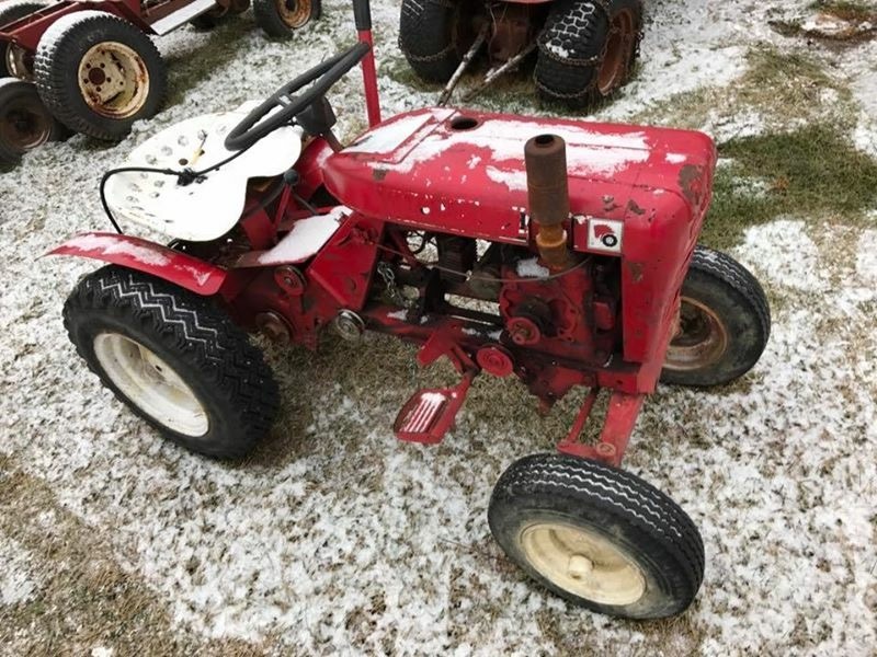

Ashton1118 20 #1 Posted February 6, 2017 I bought this wheel horse 704 for $250. I have plans to restore it back to original the closest I can. Was it a good buy and what would it be worth after I get done restoring it? 7 Share this post Link to post Share on other sites

Shynon 7,728 #3 Posted February 6, 2017 704 would be a pullstart k161, looks like it has a k181 electric start on it. Also incorrect steering wheel, Looks like a good buy and Share this post Link to post Share on other sites

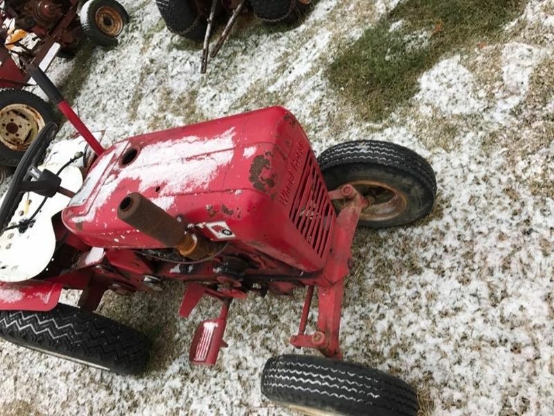

Sparky-(Admin) 26,691 #5 Posted February 6, 2017 Impossible to give a restored value without seeing the finished product. Everyone's definition of restored is different. You do have the wrong motor, wrong steering wheel and the hood is cut. Looks like you have an extra idler pulley for some reason. A full honest to goodness nuts and bolts restore generally costs more that what you can sell them for in my opinion. Mike..... 5 Share this post Link to post Share on other sites

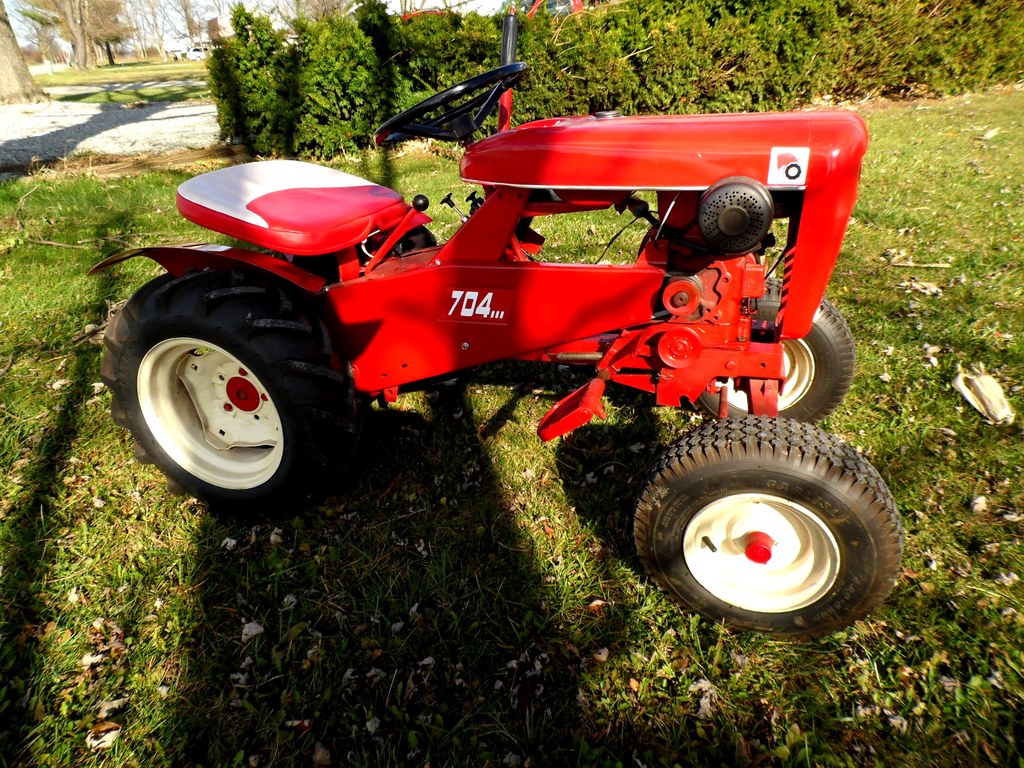

Shynon 7,728 #6 Posted February 6, 2017 Here's a little inspiration. Just now, Sparky said: A full honest to goodness nuts and bolts restore generally costs more that what you can sell them for in my opinion 10 Share this post Link to post Share on other sites

Ashton1118 20 #8 Posted February 6, 2017 It has a k161 with the electric start I'm not sure how to get it back to pull start and thank you guys for the warm welcome. Share this post Link to post Share on other sites
AMC RULES 37,260 #9 Posted February 6, 2017 Easy enough to do... pull the flywheel screen... install a starter cup, and recoil/pull starter in it's place. Share this post Link to post Share on other sites

Shynon 7,728 #12 Posted February 6, 2017 14 minutes ago, AMC RULES said: Easy enough to do... pull the flywheel screen... install a starter cup, and recoil/pull starter in it's place. Also change the flywheel (has ring gear on it) and shroud to accept the pull start Share this post Link to post Share on other sites

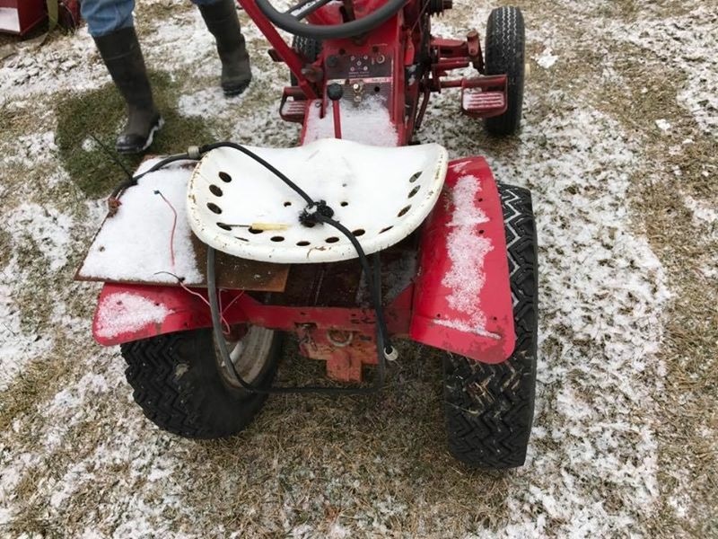

squonk 48,334 #14 Posted February 6, 2017 Seat is wrong too. Should be square. Share this post Link to post Share on other sites

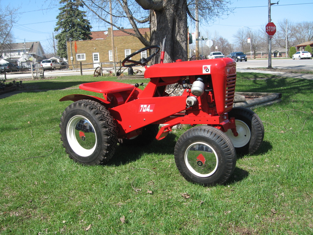

Molon_Labe 731 #19 Posted February 6, 2017 Looks like a nice start for a custom project. There is no way I could ever break even on any of my restoral projects. Here's one I went through a few years ago that turned into a real money pit once everything was said and done but in the end it was worth it to me. The 704 is one of my favorite tractors for just puttin' around on. You'll love yours. 1 Share this post Link to post Share on other sites
