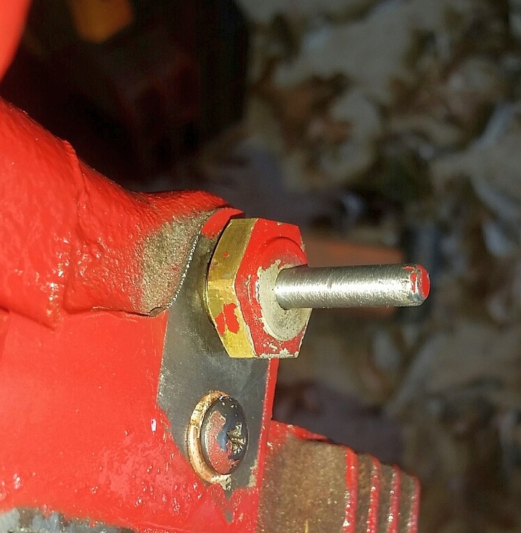

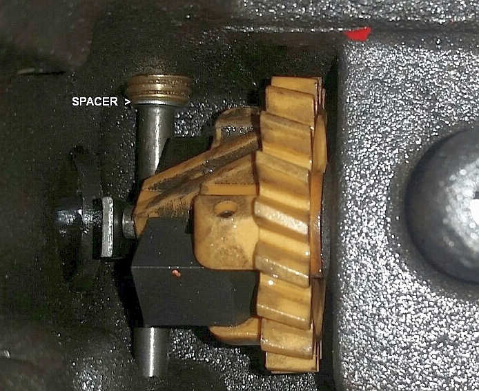

Texas Todd 1,026 #1 Posted February 5, 2017 I think I have this right, but want to make sure before I put the cam in. On the governor bar. Does the spacer go against the swelled part and ride on it and the brass plug? The reason I ask is when I tighten down the brass plug the rod won't rotate back and forth. Anything over finger tight and the flag doesn't want to flop back and forth. Thanks! 1 Share this post Link to post Share on other sites
Shynon 7,604 #2 Posted February 6, 2017 Yes you have it correct, but you do not have the cable arm or the speed control disc behind the brass nut. That is why it is not turning. 2 Share this post Link to post Share on other sites
Texas Todd 1,026 #3 Posted February 6, 2017 Aha!! Bingo! That makes perfect sense. Thanks!! 1 Share this post Link to post Share on other sites
