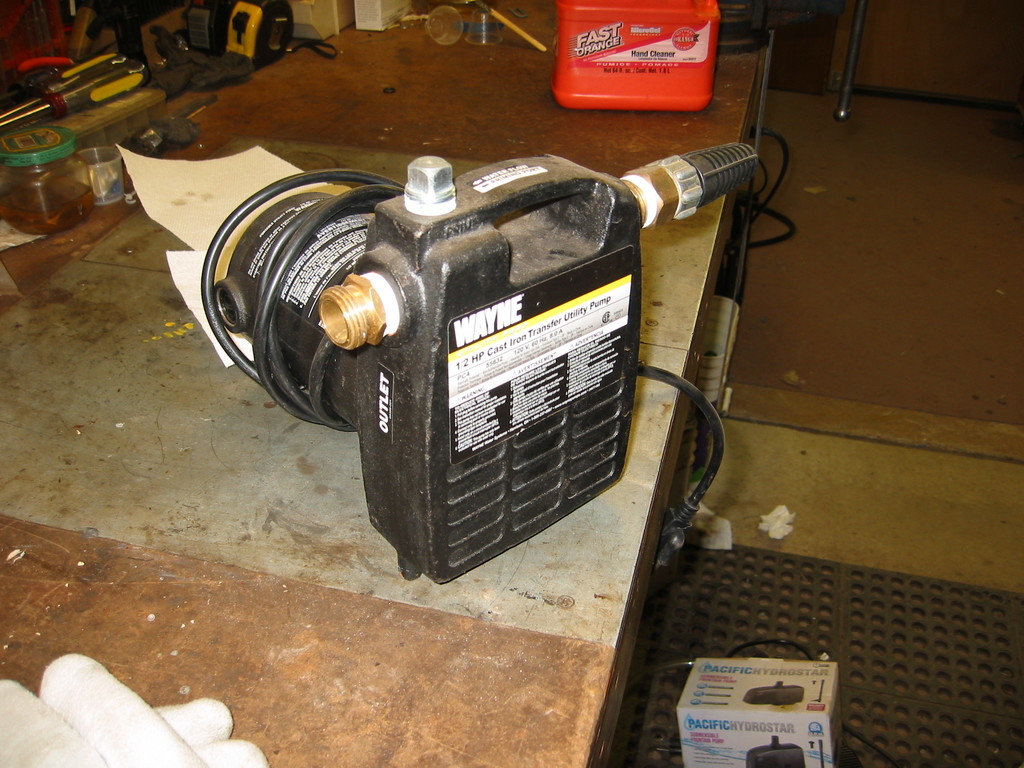

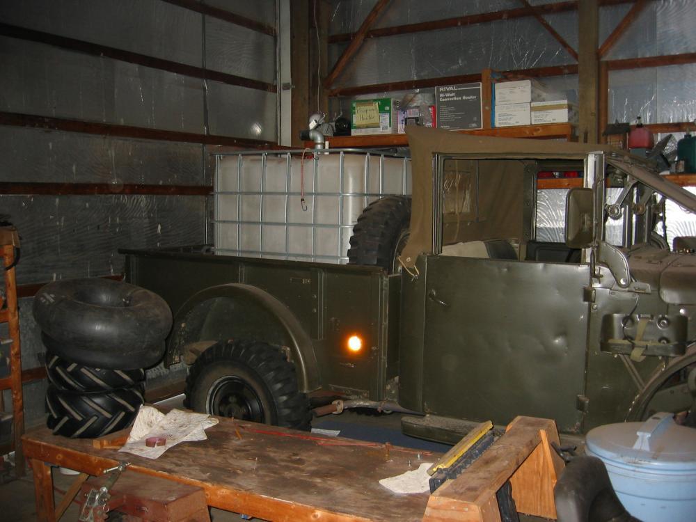

pfrederi 21,214 #2 Posted February 4, 2017 (edited) I doubt you will find a battery powered pump that will generate the pressure and volume you want to feed two sprinkler towers. I use a 1000liter handitank in the back of my M37. I fill it down at the pond using a 3.5hp 2 inch pump. (incidentally it will not run for "hours" on a tank of gas). Haul it up to the house then hook up the wayne electric pump and it pushes water through a 1 inch hose at sufficient pressure volume t0 run two sprinklers. Empties the 1000 liters (about 275 gal) in about 16 minutes https://www.waynepumps.com/product/pc4/ Edited February 4, 2017 by pfrederi 6 Share this post Link to post Share on other sites

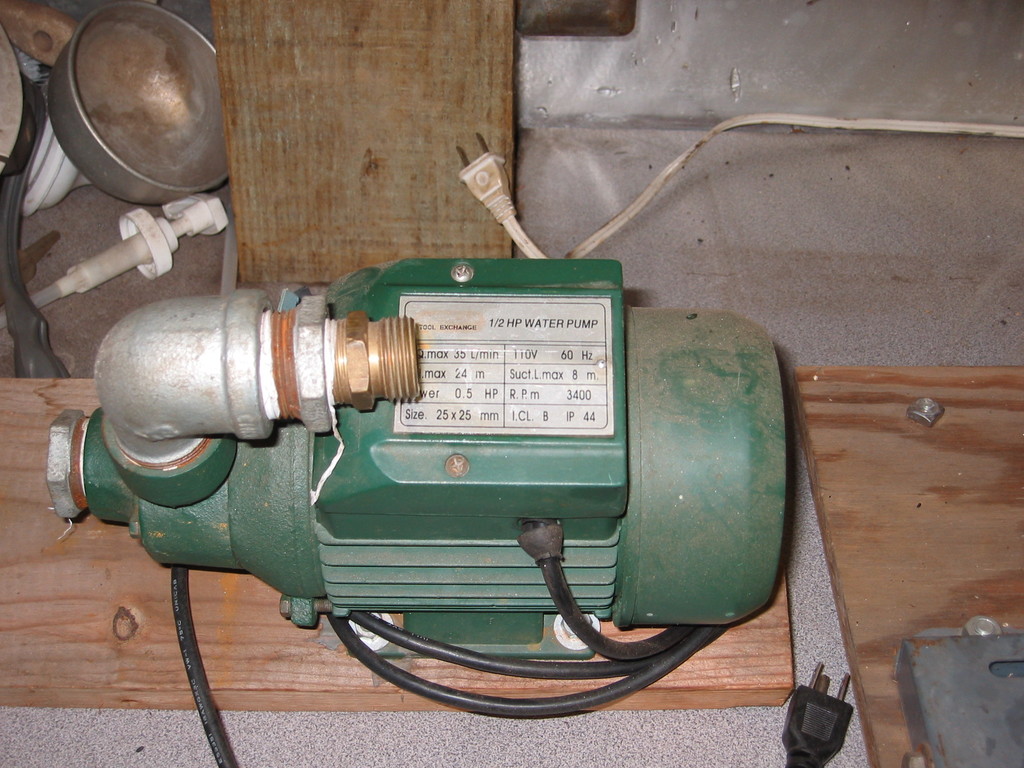

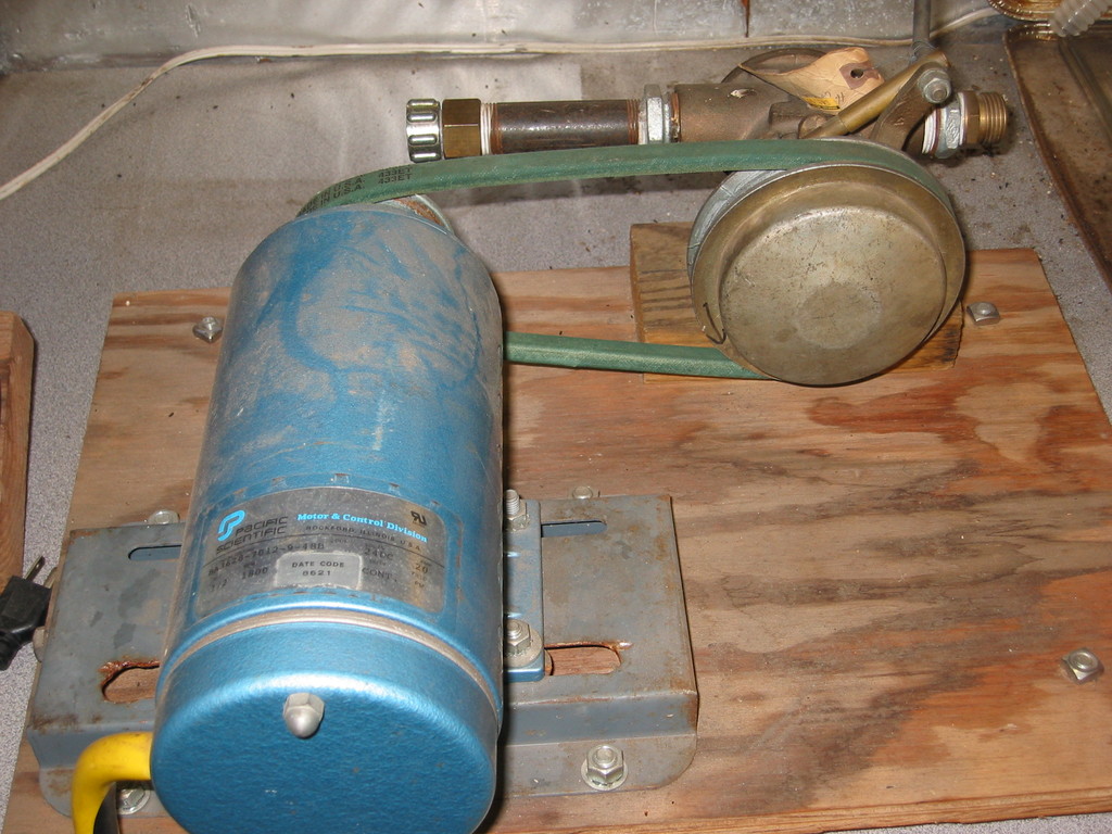

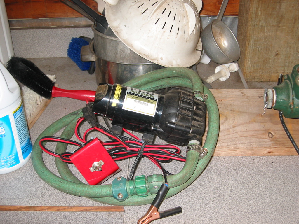

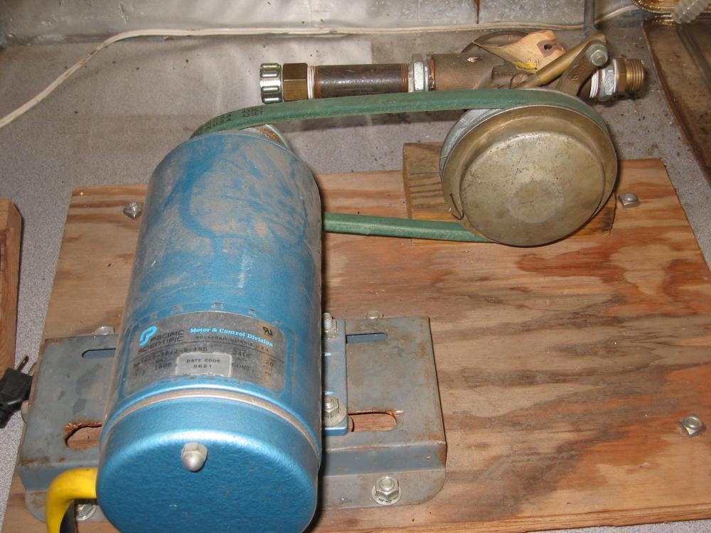

pfrederi 21,214 #10 Posted February 7, 2017 I took a quick look at jet pumps (not sure why you want that style need two lines one in the tank one back out to the pump then the one to the sprinkler, the ar for wells and pressure tanks) The smallest one i could find uses 10 amps. You would need a big inverter to run that. I have tried several set ups to water areas some close to power some not. The remote ones have been problematic. The best rig is the blue motor and pump. it will run two sprinklers at a reasonable strength. It is a 24v pump and draws 20 amps. I have to keep the M37 running or it can draw the two batteries down enough that after about 300 gals I am not confident she will start. Keep in mind a 12v motor of similar power would draw twice as much amperage. That would be a big load on a deepcycle battery (and have you priced big deep cycles lately?? I also have a 65 gal tank that rides on the mule (M274). I use the black 12v pump sometimes but it is hardly better than gravity. It will shoot a tiny stream a good distance but with very little volume.(Those pumps are really for spray units where you want pressure but are not moving a big volume. I used the small green one where I had power but it would only run one sprinkler and took forever to empty the handi tank. The Wayne Pump as i said will run two of the yellow sprinklers easily. Since I use pond water simple spray sprinklers are best as they do not clog up. What kind of sprinklers are you using??? I looked a few impulse ones at Gemplers and they seemed to use between 2 and 5 gpm depending on the pressure but at the low pressure the range was much reduced. Two of that type would as a minimum need about 4gpm and that would be with a reduced range. Moving 4gpm at 20 or better PSI is going to take a decent pump. 1 Share this post Link to post Share on other sites
