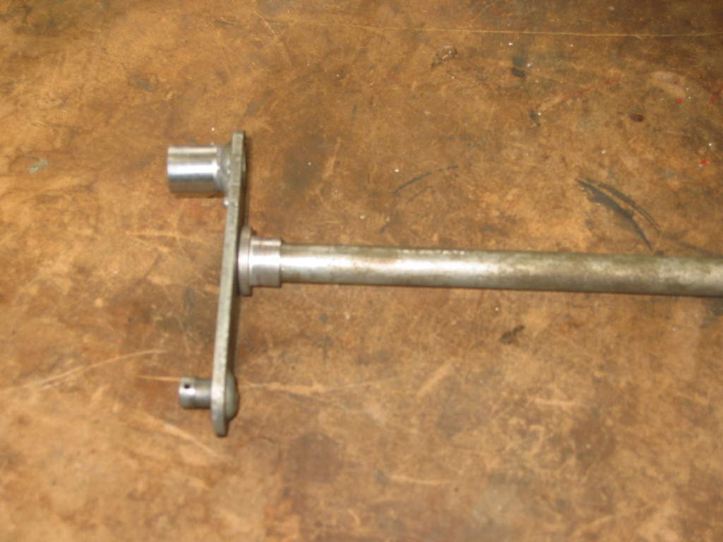

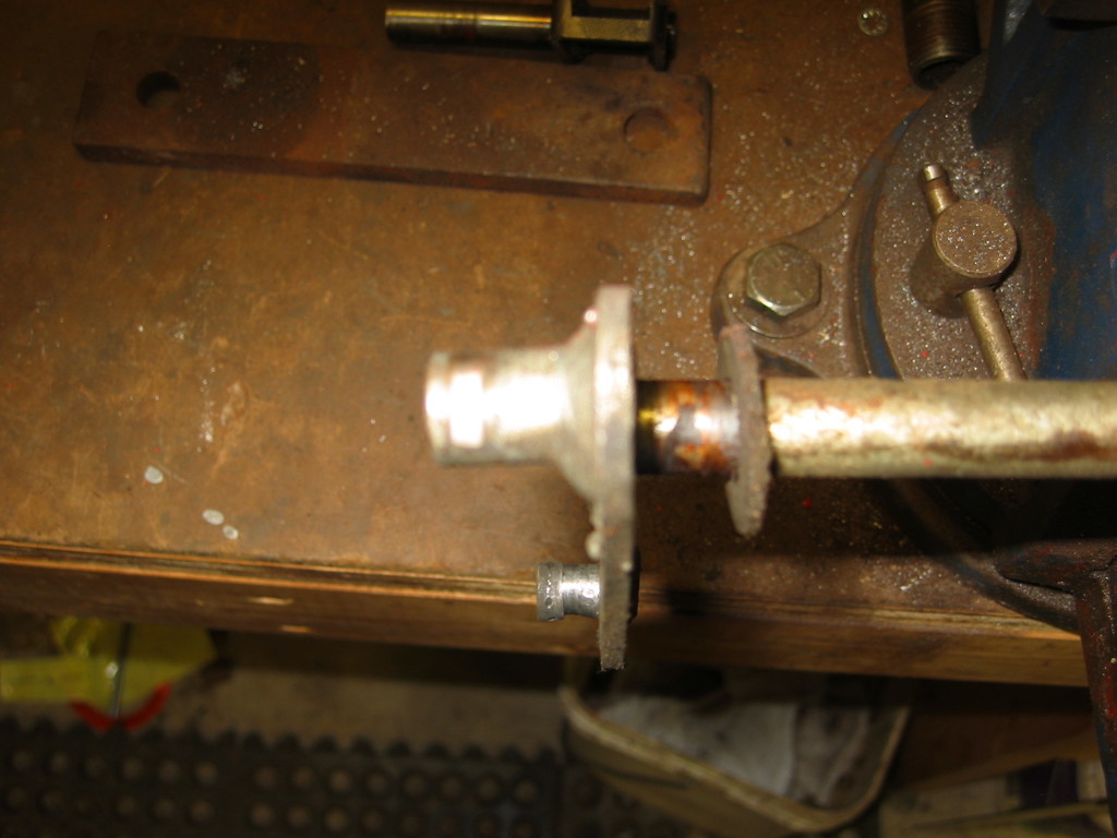

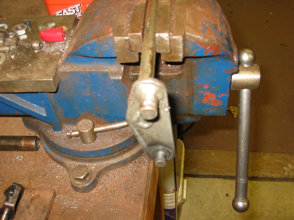

pfrederi 21,268 #1 Posted January 31, 2017 (edited) Ground down parking pawls (either the notched finger like pawl or the plain bail style) are all to common in Horses with Sundtrands. my charger 10 was no differ net. I welded up eh bail style and reinstalled it but realized right away that even disengaged it was dragging a little on the gear. Not nought to lock it up but it would make metal chips. Took a few minutes to ID the issue. Turns out the pin on the arm an rod assembly (#6130) had a groove worn in it so it didn't push the arm on the parking pawl down far enough to completely disengage it. I would also hazard a guess that there is some wear on the pawn lever it self that exacerbates the problem. Trying to decide if I should weld the groove up and file it to shape...but that leaves any wear on the arm unaddressed... or put a sleeve on the pin... thoughts??? Edited January 31, 2017 by pfrederi 2 Share this post Link to post Share on other sites

pfrederi 21,268 #3 Posted February 3, 2017 (edited) Turns out the the shaft was also worn where it comes through the frame (and the sleeve was shot also). Found some sleeve bearings and drilled the frame hole out to 5/8 used a flange bearing there and a straight one over the pin. Edited February 3, 2017 by pfrederi 1 Share this post Link to post Share on other sites
