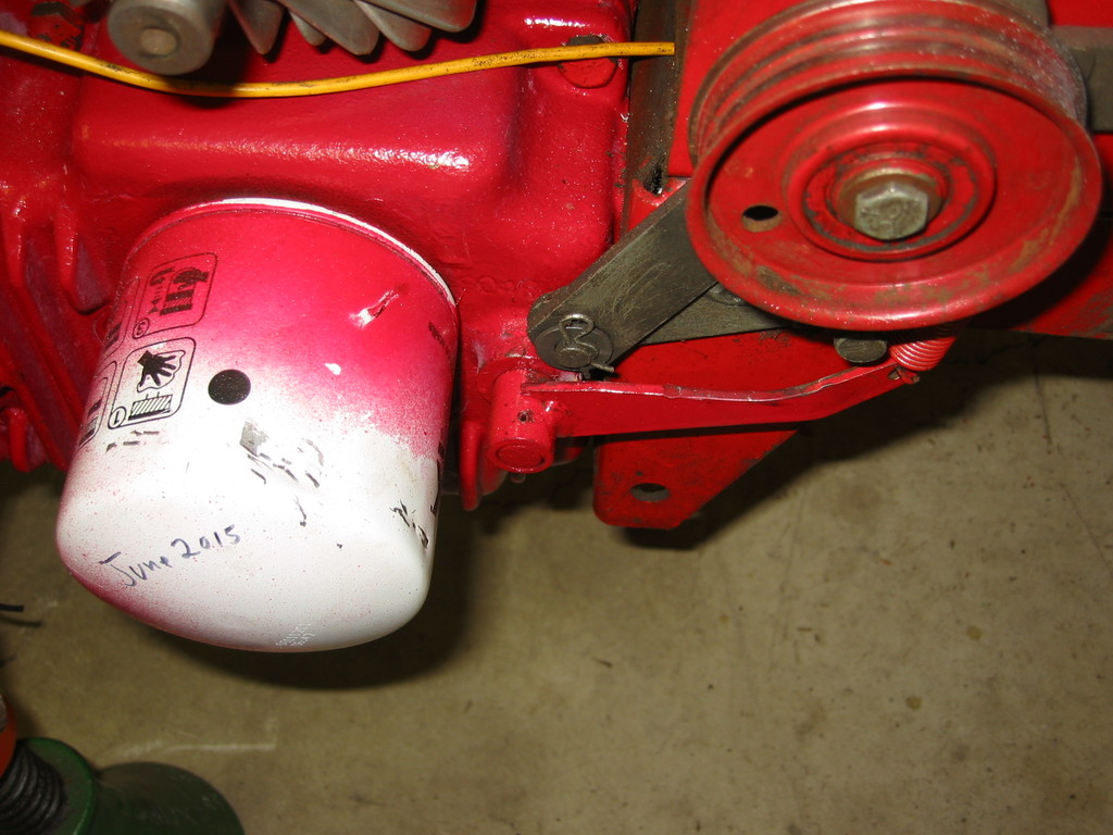

mikeeyre74 290 #1 Posted January 31, 2017 Goodness! There's no place to get a roll pin punch in here.. how are you supposed to get this parking brake pin installed or removed, if you wanted to? Share this post Link to post Share on other sites
pfrederi 20,680 #2 Posted January 31, 2017 What pin are you talking about what model??? is it this one Share this post Link to post Share on other sites

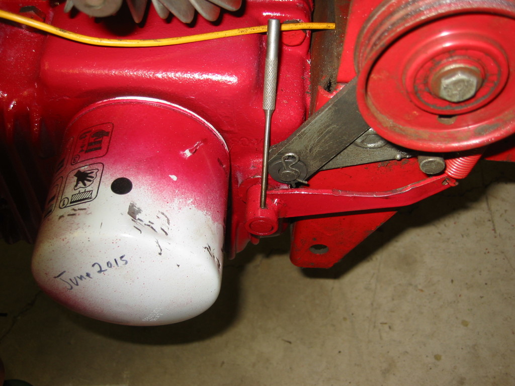

mikeeyre74 290 #3 Posted January 31, 2017 Hang on... there's a roll pin on the OUTSIDE of this too? Snap.. mine is the cast pawl that I've had welded up to repair. There's a roll pin that holds it onto the shaft inside the transmission. Lemme go look at this closer. Share this post Link to post Share on other sites
pfrederi 20,680 #4 Posted January 31, 2017 Mine are the bail style so i do not know about another pin but I would guess you install it then push the shaft through the case from the inside put the lever on and pin it on the outside 1 Share this post Link to post Share on other sites
mikeeyre74 290 #5 Posted January 31, 2017 Thank you! There was a bunch of dirt packed over top of the roll pin on THE OUTSIDE portion of the shaft and the PO had painted over top of that.. I didn't realize there was a roll pin out there too! I was trying to figure out how to drive the roll pin through the pawl from the INSIDE of the case! Hahah! I'm good now. 1 Share this post Link to post Share on other sites
pfrederi 20,680 #6 Posted January 31, 2017 It is a 1/8" roll pin good luck Share this post Link to post Share on other sites
