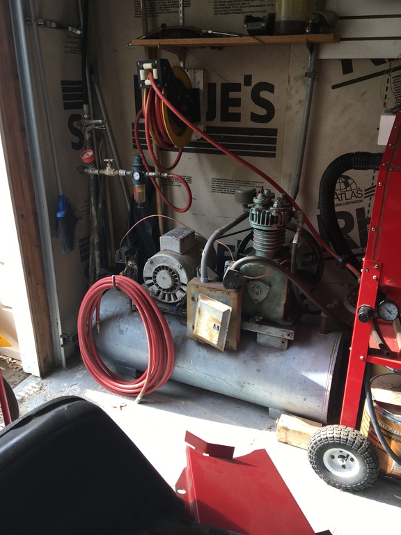

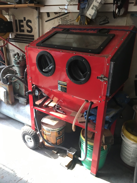

Dhodge 530 #18 Posted May 19, 2017 Here is my blast cabinet. It's a HF unit with a lot of upgrades. The cabinet, despite it's size, works very well with the upgrades to a foot pedal and new blasting gun. I cut the inside grate so it fits lower into the bottom of the cabinet and done away with the siphon style, pickup media gun to a gravity fed from the bottom of the cabinet. I have a media regulation outfit on the bottom media feed to control the volume of media. The cabinet with work and $$ can be made to perform very, very well but I doubt I would have any less money tied up into a commercial grade cabinet. My compressor is an old Garner Denver unit and I'm unsure of the horsepower, cfm or psi. I basically put everything together. I'm guessing the tank to be 60 gallon based on visual size. When I blast my compressor runs constantly and I hope to upgrade my compressor soon. As stated above PSI means little when blasting as compared to CFM. Air volume is king. air pressure can be regulated by squeezing it down. I'm no expert by any means, but my experience is the compressors that produce high CFM rates mean more when blasting than anything else. Also running larger lines to the blast cabinet is a major plus as well. Volume, volume, volume. 1 Share this post Link to post Share on other sites

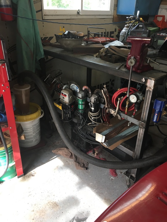

Dhodge 530 #20 Posted May 19, 2017 (edited) The other thing that's a must is a dust collector system. I purchased a cyclone unit that's mounted on a 5 gallon drop collection bucket that's all connected to a shop vac. It maintains a clear site window free of dust. clouds. The unit is left of my home made welding table down by the grinders Edited May 19, 2017 by Dhodge 2 Share this post Link to post Share on other sites
