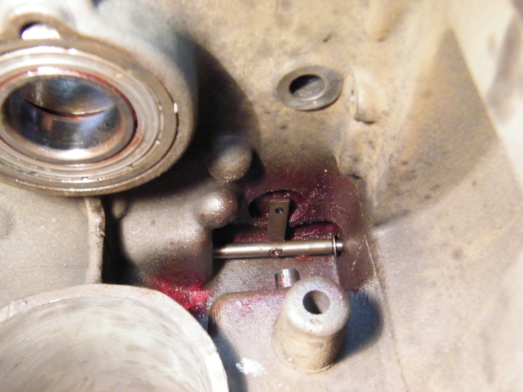

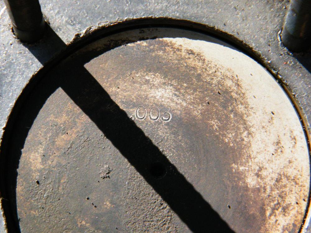

stevasaurus 23,808 #8 Posted January 29, 2017 Joe, you have a couple things going on. Can you put a picture of the top of your piston, now that you have the head off. If it kind of looks like this...that clean area from 12 to 4 o'clock shows oil blow by, and you need to rebuild the engine first. That is the blue smoke...does not matter if it start up or under load. The other thing you have going on, is the governor. Your engine is never going to run under load if that cross shaft is not locked with that lock nut. If it still turns when that net is tight, it is not doing what it is supposed to do. Rebuild the engine first (I just tore down my K181 on my 876...taking it to the machine shop Monday). When you get it back, let's put it back together. Check out Mike Prondzy's thread in the "Reference" Section/Engines...K181 rebuild. The manual, if you do not have it, is in the manual section under engines. Check out the manual and read it...everything you want to know...and we are here to walk you through it. I hope you know that you can not just change the rings and put it back together, you need good measurements and either bored and/or cross hatching. Checking the valves, tolerances, etc. It is not a huge project, but you are just wasting your money if you do not do it right. I used a ratchet strap to hold the fly wheel to get the castle nut loose, and then to use the puller to get the fly wheel off. I did not take the engine off the horse until I got all the pulling stuff off the engine. 7 Share this post Link to post Share on other sites
Joebag 17 #9 Posted January 29, 2017 1 hour ago, stevasaurus said: Joe, you have a couple things going on. Can you put a picture of the top of your piston, now that you have the head off. If it kind of looks like this...that clean area from 12 to 4 o'clock shows oil blow by, and you need to rebuild the engine first. That is the blue smoke...does not matter if it start up or under load. The other thing you have going on, is the governor. Your engine is never going to run under load if that cross shaft is not locked with that lock nut. If it still turns when that net is tight, it is not doing what it is supposed to do. Rebuild the engine first (I just tore down my K181 on my 876...taking it to the machine shop Monday). When you get it back, let's put it back together. Check out Mike Prondzy's thread in the "Reference" Section/Engines...K181 rebuild. The manual, if you do not have it, is in the manual section under engines. Check out the manual and read it...everything you want to know...and we are here to walk you through it. I hope you know that you can not just change the rings and put it back together, you need good measurements and either bored and/or cross hatching. Checking the valves, tolerances, etc. It is not a huge project, but you are just wasting your money if you do not do it right. I used a ratchet strap to hold the fly wheel to get the castle nut loose, and then to use the puller to get the fly wheel off. I did not take the engine off the horse until I got all the pulling stuff off the engine. here is what it looked like 2 Share this post Link to post Share on other sites
Elkskin's mower junkyard 1,117 #10 Posted January 29, 2017 1 hour ago, Joebag said: here is what it looked like take ur thumb press down on valves see if you can spin them. you shouldnt be able to spin them at top dead center. Share this post Link to post Share on other sites

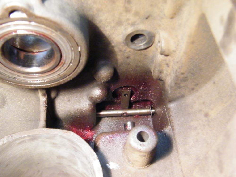

Joebag 17 #15 Posted January 29, 2017 6 minutes ago, Shynon said: Just curious how do you get a compression reading on an ACR motor? The little tab on the inside of the motor which is attatched to the cross shaft is broken off, there for the shaft will just turn and turn and turn, so the gowernor will never engage under load and speed up the motor, thus it will die. will it be an easy fix Share this post Link to post Share on other sites

Shynon 7,646 #17 Posted January 29, 2017 When you tear the motor down, get a new or good used one and replace it. The whole motor needs to be disassembled to replace that. 1 Share this post Link to post Share on other sites

953 nut 68,676 #24 Posted January 29, 2017 14 hours ago, Joebag said: checked for slop on top of the piston, no movement an walls are as smooth as silk As a rule the top and bottom of the cylinder do now have any wear, the center will. The cylinder wall being smooth as silk is not a good thing. 8 hours ago, Joebag said: I am going to have afriend help me rebuild it. I am going to buy a ultimate rebuild kit $224.00 Don't buy any parts until it has been measured to see what size the crank and cylinder need to be machined to. 8 hours ago, artfull dodger said: the Gov isnt working Here is the best way to set your timing. Kohler static_timing.pdf 2 Share this post Link to post Share on other sites

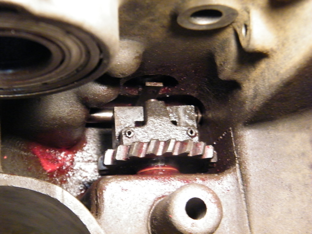

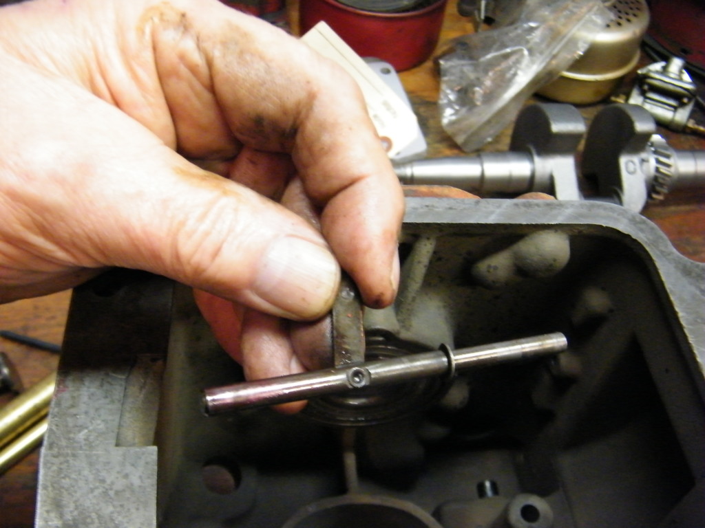

stevasaurus 23,808 #25 Posted January 29, 2017 Joe, here is what that cross shaft looks like. I'm holding it by the flag that the guys are saying broke off. It's the right end that sticks out of the block. In this picture, you can see the cross shaft and the flag up against the piston of the gear. Nice video Joe. 5 Share this post Link to post Share on other sites
