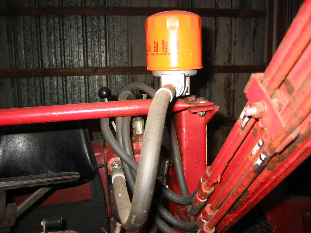

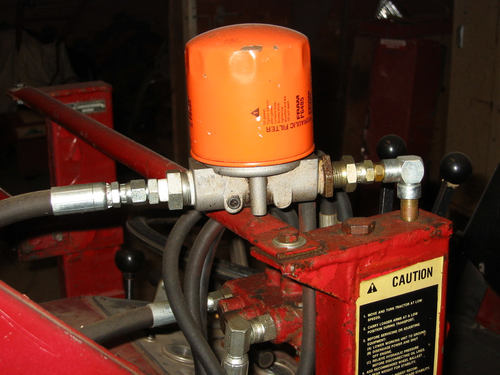

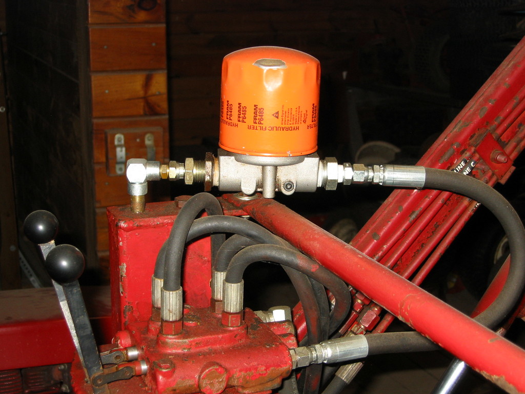

pfrederi 20,877 #2 Posted January 27, 2017 Here is my set up. No comments about the plumbing please. The filter base was originally for one of my big tractors but not used. I realized after I got the D200 with loader that the lousy little suction screen was probably not adequate so I fixed this up using whatever plumbing fixtures I had lying around. Has worked for several years now with out any issue. The feed hose is bigger than needed. It was all my hose guy had at the time. Consequently I bought appropriate hose and fittings and now he crimps them for me. Never saw the need to redo this one. If doing it again I would use a mounting plate Share this post Link to post Share on other sites
