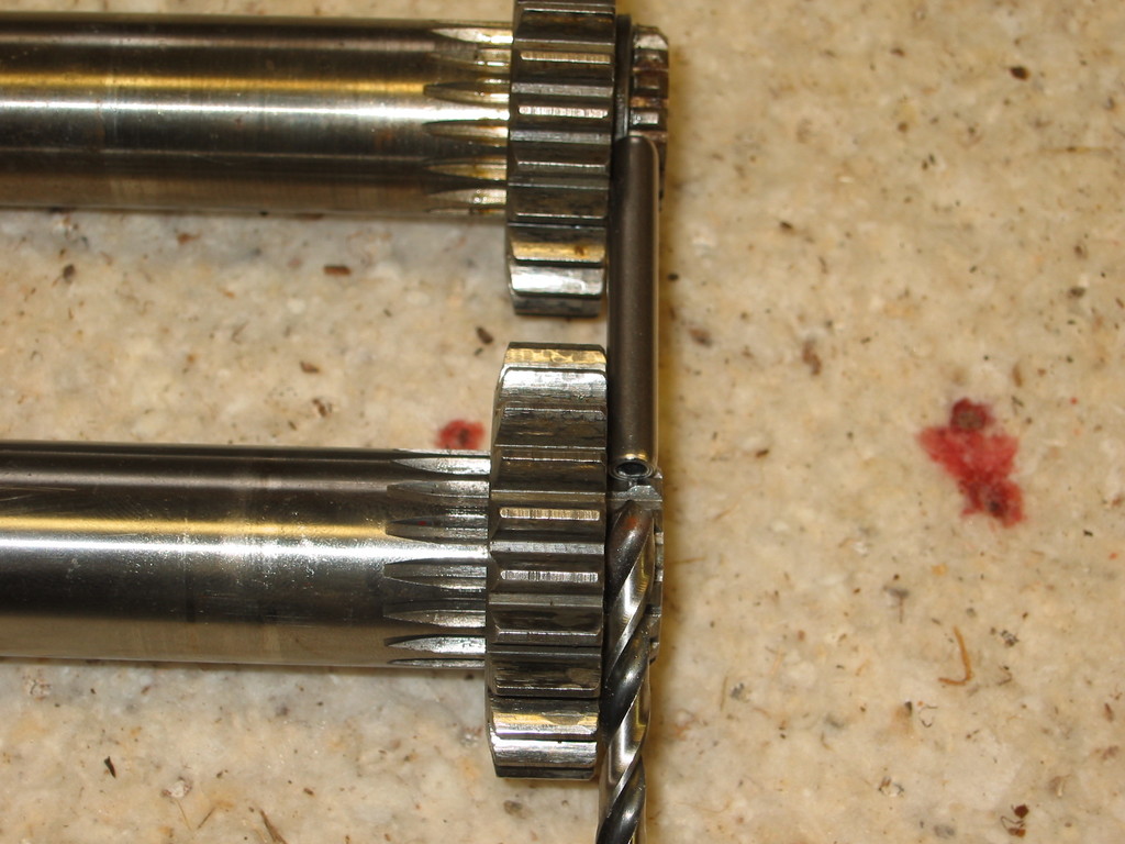

pfrederi 18,757 #1 Posted January 24, 2017 Working on a Charger 10 with the 5 pinion differential. Discovered the snap ring had come off one axle and chewed up the end to the extent I am not comfortable just putting on a new snap ring. On these rear ends WH used two different length axle shafts The right side is 12 inches long...and that is the one that is messed up. Went to my parts bin and found some decent axles. of course none were 12" long. I have 3 nice shafts 11-5/8 inch. Inquiring minds want to know would it be terribly wrong to use one of those? The hub would stick out 3/8" beyond the end of the shaft but other than ascetics I can't believe it would weaken the system that much. Alternatively I could drill the end of the shaft and use a roll pin as WH did at some point in the past. (Anyone remember what size roll pin they used?) Other ideas???? Share this post Link to post Share on other sites

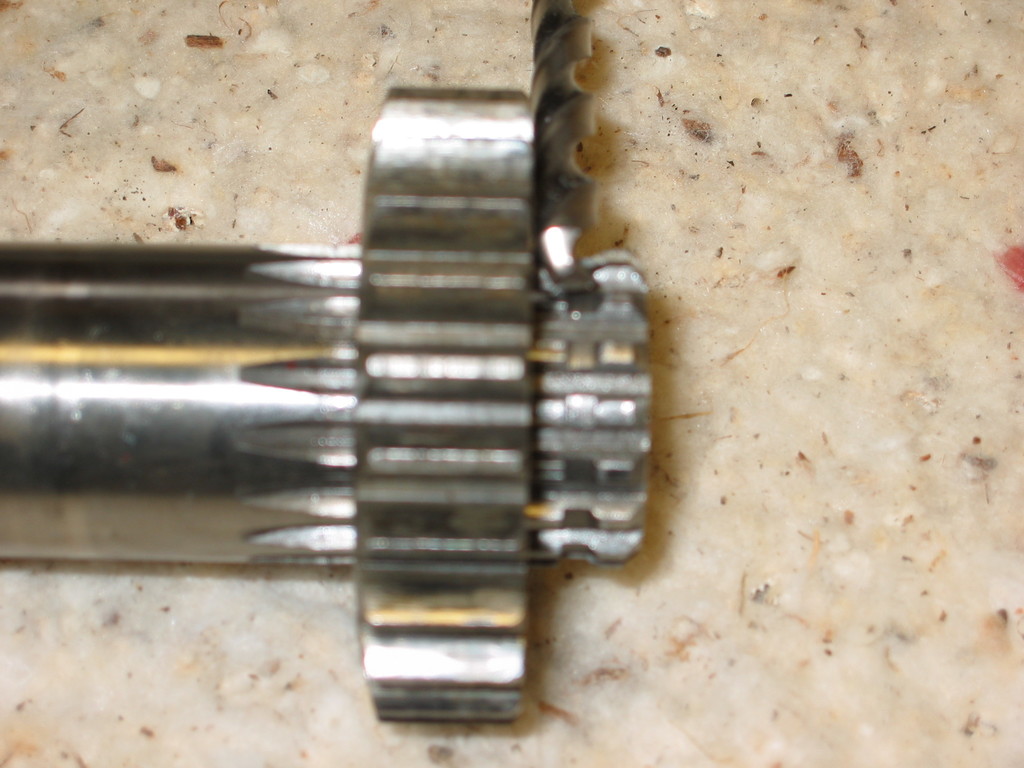

pfrederi 18,757 #5 Posted January 25, 2017 Looked at drilling the axle. To get some metal beyond the roll pin (Inside end) I would have to drill the hole such that it would force the gear further out and result in more axle being inside the differential ..potential hitting the other axle??? The outer edge of teh snap ring slot is just a hair over 1/4 inch in from the end. Would any f thei make any difference?? First picture shows 1/4"drill/and pin relative to the snap ring slot edge the second pic about where I would think it should be drilled 1 Share this post Link to post Share on other sites

stevasaurus 23,325 #8 Posted January 25, 2017 I'll bet you could use a 3/16 roll pin and keep 3/16" of axle end...that would be like gaining 1/8". Great pictures Paul. That double clip idea has some merit. 1 Share this post Link to post Share on other sites
pfrederi 18,757 #9 Posted January 25, 2017 (edited) I will take another picture tomorrow but if the snap ring groove was widened there would hardly be any material left on the end of the shaft. Edited January 25, 2017 by pfrederi 1 Share this post Link to post Share on other sites
