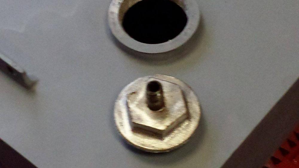

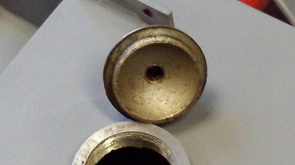

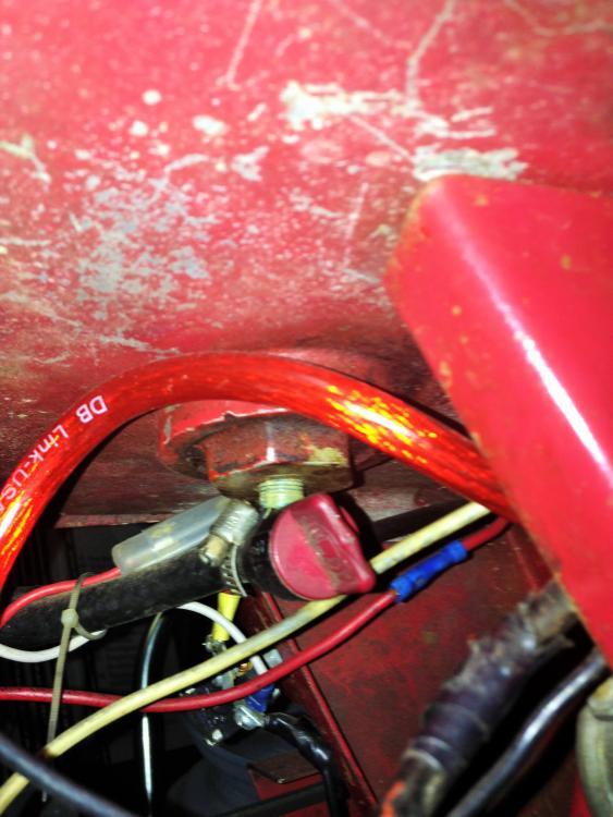

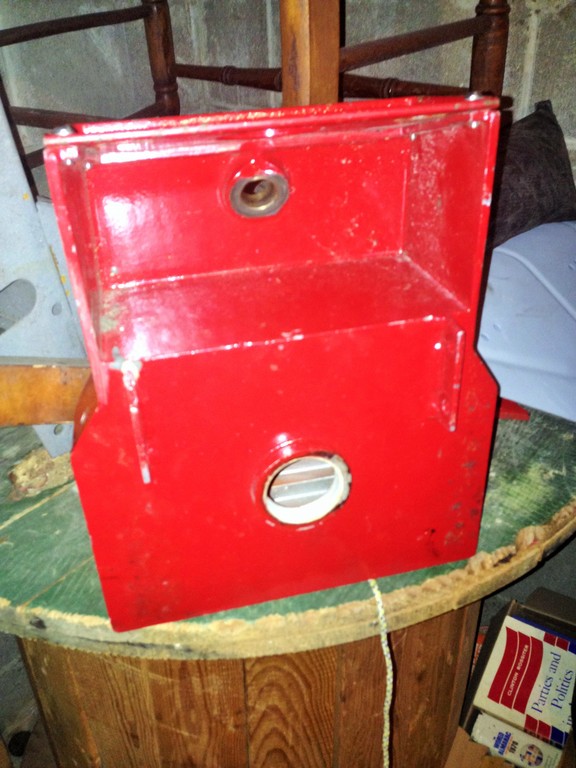

Lane Ranger 12,031 #1 Posted January 24, 2017 (edited) A friend here in Indiana and I are working on 702 parts for restorations . We both need to find out where to get a gas tank bung that goes in the bottom of the gas tank on the 701 and 702 tractors. The one piece (and may be on some two piece tanks but I am note sure. I know most two piece tanks did not have the 2 1/2 hole) tank bung also has a threded hole in the center to install the sediment bowl that set underneth the tank and from which the gas line ran to the motor. Here are pictures of my New Old Stock one piece gas tank. Anyone know where we can buy a bung or tank plug that will work to install in these tank bottoms for a sediment bowl or shutoff valve for the gas line? I would apprecaite any suggestions. This third photo shows the bung under my 701 Wheel Horse gas tank with a threaded extension pipe coming down into a plastic gas shutoff valve. Edited January 24, 2017 by Lane Ranger Share this post Link to post Share on other sites

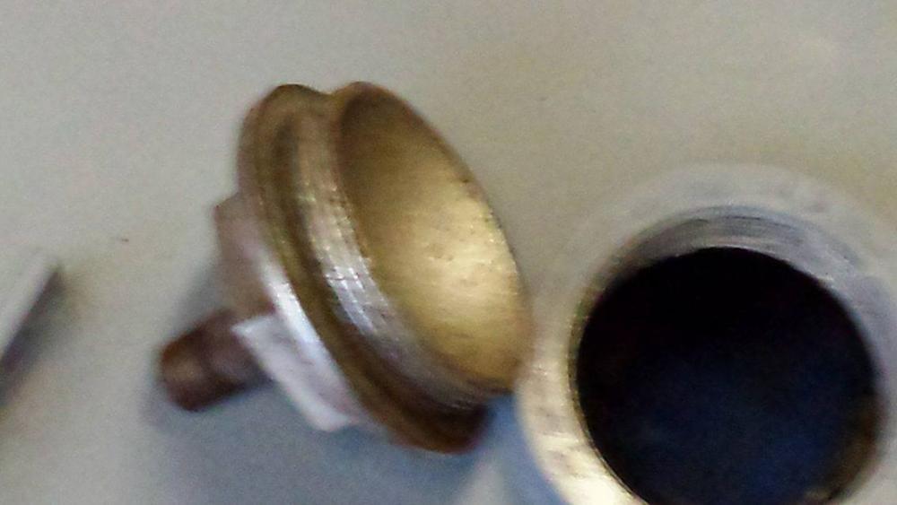

Lane Ranger 12,031 #8 Posted January 24, 2017 This is what an original plug looks like. Not my photos and I don't have measurements but may be more like 2.25 than 2 1/2 inche wide Share this post Link to post Share on other sites
WHX?? 57,470 #9 Posted January 24, 2017 Looks to me Lane the bung/plug in the NOS is not an NPT thread but the pics could be deceiving. Looks like it might have required some kind of gasket as well looking at the flange on the plug??? On the other hand your last pic in post 1 looks like it is just threaded in with perhaps some pipe dope or thread sealer? Need to find out what actually is the size/thread then I can dig through a box of odd plugs I have.... never know I may have one. Will have to look at my 702 to see what it has. You could get your mitts on a couple diffterent sizes of the cheap abs/pvc pipe plugs to see if they will seal up. 1 hour ago, Lane Ranger said: Is ABS something that can be drilled For sure but I would rather see you try and obtain & drill tap a metal one eventually tho. 1 Share this post Link to post Share on other sites

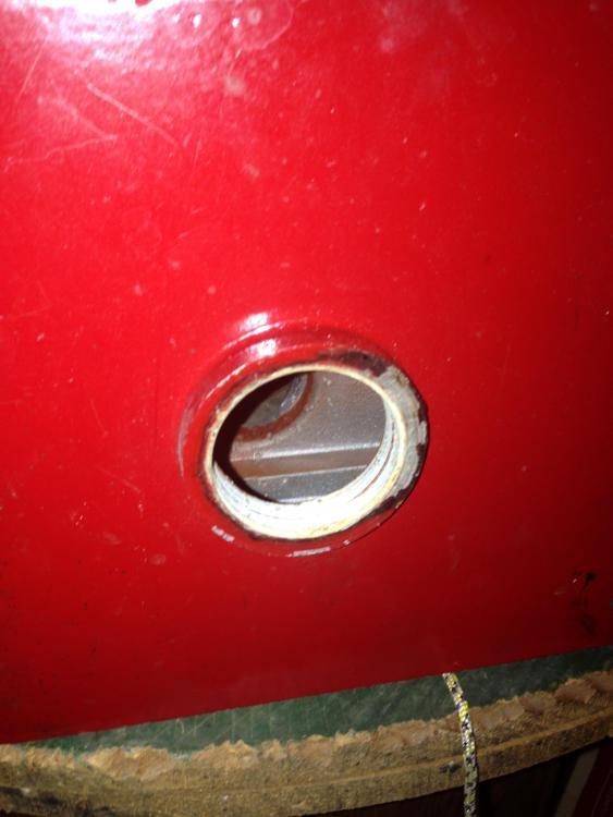

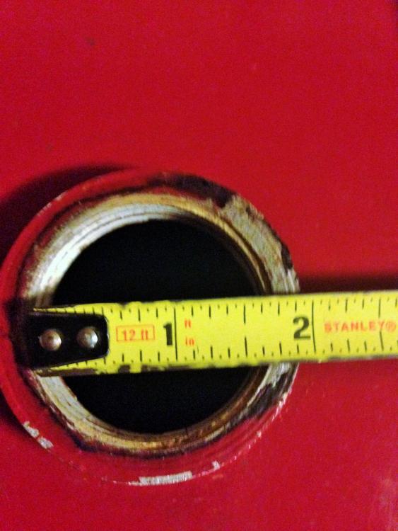

Lane Ranger 12,031 #10 Posted January 24, 2017 Ok took another picture of the hole in the bottom of the gas tank with a measuring tape. Looks like 1 3/4 or 1 5/8 is the width. Yes and looks like a seal or some form of gasket materials was on the plug to seal the hole. Share this post Link to post Share on other sites
gwest_ca-(File Mod) 12,373 #11 Posted January 24, 2017 1-1/4" pipe has a 1.660" OD. A tap drill is 1-1/2" for tapered pipe threads and 1-33/64" for straight threads. That should be very close to the thread ID. 1-1/2" pipe has a 1.900" OD. A tap drill is 1-47/64" for tapered pipe threads and 1-3/4" for straight threads. That should be very close to the thread ID. Both sizes have 11.5 threads per inch. Garry 1 Share this post Link to post Share on other sites
