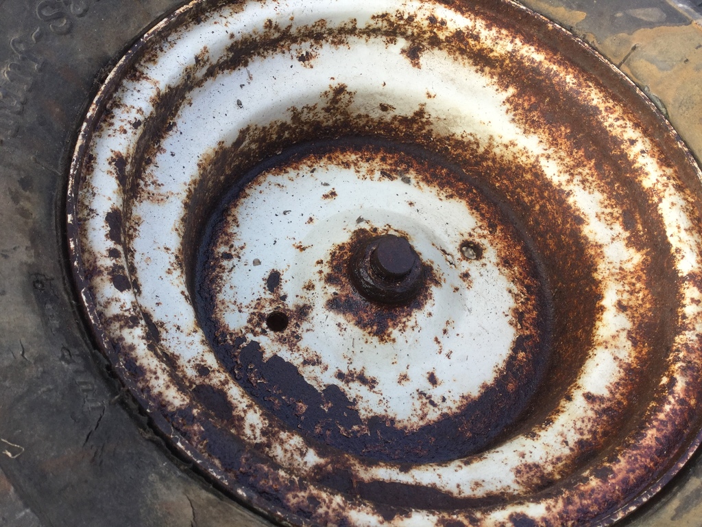

Porangi 21 #1 Posted January 23, 2017 Morning all, The image below shows the state of my axle that the kind previous owner left it in. So far all I have done is spray some penetrating spray on to it. How would you approach the removal of this wheel. Thanks in anticipation. Chris PS: B165 spares seem to be rather rare 1 Share this post Link to post Share on other sites
C-121uk 183 #2 Posted January 23, 2017 Hi, is this a rear or front wheel because I know front wheels are just a standard size and there is always some for sale on that auction site. Share this post Link to post Share on other sites
Porangi 21 #3 Posted January 23, 2017 Its a rear. The end is splayed from the last person using a hammer to try and remove it. Share this post Link to post Share on other sites
gwest_ca-(File Mod) 12,478 #4 Posted January 23, 2017 I doubt it will ever come off now without destroying something. Why did you want to remove it? Garry Share this post Link to post Share on other sites
pfrederi 21,095 #5 Posted January 23, 2017 You might try a carbide bit in a die grinder to remove the mushrooming Share this post Link to post Share on other sites
gwest_ca-(File Mod) 12,478 #6 Posted January 23, 2017 There are two different size square keys used on the B-Series hubs. One for gear transmissions and one for hydro transmissions but can't tell which model uses which key. One is 3/16" x 3/16" x 2" and may be part number 1120 for the gear transmissions. The other is 1/4" x 1/4" x 2" and may be part number 2590 replaced by 5-1336 for the hydro models. If you clean up the outside of the hub you should find the square hole for the key. Clean that out and add penetrating oil on a regular basis. Then just using the tractor may eventually break it loose and do no damage. Garry Share this post Link to post Share on other sites
953 nut 68,773 #7 Posted January 23, 2017 Hope the pounding of the previous owner hasn't damaged the differential. Is the back side of the hub also rusted badly? If not, I would suggest heating the outside end of the hub and axle and letting them cool; as they cool add some penetrating oil. The heat will break the bond of the rust and help the oil penetrate. After you grind off the splayed end you might have to use a hydraulic press to get it off. Share this post Link to post Share on other sites

jeff lary 173 #12 Posted January 24, 2017 If I really needed to get the wheel off of the axel... I would start by using a flat file and return the mushroomed end of the shaft to the original size/ diameter. Then I would make a wheel puller using the 2 existing holes in the wheel and some suitable bolts. Take a center punch and make a divot in the center of the shaft. Then take maybe a 1/4 drill and drill a small cone shape into the end and use the wheel puller center pointed bolt in that hole. Add copious amounts of heat should pull off quite easy I would expect. Now for a different approach any tire shop can replace the tires right the way they are I am quite sure. This would be much easier but just knowing the wheel is stuck on the shaft would drive me nuts... Ha Ha good luck Jeff Share this post Link to post Share on other sites
Porangi 21 #13 Posted January 25, 2017 21 hours ago, jeff lary said: If I really needed to get the wheel off of the axel... I would start by using a flat file and return the mushroomed end of the shaft to the original size/ diameter. Then I would make a wheel puller using the 2 existing holes in the wheel and some suitable bolts. Take a center punch and make a divot in the center of the shaft. Then take maybe a 1/4 drill and drill a small cone shape into the end and use the wheel puller center pointed bolt in that hole. Add copious amounts of heat should pull off quite easy I would expect. Now for a different approach any tire shop can replace the tires right the way they are I am quite sure. This would be much easier but just knowing the wheel is stuck on the shaft would drive me nuts... Ha Ha good luck Jeff Hi Jeff, I really like the simplicity of your approach and hope you are right. I also totally agree with your feeling towards replace tyre as is (have ordered long tyre levers) and knowing the wheel is stuck on the shaft is driving me NUTSSSSS. One question - will leaving it on as is allow it to get worse and reduce my long term chances of getting it off at all? Thanks Chris Share this post Link to post Share on other sites
