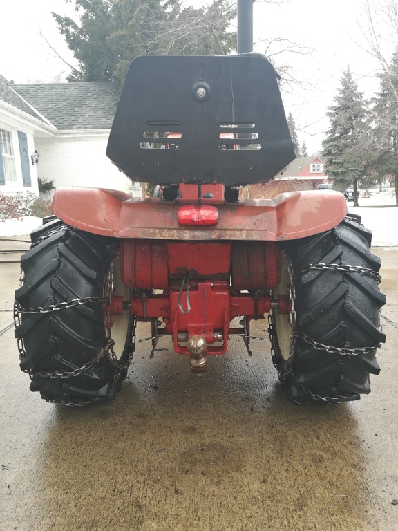

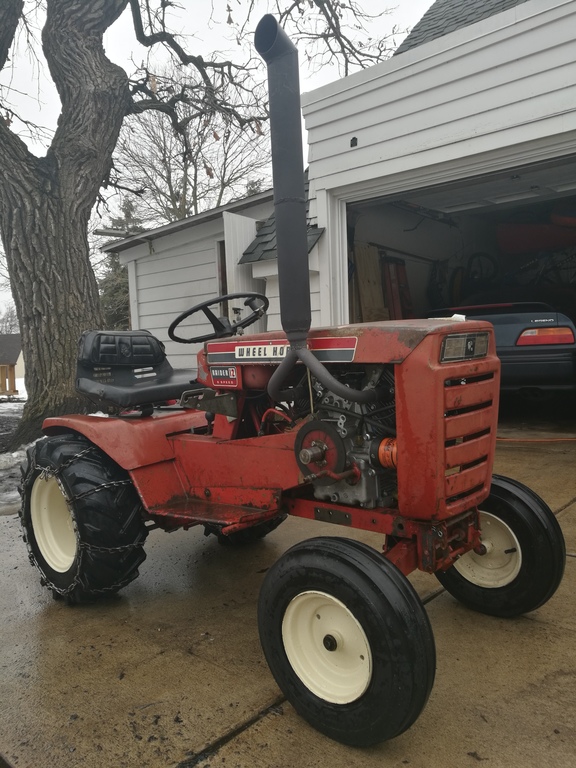

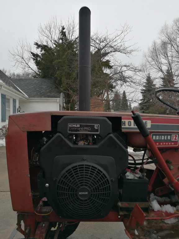

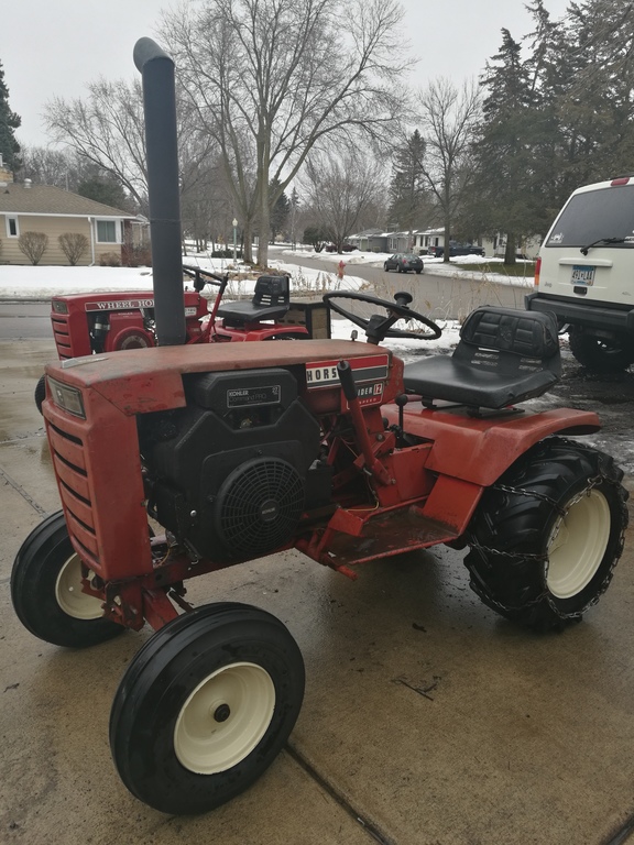

JamesC-120 204 #1 Posted January 22, 2017 (edited) About a year ago I bought an 18hp Kohler Command and I had a raider 12 that needed an engine so I put the two together and the thing is a beast. Well the 18hp never ran like it did from the factory, just wasn't quite right. And trust me I did everything to it and nothing fixed it. Well about 2 weeks ago I got a new 27hp Kohler Command for $250! Was defective from the factory and wouldn't run. So I decided the 27hp would be a good swap for the 18hp. So I did. All that was wrong with the 27 was the oil pressure sensor was bad. Edited January 22, 2017 by JamesC-120 14 Share this post Link to post Share on other sites

JamesC-120 204 #4 Posted January 22, 2017 Pictures are up now! 4 Share this post Link to post Share on other sites
AMC RULES 37,259 #5 Posted January 22, 2017 Wondering... was the height of the exhaust built to fit the garage door opening? 3 Share this post Link to post Share on other sites
SylvanLakeWH 31,794 #6 Posted January 22, 2017 Very cool! Time for a new decal kit!!! Share this post Link to post Share on other sites
JamesC-120 204 #7 Posted January 22, 2017 The exhaust clears by at least 6" but I did not think about that when I built it. 2 Share this post Link to post Share on other sites

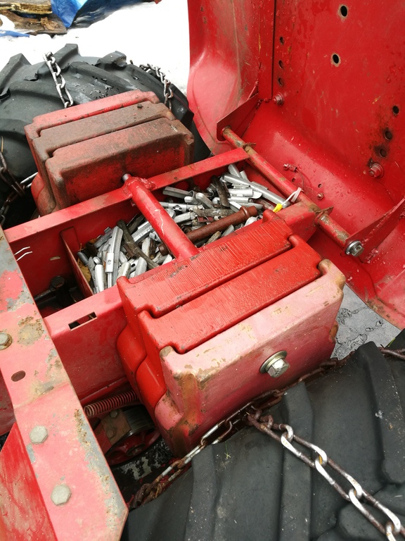

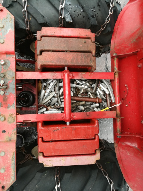

857 horse 2,588 #8 Posted January 22, 2017 after paying no attention toexhaust height is that weights tucked under the seat pan,???? How does that work????? NEAT !!!!! 4 Share this post Link to post Share on other sites
roadapples 6,987 #9 Posted January 22, 2017 40 minutes ago, 857 horse said: is that weights tucked under the seat pan,???? I`d like to see pictures of how there fastened... 2 Share this post Link to post Share on other sites
JamesC-120 204 #10 Posted January 22, 2017 (edited) Yes there are weights under there. I welded a tube between the two pieces of metal under the seat and then welded a nut in the end of each side of the tube so I could bolt the weights on. There are six 30lb weights and then a bunch of old wheel weights in the middle. Edited January 22, 2017 by JamesC-120 7 Share this post Link to post Share on other sites
roadapples 6,987 #11 Posted January 22, 2017 Nice neat job. Never saw weights like that.... Could this be the first "Raider 27" ? Share this post Link to post Share on other sites
JamesC-120 204 #12 Posted January 22, 2017 I'm sure it is the first. I haven't seen a lot of square hoods with vtwins. 1 Share this post Link to post Share on other sites
SylvanLakeWH 31,794 #13 Posted January 22, 2017 That is COOL! Nice Job! Share this post Link to post Share on other sites
prondzy 3,889 #14 Posted January 22, 2017 Looks good james! Hopefully that stack has a little more support this year for plowing. So what did you do with the 18hp?? Share this post Link to post Share on other sites

JamesC-120 204 #18 Posted January 22, 2017 How many HP is that Kohler? Share this post Link to post Share on other sites
