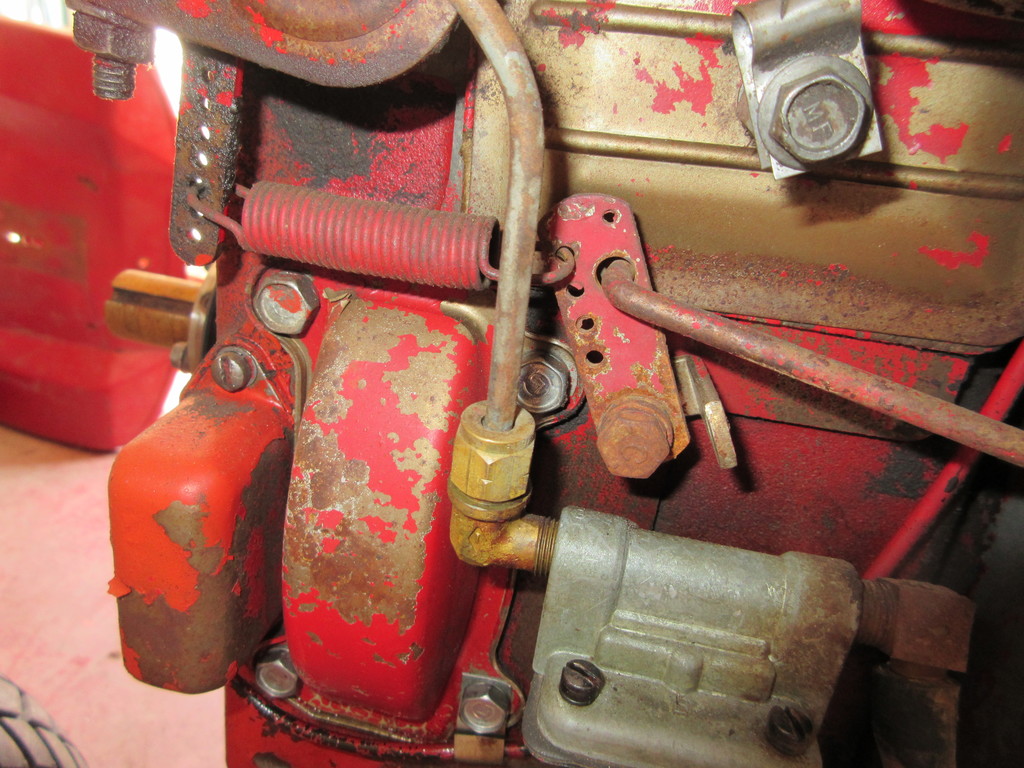

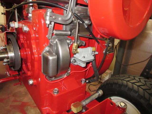

Richard Stoots 17 #1 Posted January 22, 2017 (edited) Engine was seized so I decided to clean and paint while waiting on parts. Now I can't remember how the carb. linkage was attached. I think I have the choke OK but need help on the throttle. Can anyone email me some pictures of the front of motor without the air cleaner obstructing the view? rstoots@verizon.net Thanks Thanks for the pictures, throttle linkage is solved. I DO need help with choke linkage, not sure how cable attaches. Edited January 22, 2017 by Richard Stoots Share this post Link to post Share on other sites

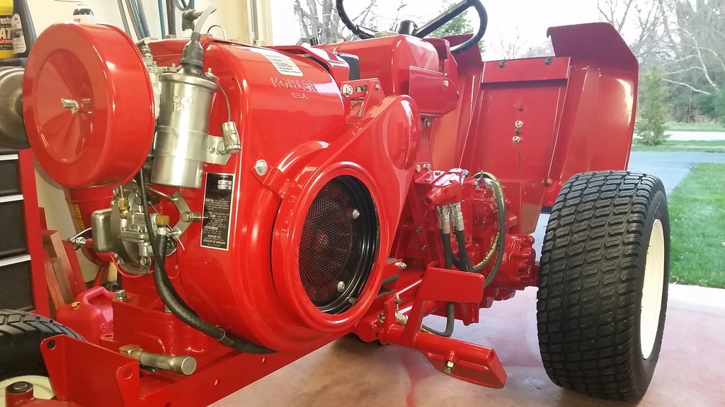

953 nut 63,913 #2 Posted January 22, 2017 Welcome to @Richard Stoots, This photo should give you the needed information. 7 Share this post Link to post Share on other sites

953 nut 63,913 #4 Posted January 22, 2017 1 minute ago, Thegearhead0324 said: eat off of that motor. Not mine, it is a photo from our Gallery that I had saved . Think it belongs to @Zeek if I remember correctly. 2 Share this post Link to post Share on other sites
Thegearhead0324 1,356 #5 Posted January 22, 2017 Oh... oops lol. After that pic tho I got a lotta work to do. 1 Share this post Link to post Share on other sites
Zeek 2,299 #6 Posted January 22, 2017 1 hour ago, 953 nut said: Not mine, it is a photo from our Gallery that I had saved . Think it belongs to @Zeek if I remember correctly. That is my 1276 9 Share this post Link to post Share on other sites

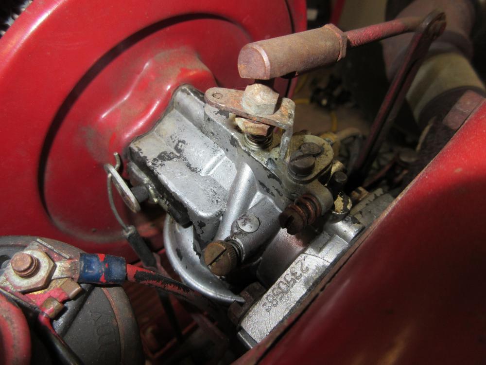

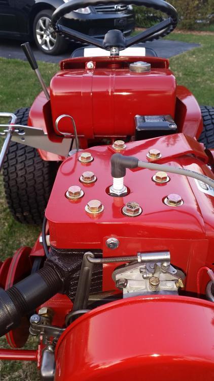

Richard Stoots 17 #9 Posted January 22, 2017 Thanks for the pictures, throttle linkage is solved. I DO need help with choke linkage, not sure how cable attaches. 1 Share this post Link to post Share on other sites

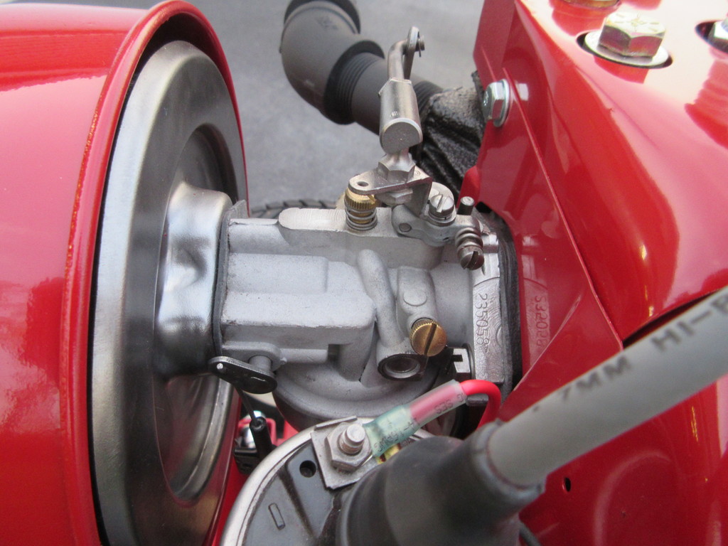

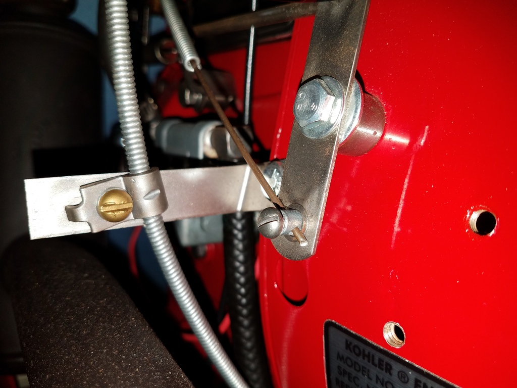

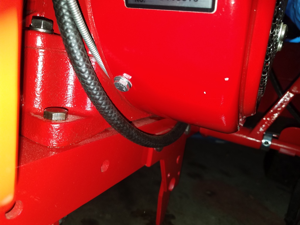

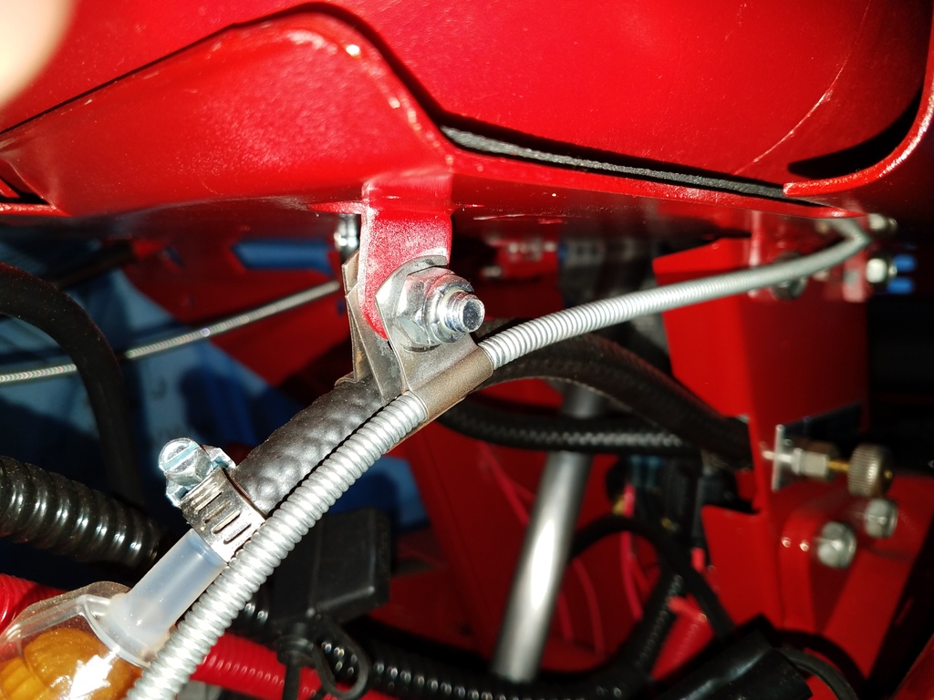

Zeek 2,299 #10 Posted January 22, 2017 Try these. Let me know if you need others. It is held in place by that bracket that mounts to the block (below the coil). Actually here are few more I just took from my Raider. It's the same setup - off the carb - down through the bracket - under the engine - up through bracket by gas tank - to dash 3 Share this post Link to post Share on other sites
Richard Stoots 17 #11 Posted January 23, 2017 Thanks for the pictures, throttle linkage is solved. I DO need help with choke linkage, not sure how cable attaches. Thanks again, all hooked up ready to start?????????? Share this post Link to post Share on other sites
