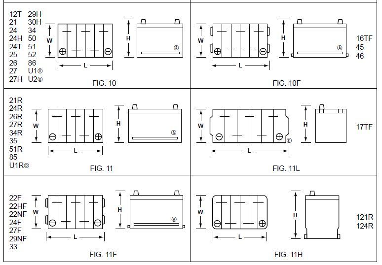

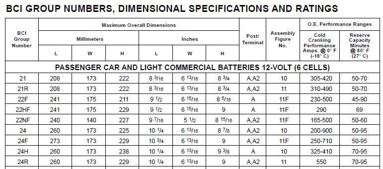

squonk 48,141 #26 Posted January 23, 2017 (edited) Chris, your battery should be a 24R. I just replaced mine last week. Counter guy tried to give me the regular 24 but I caught it before he scanned the numbers. Maybe that "F" is an "R" with the ink missing from the curly part. 9 hours ago, clueless said: Just looked at the battery in the tundra, it's a Intestate MT24F, I think the MT stands for mega tron, or mega ton, so my assumption is the F has something to do with the right hand positive post. Edited January 23, 2017 by squonk 1 Share this post Link to post Share on other sites

clueless 3,439 #31 Posted January 23, 2017 9 hours ago, squonk said: Chris, your battery should be a 24R. I just replaced mine last week. Counter guy tried to give me the regular 24 but I caught it before he scanned the numbers. Maybe that "F" is an "R" with the ink missing from the curly part. Nope, it's an F, Interstate MT-24F, no curly parts missing. Share this post Link to post Share on other sites
pfrederi 21,172 #32 Posted January 23, 2017 24F is a battery group (Its terminals are of the normal R pattern) Share this post Link to post Share on other sites
Jayzauto 89 #33 Posted February 22, 2017 Good Info here guys, just a quick note, The 'F' designation refers to 'Ford', as Ford's (Vehicles) of the day used Reversed terminals, compared to other manufactures of the time. An 'F' or 'R' designation in the part number mean essentially the same thing. GLuck, Jay 2 Share this post Link to post Share on other sites
