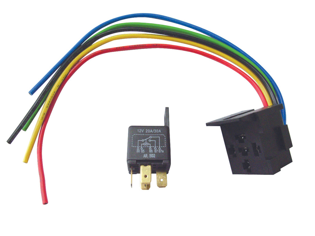

gwest_ca-(File Mod) 12,489 #5 Posted January 21, 2017 The simplest way to modify the ignition would be to add a relay to the M ignition wire. The relay would normally ground the ignition to shut the engine off. With the original battery ignition switch in the run position it would open the relay contacts and allow the engine to run. Doing it this way makes use of the original safety switches that control the ignition as they are presently wired. A very common relay Garry 6 Share this post Link to post Share on other sites

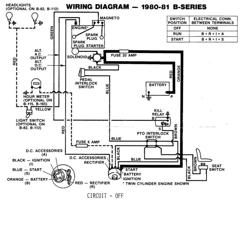

gwest_ca-(File Mod) 12,489 #7 Posted January 21, 2017 This is something Wheel Horse did starting in 1980. The C-Series with battery ignition and B-Series with magneto ignition used the same 103990 battery type of ignition switch. The B-Series have what they named a kill relay added to control the ignition and utilized the very same safety switches and wiring. A brilliant solution. Garry 2 Share this post Link to post Share on other sites
gwest_ca-(File Mod) 12,489 #8 Posted January 21, 2017 Here is a relay we can get here in Canada at Princess Auto that comes with a wired socket. Once it is installed it is plug and play. No more wondering where that loose wire came from. Northern Tool carries many of the same products PA does. Garry 3 Share this post Link to post Share on other sites

gwest_ca-(File Mod) 12,489 #10 Posted January 21, 2017 This thread has been about replacing an engine with battery ignition for one with magneto ignition and the required changes. The following statement is not correct if using the 103991 magneto ignition switch to control battery ignition. The same relay will work for an engine swap the other way - magneto ignition to battery ignition. Wired slightly different with the power supply to the relay fused. Garry 1 Share this post Link to post Share on other sites
