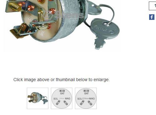

rdeanrj58 68 #1 Posted January 15, 2017 I have a L-157 that i'm getting ready to wire I've found an ignition switch from Stens #430520 that might work but i question if its heavy enough to handle the starter since it doesnt use a solenoid If it is what size wire should I use? The engine is a Tecumseh HH 60 with magneto ignition Thanks Share this post Link to post Share on other sites
pfrederi 21,172 #2 Posted January 15, 2017 (edited) I would say not. I looked up the stens number you have. The terminals do not look heavy enough to me. Also the schematic shows sol (for solenoid) not s for starter. Toro still has 101482 the replacement for 4987 Edited January 15, 2017 by pfrederi 3 Share this post Link to post Share on other sites
rdeanrj58 68 #3 Posted January 15, 2017 Ok. Thanks for the Toro part #. I looked at the wiring diagram and I don't see a solenoid Share this post Link to post Share on other sites
pfrederi 21,172 #4 Posted January 15, 2017 (edited) There wasn't but.. If you are not into originality it would be a lot cheaper to use a solenoid and a simple switch. I converted my L107 to electric start used a solenoid and intermittent push push button for the starter. I used the original toggle switch for killing engine and put the push button in the plugged hole used for the ignition switch on L157's. Edited January 15, 2017 by pfrederi 4 Share this post Link to post Share on other sites
rdeanrj58 68 #5 Posted January 16, 2017 So the 4987 didn't use a solenoid. What size wires would be required to use with that switch if I found one? Thanks for all your help Share this post Link to post Share on other sites
