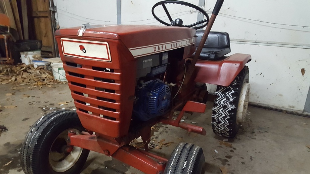

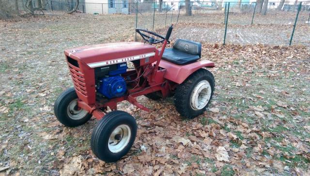

stratostar250 934 #1 Posted January 15, 2017 (edited) So, I've had my '69 Work Horse for about 2 years now. It has honestly probably been the shining star of my herd. Previous owner put a Chinese Honda clone on it. It always starts, drives, is super solid, and even my dad flipped it over a bank (don't worry, he's okay) and all I had to do was replace the lift arm, and I love the patina on it, but it always had one sore spot. The hood, more specifically, the headlight area. The HF motor that was planted into it, the exhaust pointed straight forward, out the front of the hood, and the previous owner melted the original headlight bezel(Which I have), he took it out, and left the hood empty. It took me two years, but I had a brilliant idea. Why don't I just flip the muffler 90 degrees, so I gave it a try. The two manifold bolts came off easy, muffler is obviously supposed to be mounted the other way if you look at the gasket and the connection areas, but it looked like it would fit, so I went ahead, and what do you know, no exhaust leaks, doesn't touch the hood (super close, but doesn't). It does blow the exhaust at your leg now, but if you're driving, you don't even notice it. After this, I went to the pile of extra parts that the previous owner provided with the tractor and pulled out the original headlight delete bezel, It had never been on the tractor before. I cannot believe how much it pulls the look of the tractor together. I LOVE it. Just remember, somethings may take time to shine through, and when they do, it is totally worth the wait. Edited January 15, 2017 by stratostar250 18 Share this post Link to post Share on other sites

stratostar250 934 #10 Posted January 15, 2017 6 hours ago, ohiofarmer said: So which engine is that? The 14 HP Predator muffler cannot be reversed and still mount the hood, so my 520 is hoodless.. I remember that the blue HFT engines were from a different manufacturer.. I wounder if my skills are enough so as to cut the pipe and run the thing as it should be? BTW, the 14 HP HFT engine has plenty of low end grunt even for a 520 platform running at 3/4 throttle. It burns 1/2 the gas as the Onan mowing my yard. Maybe a bit slower, but it was affordable enough to save the tractor. The motor is a 6.5 hp "Greyhound" motor. They were once sold at Harbor Freight, but then they had to stop because they were too similar to some Honda motor. Amazing running little motor, starts second or third pull every time, and that's only because I run the gas out every time, otherwise it'd be first pull. Makes the tractor super light though, wheelies in first gear are common. 1 Share this post Link to post Share on other sites
