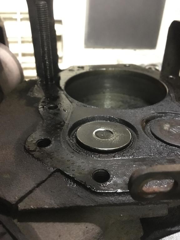

Brandon hill 4 #3 Posted January 15, 2017 One of the valves is sitting all the way down, it looks to be the one that the spark plug hits, could that be my problem? 1 Share this post Link to post Share on other sites
JAinVA 4,638 #4 Posted January 15, 2017 (edited) Yup,That's the exhaust valve and its stuck open.Thats the problem.You will need to remove the valve and clean the stem and valve guide.Nothing hard core if you have a valve spring compressor.The cleaning is relatively simple.Light attention with scotchbright or fine grit sand paper.Make sure to use a new head gasket at reassembly.They are not that expensive. Edited January 15, 2017 by JAinVA 4 Share this post Link to post Share on other sites

N3PUY 1,031 #9 Posted January 15, 2017 7 hours ago, Brandon hill said: it looks to be the one that the spark plug hits, If the valve "hits" the spark plug could be that the valve is bent?!?! It looks like it is in the picture. Wrong spark plug? 4 Share this post Link to post Share on other sites
JAinVA 4,638 #10 Posted January 15, 2017 N3PUY has a good eye and a very good point.Check to see if the exhaust valve is bent when you get it out. 3 Share this post Link to post Share on other sites
