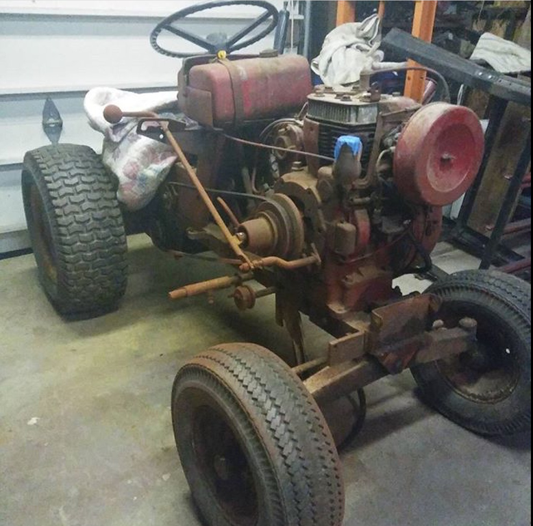

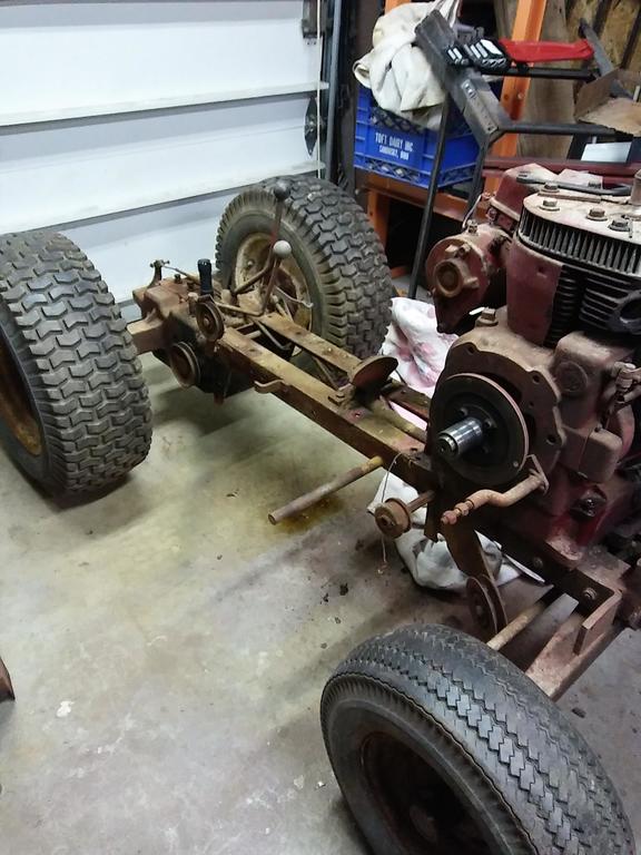

Solze1267 202 #1 Posted January 13, 2017 Hey guys new to the forum. Currently working on a 1267 restoration. Does anyone else have one I could pick their brain on. Sorry I don't have a complete picture of it as I joined after I started the tear down but here is where I'm at so far. The motor does run and all forward and reverse gears work, I have been in touch with my local Axalta paint store and have had a spray can made of the paint I use to check color and it's about perfect. Hopefully will have more updates soon. 5 Share this post Link to post Share on other sites

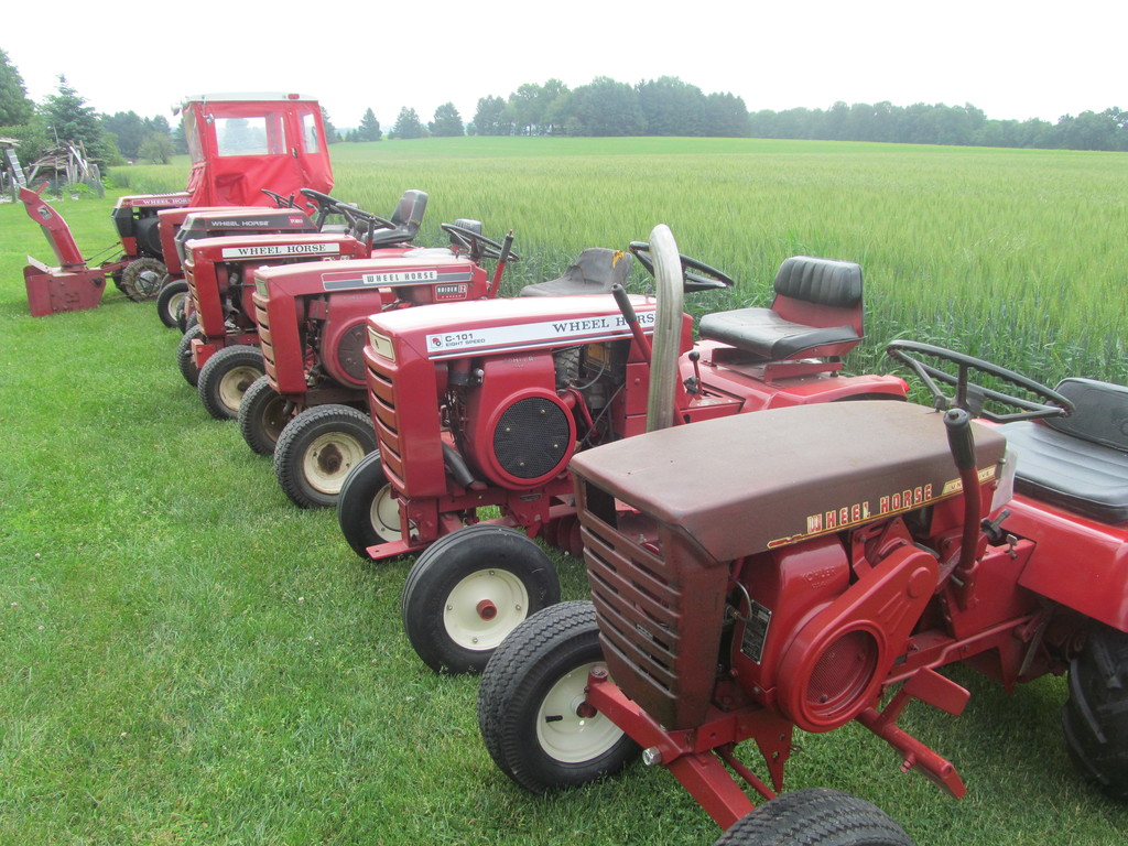

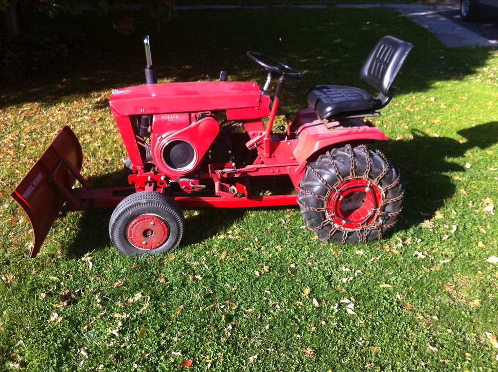

squonk 48,327 #5 Posted January 13, 2017 Did someone say 1267? 7 Share this post Link to post Share on other sites

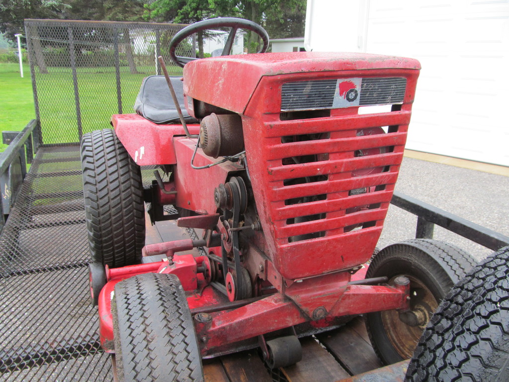

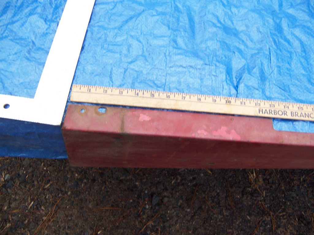

Solze1267 202 #6 Posted January 13, 2017 Squonk, love the tractor and that pic actually answered one of my questions. If at all possible when you get a chance could you make some measurements of your drive belt guard, mine is missing and I'm having a hard time loacating one. Figure since I have all the fab tools to make it I could give it a shot. Share this post Link to post Share on other sites
squonk 48,327 #7 Posted January 13, 2017 (edited) Solze, Here are a couple of threads with pics. Just click on the links. also you could try posting a wanted ad for the guard in the classifieds here on the forum. I'll try to get som measurments this weekend. Edited January 13, 2017 by squonk 1 Share this post Link to post Share on other sites

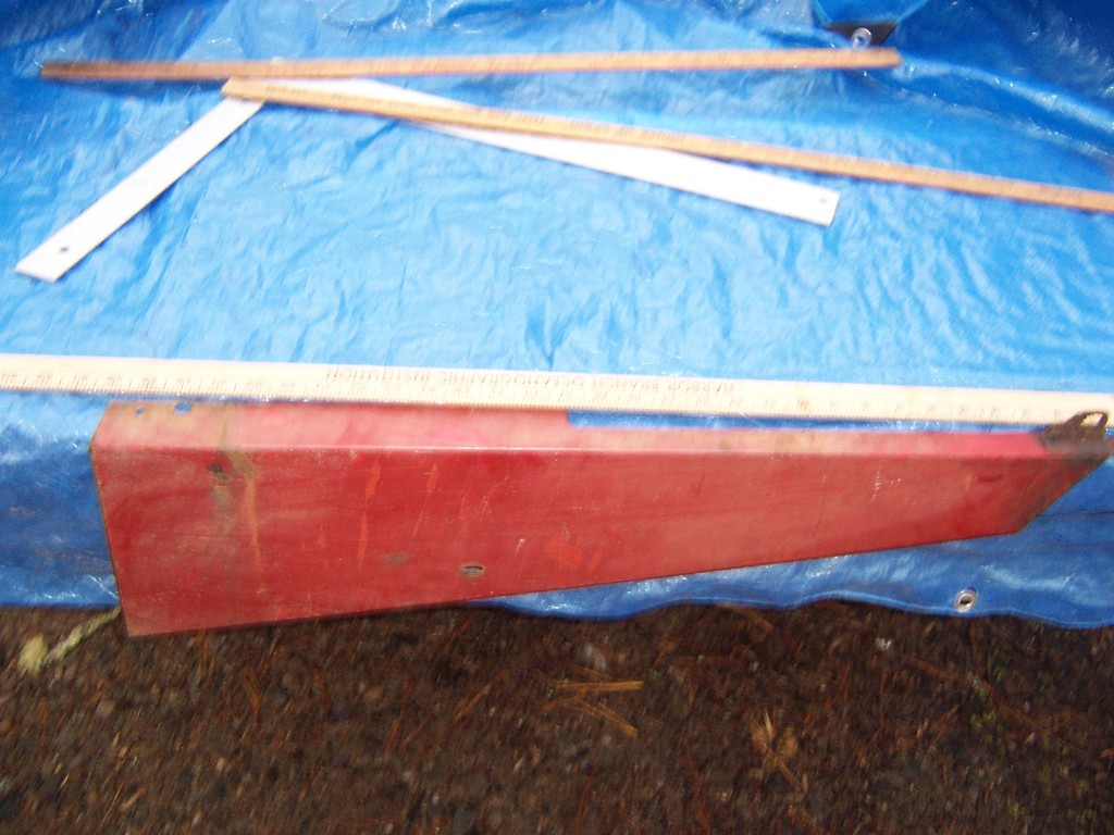

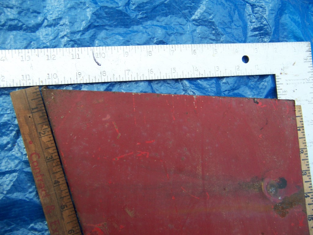

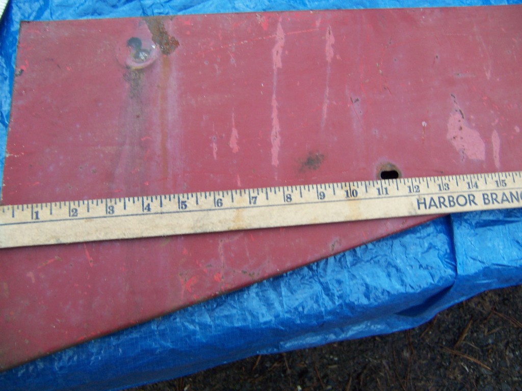

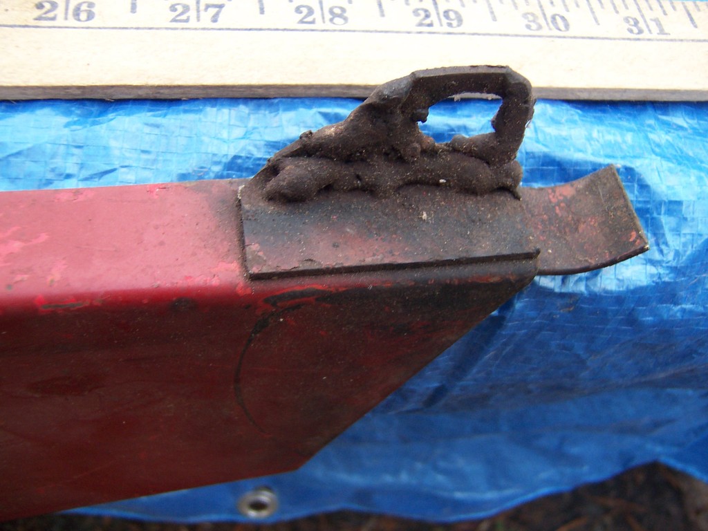

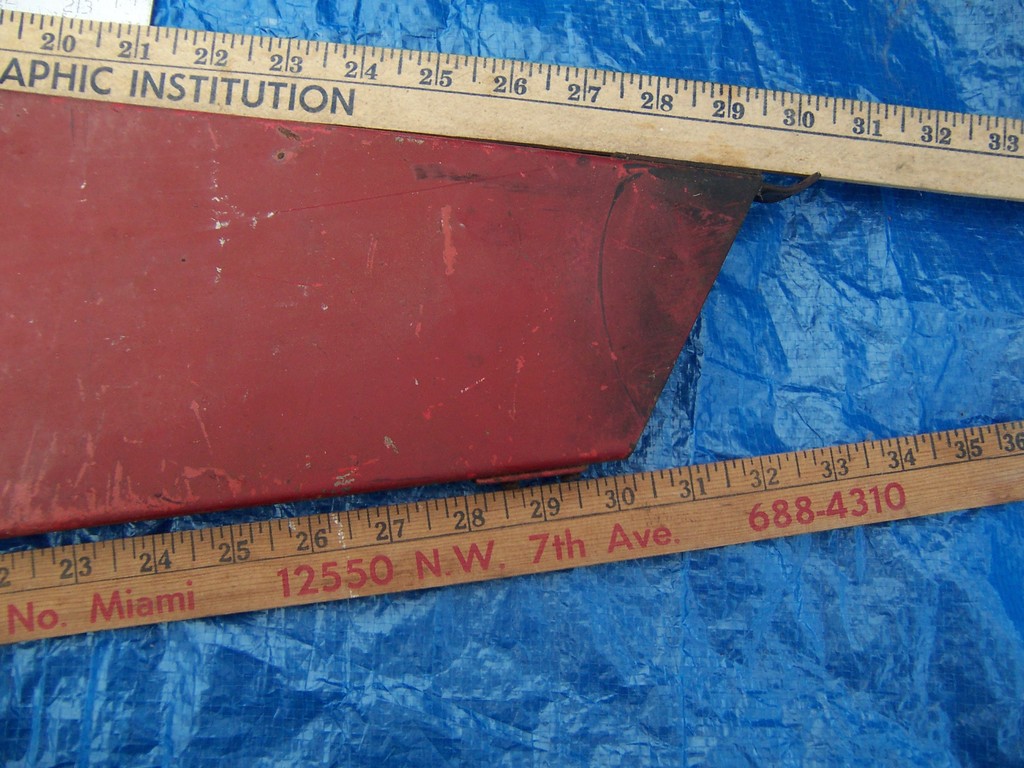

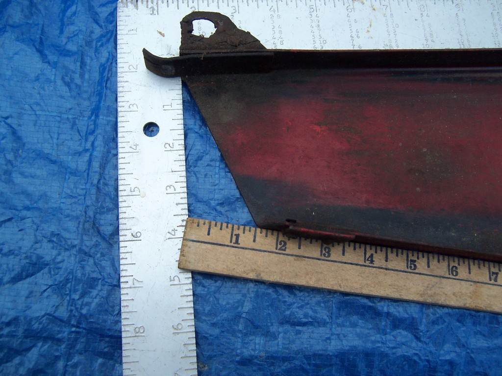

953 nut 70,340 #10 Posted January 13, 2017 to I have a 1267 belt guard hanging around in the barn, I will get the measurements and post them later today. 3 Share this post Link to post Share on other sites

953 nut 70,340 #14 Posted January 13, 2017 I took the pictures, it is a rather involved piece, I'm going to PM you about it. 4 Share this post Link to post Share on other sites

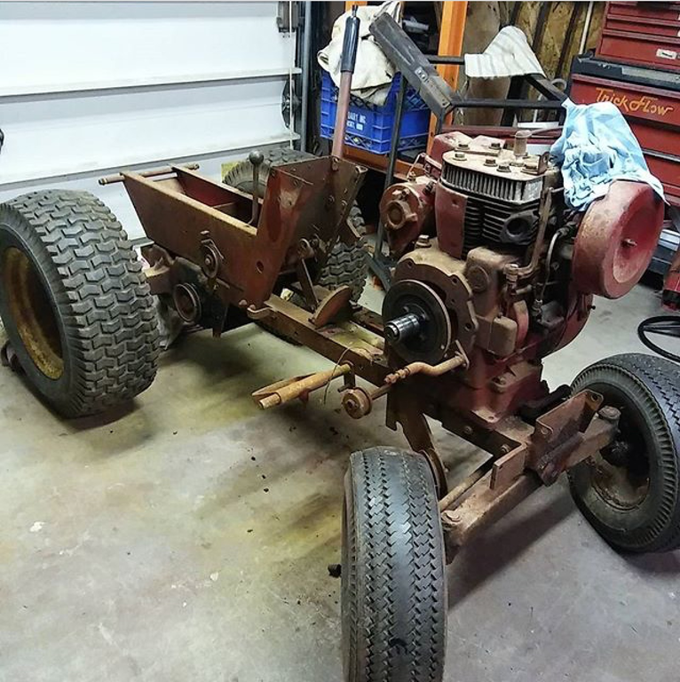

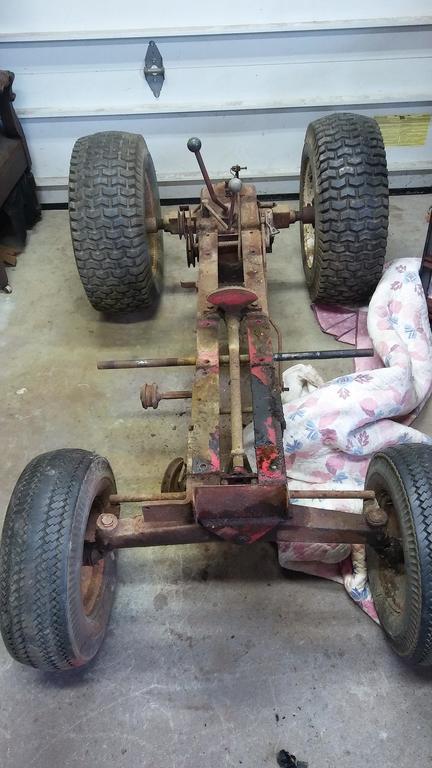

Solze1267 202 #15 Posted January 13, 2017 Update on the project. Tonight we got the rear section and foot pedals off and plan to pull the motor tomorrow afternoon and plan for a not so cold day to blast the frame. 4 Share this post Link to post Share on other sites

Sarge 3,473 #17 Posted January 15, 2017 I've had a 1277 for around 15yrs now , love that series and especially the look they have with the '66-'67 tall , long hoods and 7-slot grill ... The belt guards are a source of irritation - as the frame flexes they love to break those tabs off the guard . If you're having one made make sure to have a much heavier piece of metal , such as 1/8" or a little thicker - it helps. Also , check that rear transmission mounting plate - those two year models are known for cracking them , which leads to cracking the belt guard and trans tunnel/dash tower pieces in succession as they are trying to hold the whole assembly rigid . My 1277 is awaiting a spring welder/fab fest to replace it's rear frame plate as it's been re-welded twice already - now it's shattered and has no reverse...lol . Sarge 3 Share this post Link to post Share on other sites

Solze1267 202 #19 Posted January 17, 2017 UPDATE little late posting but got it down to frame, trans, and steering. Going to degrease and pressure wash the frame to get it ready to blast/sand for primer. Can anyone help me out with what size battery to use? I tried one out of my other mower and it was way to small for the battery tray. 1 Share this post Link to post Share on other sites

Ed Kennell 47,818 #22 Posted January 17, 2017 (edited) I shim with plywood around my batteries to fit the box. BTW, What were those plates on the front end for? Edited January 17, 2017 by Ed Kennell Share this post Link to post Share on other sites
Solze1267 202 #23 Posted January 17, 2017 Ed do you mean on the left side up front as you look at the photo (right side in real life)? Not sure it was on it when we pulled it from the barn Share this post Link to post Share on other sites
Ed Kennell 47,818 #24 Posted January 17, 2017 (edited) Yeah, I was referring to the plate over the axle. I went back to the first pic and see it is an angle bolted to the frame. I know the center one is the hood support hinge. Edited January 17, 2017 by Ed Kennell Share this post Link to post Share on other sites
