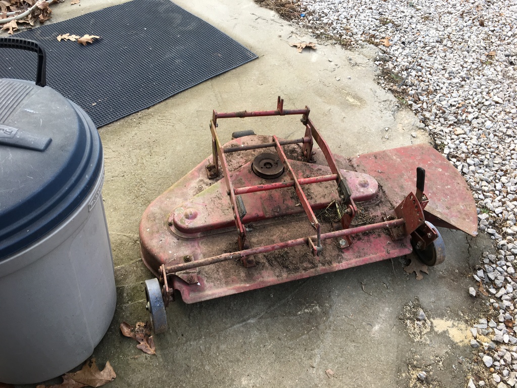

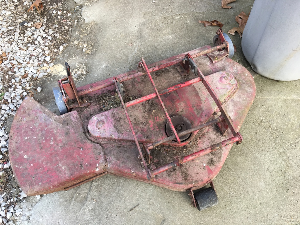

T-Mo-(Moderator) 4,855 #5 Posted January 12, 2017 Thanks guys, for the encouraging words. When I first bought it, I wasn't impressed with it and saw it more as a parts tractor. But after bringing it home and getting to know it better, it's growing on me. If it will start and drive okay, it might get the 42 inch front blade that currently resides on the 702. Other than the discharge chute having a weld, the deck shell appears to be in good shape. I haven't really check to see if the spindles are nice and tight, and spins freely yet. Share this post Link to post Share on other sites

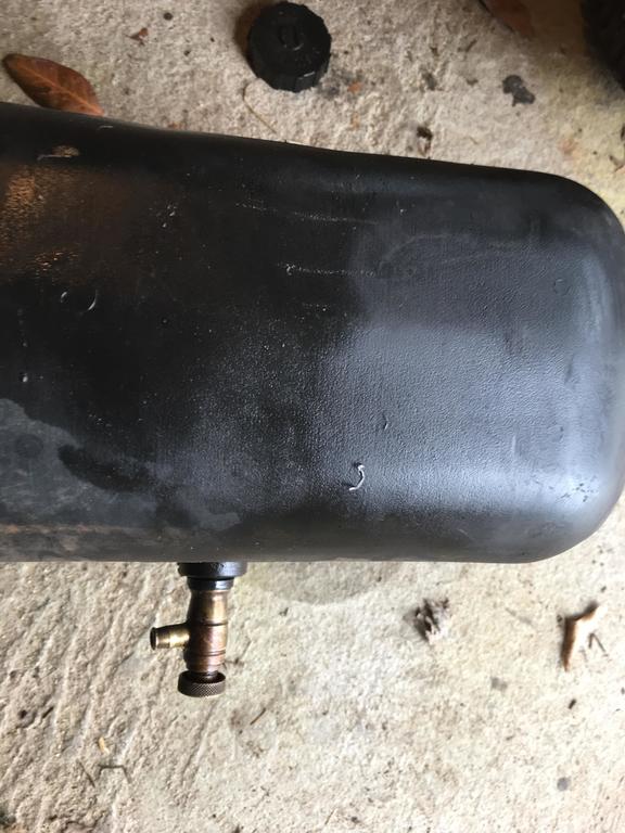

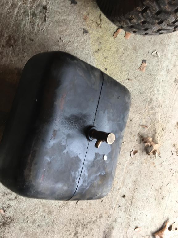

T-Mo-(Moderator) 4,855 #6 Posted January 15, 2017 Spent more time on the B yesterday. Lost spark somehow, so I have to trouble shoot that now. Anyways, I cleaned her up a bit, and pull off the leaky gas tank. I think it's leaking from the bushing where the valve goes through. A couple of questions on that, first here is what my setup looks like. I can't tell from the parts diagram if this is original. So, can someone there me if this is original or an aftermarket shut off valve? Second, I'm assuming the valve is just pressed into the bushing, and if not, how does the valve come out without damaging the plastic tank? The tank itself looks to be in good shape with no cracks, so I don't want to damage it when the valve and bushing is removed and replaced. Now I need to do some research on what I should be seeing at the coil and points to trouble shoot the no spark issue. Wednesday I had spark, so maybe an intermittent problem. 1 Share this post Link to post Share on other sites
Elkskin's mower junkyard 1,117 #7 Posted January 15, 2017 8 hours ago, T-Mo said: Spent more time on the B yesterday. Lost spark somehow, so I have to trouble shoot that now. Anyways, I cleaned her up a bit, and pull off the leaky gas tank. I think it's leaking from the bushing where the valve goes through. A couple of questions on that, first here is what my setup looks like. I can't tell from the parts diagram if this is original. So, can someone there me if this is original or an aftermarket shut off valve? Second, I'm assuming the valve is just pressed into the bushing, and if not, how does the valve come out without damaging the plastic tank? The tank itself looks to be in good shape with no cracks, so I don't want to damage it when the valve and bushing is removed and replaced. Now I need to do some research on what I should be seeing at the coil and points to trouble shoot the no spark issue. Wednesday I had spark, so maybe an intermittent problem. http://www.ebay.com/itm/Fuel-gas-tank-Grommet-and-Shut-off-valve-Generators-Craftsman-Coleman-Generac-/131563480318?hash=item1ea1cb64fe:g:IEgAAOSwgQ9VsmBB this here is what you need. they are universal. i bought one from local repair shop for workhorse 700 and my gt1642. 1 Share this post Link to post Share on other sites

Lane Ranger 11,980 #10 Posted January 15, 2017 (edited) T-Mo : Those gas tank valves with the gommet can be very tricky -especially that old and not knowing where that tractors sat at for a long time. I recommend heating that up with a hair dryer or heat gun ( I prefer hair dryer with three temp ses as you want to slowy warm that ynderneath the valve grommet before trying to remove. The plastic sometimes cracks or small pieces can bust off when they are brittle. I have redone two of these with new valves and grommets and this has worked well for me> Edited January 15, 2017 by Lane Ranger 3 Share this post Link to post Share on other sites
T-Mo-(Moderator) 4,855 #11 Posted January 16, 2017 Thanks, guys. I know coils aren't cheap, so I want to keep troubleshooting to eliminate other possibilities. And on the gas tank, thanks, Lane, I figured it would be easy to crack the plastic by just forcing the valve and bushing out. 1 Share this post Link to post Share on other sites
