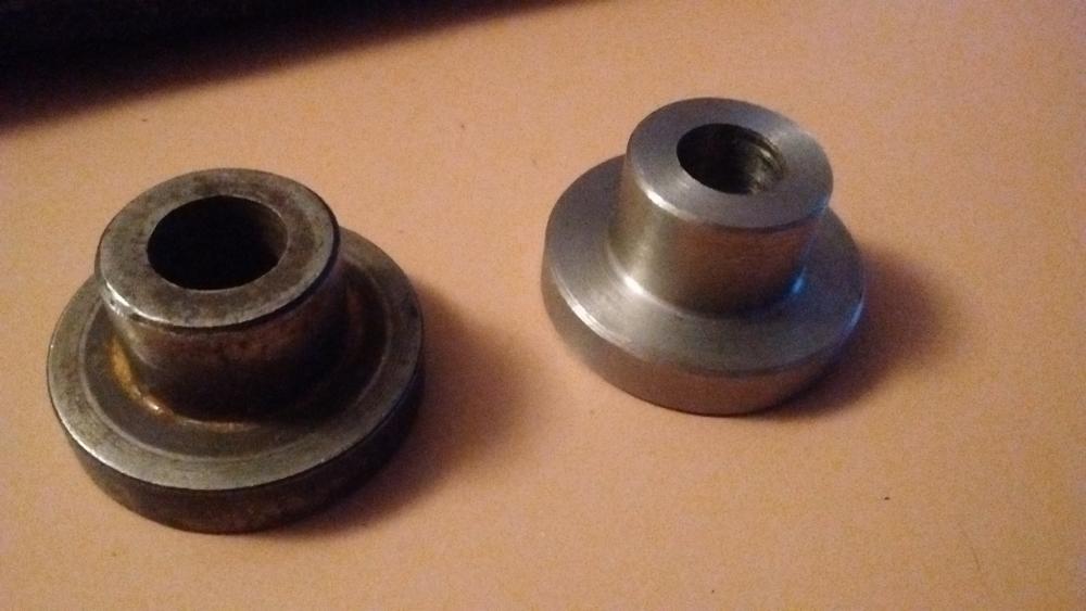

bunson70 51 #8 Posted January 13, 2017 I found that there is a Toro dealer in town. They were not able to get the spacer. My next stop, was one of the machine shops. He said he could make one. It will be ready on Monday. I'm pretty happy with that. 1 Share this post Link to post Share on other sites
bunson70 51 #9 Posted January 16, 2017 I picked up my new bushing at the machine shop today. It was only fifteen dollars! It looks too nice to use. I'm back in business! 2 1 Share this post Link to post Share on other sites
gwest_ca-(File Mod) 12,458 #10 Posted January 16, 2017 Looks good. A new Nylok nut on the bolt should keep it there. Garry 1 Share this post Link to post Share on other sites

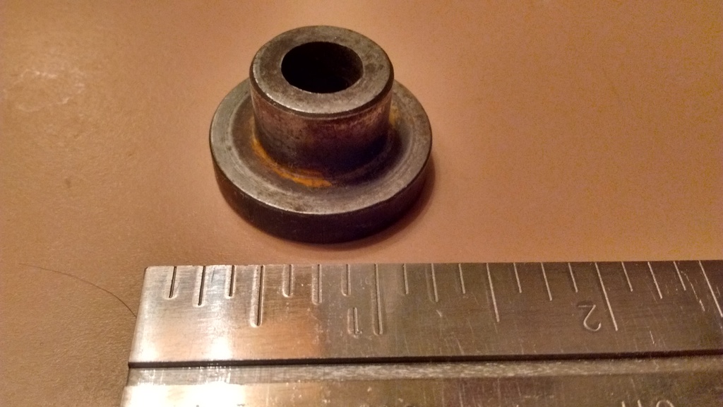

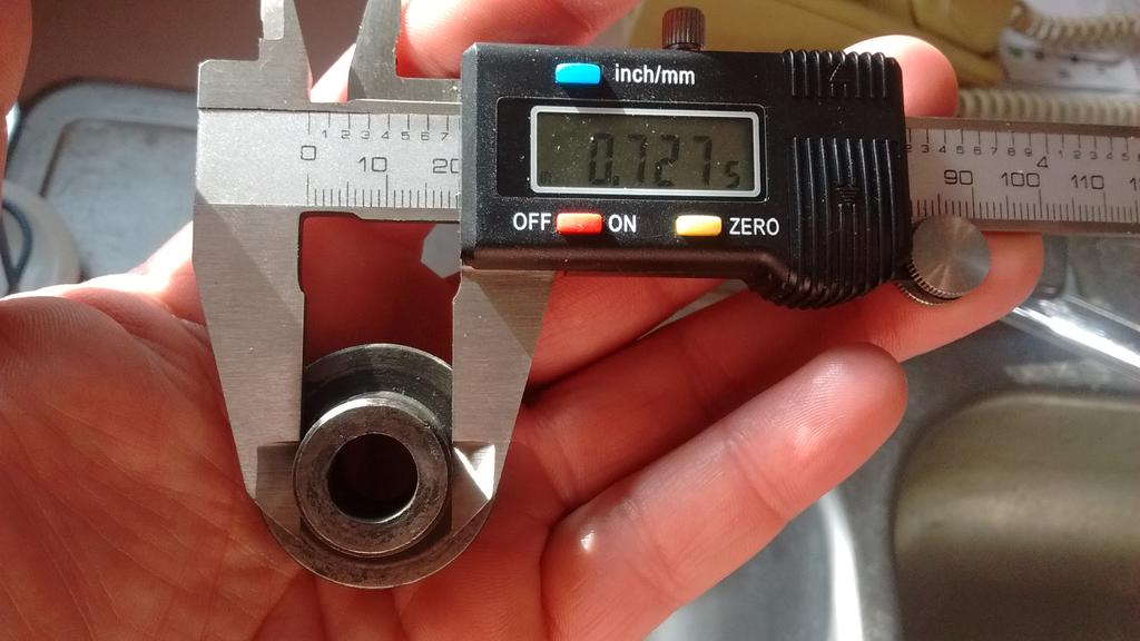

Patrick Reese 40 #12 Posted January 8, 2018 Hi Bunson. I need to get two of these made (I don't have one to copy). Can you give me some more measurements. For instance overall width. Depth to flange.. So to make it easy, with the bushing laying on the table as you have it pictured. How high is it overall? and how high from the table is the flange. Those two measurements would do it.. Thanks! 1 Share this post Link to post Share on other sites
bunson70 51 #13 Posted January 20, 2018 Hi Patrick, once I get home, I'll get the measurements. Share this post Link to post Share on other sites
Patrick Reese 40 #14 Posted January 20, 2018 Hi, I'll be curious to see what you measurements are.. I sort of "Winged" it and went with what I had and the picture to quesstimate sizes.. had three bushings made up at a local Machine Shop. He was nice enough to make them up out of SS steel!.. no rust.. 10 a piece.. Ours seem to work fine! They might be just a tiny bit long, but not enough to cause any problems. 1 Share this post Link to post Share on other sites
bunson70 51 #15 Posted January 24, 2018 Hi Patrick, here is what I have for measurements. This is the original spacer. It hope it helps. Share this post Link to post Share on other sites
