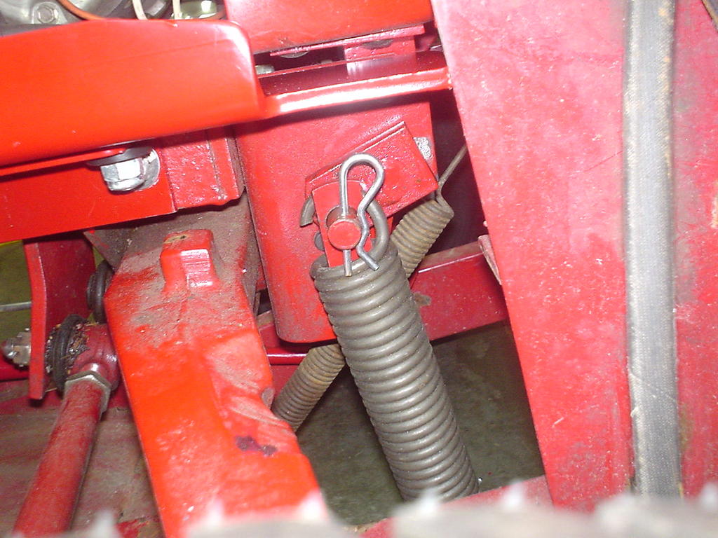

can whlvr 994 #2 Posted January 9, 2017 (edited) very normal with my blowers,if you have the spring to tight it will pull on the blower when lowered,but once its on the ground it should stay on the surface ,one of our members put larger wheels on his thrower,this would work well when on grass,just lift the blower a little with the adjuster on the wheels and blow on,but look at your spring(if you have one first,could need a little adjustment Edited January 9, 2017 by can whlvr Share this post Link to post Share on other sites

cleat 9,230 #12 Posted December 5, 2017 A 2 stage will lift very crooked without the big spring hooked up on the right side. With the spring hooked up, the 2 stage should lift properly. Cleat 1 Share this post Link to post Share on other sites
c-series don 12,363 #13 Posted December 6, 2017 Hmm Cleat, I have to go look but I'm pretty sure its on the right but maybe not? Share this post Link to post Share on other sites

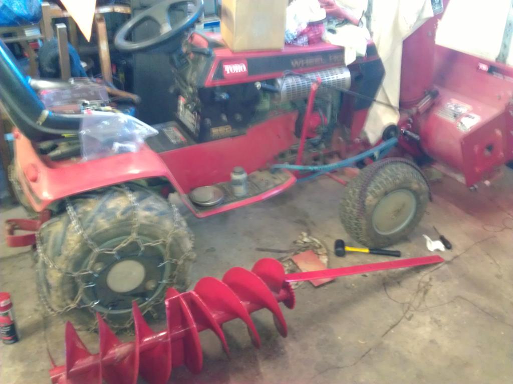

BigRed84 65 #14 Posted December 16, 2017 HELP! Trying to get a jumped chain out of the auger/housing and it's pinched good. So I assumed it would be best to just pull the entire auger....I took the three nuts off the plate at each end, but the plates don't come lose. What am I missing, do I need a special tool to finish this? On a side note, anyone know where I can get a chain quick? Share this post Link to post Share on other sites
lynnmor 9,013 #15 Posted December 16, 2017 You might be able to get a chain at TSC (Tractor Supply). Share this post Link to post Share on other sites
WVHillbilly520H 10,379 #16 Posted December 16, 2017 3 hours ago, BigRed84 said: HELP! Trying to get a jumped chain out of the auger/housing and it's pinched good. So I assumed it would be best to just pull the entire auger....I took the three nuts off the plate at each end, but the plates don't come lose. What am I missing, do I need a special tool to finish this? On a side note, anyone know where I can get a chain quick? Those stub shafts are usually rust welded in the auger, after unbolting soak with a penatrant, then pry bars, hammers, choice words, prayers ect it/they will come loose, if you get the chain from TSC you will need a chain breaker tool and some full and half links to get it the correct length, Jeff. Share this post Link to post Share on other sites
BigRed84 65 #17 Posted December 16, 2017 I figured it might be a pry bar and choice word type of job. Hahaha Thanks for the replies! Share this post Link to post Share on other sites
